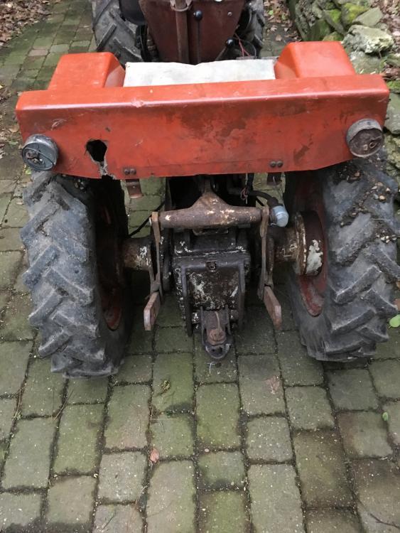

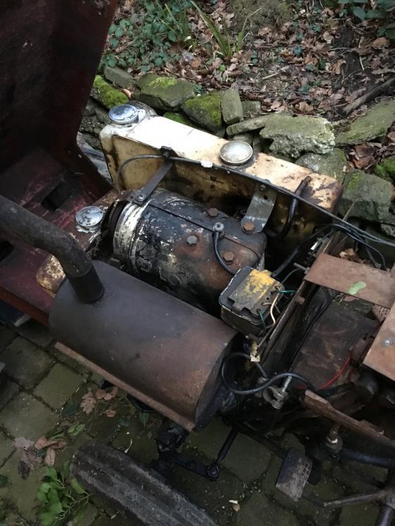

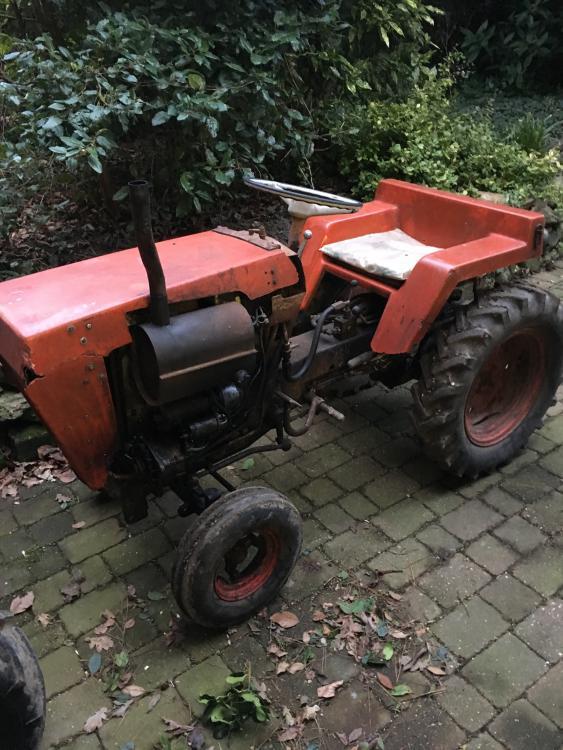

harryt 281 #1 Posted February 26, 2017 So I picked this up at Malvern yesterday. I bought it as I have never seen another one, it is German and powered by a JLO Diesel engine which is 2 stroke. This is an interesting set up and looks to be original apart from the alternator. From what I understand it is a vineyard tractor and this would explain the very tight turning circle. Has hydraulics and also an extra valve at the back which I have never seen on another tractor to perhaps power something like a log splitter? I have not been able to get it started yet, but looks promising as there is some smoke coming out of the exhaust, I think I need to investigate the glow plug. Any information would be appreciated on the tractor or the engine as I can find very limited information and mainly in German. Harry 3 Triumph66, Stormin and 4x4forks reacted to this Share this post Link to post Share on other sites
Stormin 4,458 #2 Posted February 26, 2017 From the photo's I assume it's water cooled. And the two tops on what looks like the fuel tank. One diesel? One hydraulic oil? 1 harryt reacted to this Share this post Link to post Share on other sites

harryt 281 #4 Posted February 26, 2017 7 minutes ago, mowerdar said: The extra valve is probably for a tipping trailer looks similar to the one on my brother in laws super dextar Yes you probably right, it would be nice to find one for it 13 minutes ago, Stormin said: From the photo's I assume it's water cooled. And the two tops on what looks like the fuel tank. One diesel? One hydraulic oil? There are three tanks, one for hydraulic oil, one for diesel and one for the two stroke oil I think. Does anyone know what oil to use for the two stroke? Share this post Link to post Share on other sites
Stormin 4,458 #5 Posted February 26, 2017 I could answer that if it was petrol. But a diesel 2 stroke may use a different oil. Have you Googled JLO diesel engine? 1 harryt reacted to this Share this post Link to post Share on other sites

C-101plowerpower 548 #11 Posted February 26, 2017 HAKO! i'd love me one of those one day but them cost quite a lot over here i dont think it needs any aditional two stroke oil since its a diesel, and being JLO id guess its aircooled. as for starting it try wetting a rag with petrol and holding it over the airfilter, should start on that the third tank might be engine oil, could be dry sump 1 harryt reacted to this Share this post Link to post Share on other sites
harryt 281 #12 Posted February 27, 2017 Thanks Koen, I will try that at the weekend. It is definitely air cooled but just not sure about the 2 stroke part of the engine. I will try and find a manual on the engine itself as cannot find much on the tractor itself. Share this post Link to post Share on other sites
C-101plowerpower 548 #13 Posted February 27, 2017 had a look and seems that the cap closets to the seat is diesel, the one in front engine oil/two stroke oil and the small one on the front is hydraulics 1 harryt reacted to this Share this post Link to post Share on other sites
expeatfarmer 591 #14 Posted February 27, 2017 The two stroke Diesel refers to the induction process, the oil is a dry sump system not connected to the fuel. Diesel acts as a lubricant on it's own as per Sachs and Drayton/Stihl two stroke diesels. If it is a 600cc, it should have a power equivalent to a 1200cc 4 stroke as the engine will fire once every revolution instead of every second. 1 harryt reacted to this Share this post Link to post Share on other sites
harryt 281 #15 Posted February 27, 2017 7 minutes ago, C-101plowerpower said: had a look and seems that the cap closets to the seat is diesel, the one in front engine oil/two stroke oil and the small one on the front is hydraulics Yes that is correct, so for the one in front i can just use a standard engine oil? 5 minutes ago, expeatfarmer said: The two stroke Diesel refers to the induction process, the oil is a dry sump system not connected to the fuel. Diesel acts as a lubricant on it's own as per Sachs and Drayton/Stihl two stroke diesels. If it is a 600cc, it should have a power equivalent to a 1200cc 4 stroke as the engine will fire once every revolution instead of every second. Thanks or that, should be a powerful beast when it fires up then, looking at the tractor as a whole, the engine looks oversized for it. Share this post Link to post Share on other sites
