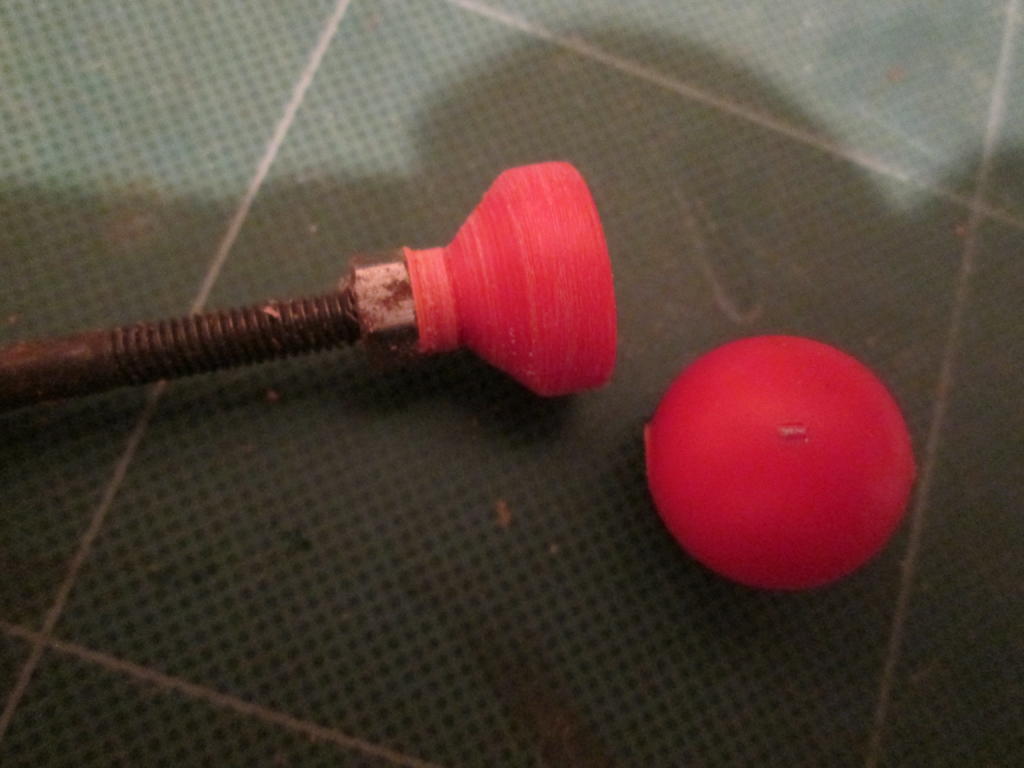

Alan 1,274 #76 Posted January 28, 2018 Two little bits this time. The carburetor attachment tube was cut down to about 1/2 length. Left long, the throttle cable was rubbing on the outside of the hood and didn't look good anyway. Cut down, the cable and it's outer spring fitted neatly inside the hood. I expected difficulty cutting the tube down due to the limited room for the hacksaw, but it was a quick and easy job. The tube was softer than thought and a junior hacksaw soon went through it taking care not to mark the paint on the surrounding body panels. The cable is just tucked in out of the way at this stage. The brake pedal, non working, was made up from alloy, steel washers and plastic. The lettering is 1 mm approx round plastic rod with the curves of the B and R from solder wire. The solder wire was super glued in place with the remainder of the lettering and other parts fused together with liquid plastic cement. The washers, either side of the pivot point, were drilled and tapped then held together with 8BA c/sunk bolts passing through the assembly. The center of the washers, and the plastic/alloy in between, were tapped 5/16 UNF for a mounting bolt which was fixed in place with lock tight. This item was just eyeballed up from various photo's so just a near enough copy. The last photo shows it loosely fixed in place and still waiting final filling and painting. 6 the showman, Anglo Traction, pmackellow and 3 others reacted to this Share this post Link to post Share on other sites

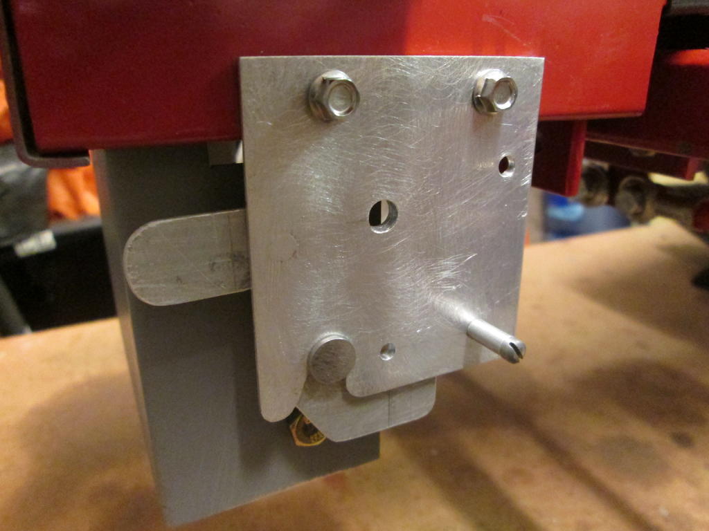

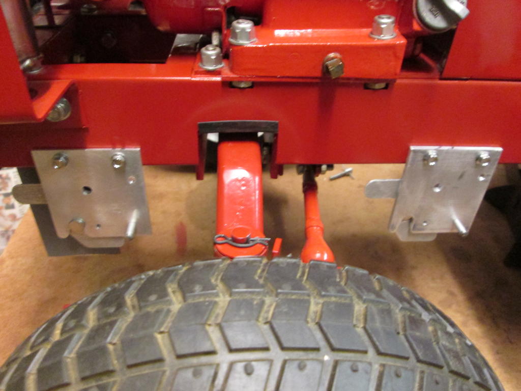

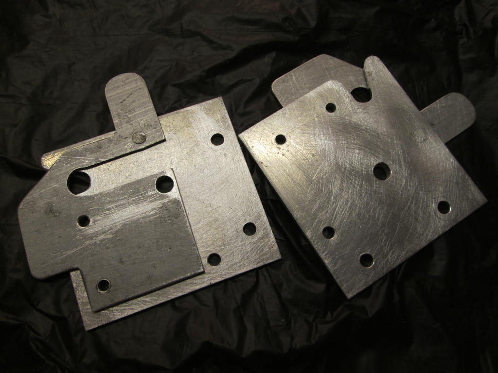

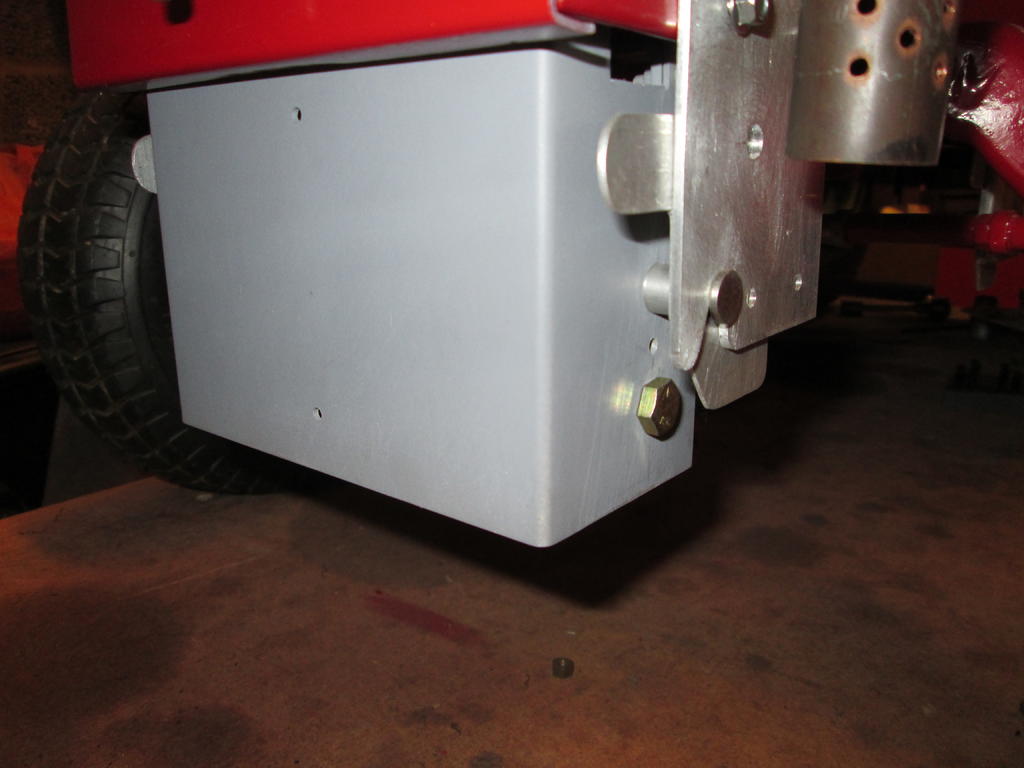

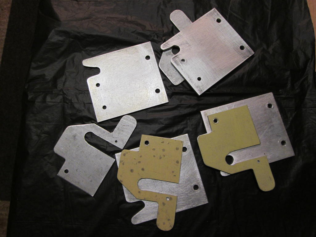

Alan 1,274 #85 Posted February 19, 2018 A few more small parts. The 4 Tach-a-Matic brackets were cut from alloy sheet. At the time I had idea's of making them working units but wasn't sure of the shape of the pivoting section. A slot was cut, to be shortened later, but in the end it was decided to make them NON working. A simple drilled hole would have done instead. Both sections were rivited together at the front. A 4BA bolt and alloy tube formed the operating lever ? for want of a better description, and secured the rear. I have since seen photos of these units in pieces, but still unsure how the lever ? works. Photo's I have looked at also appear to show other holes in various places, so again a bit of guess work was used. The mule drive, again NON working, was bent up from alloy and bolted to the underside of the chassis. The pins which would have attached it to the brackets were bolts with the heads cut down and alloy spacer tubes. Knobs for the front of the removable grill were machined from small plastic balls. Drilled and tapped 4BA first with a bolt used to hold in the lathe chuck. Still need smoothing off. All these items still need painting. Too cold in my garage for spraying. I can put up with the cold but the paint objects and refuses to play nicely. 3 Anglo Traction, Stormin and Cub Cadet reacted to this Share this post Link to post Share on other sites
