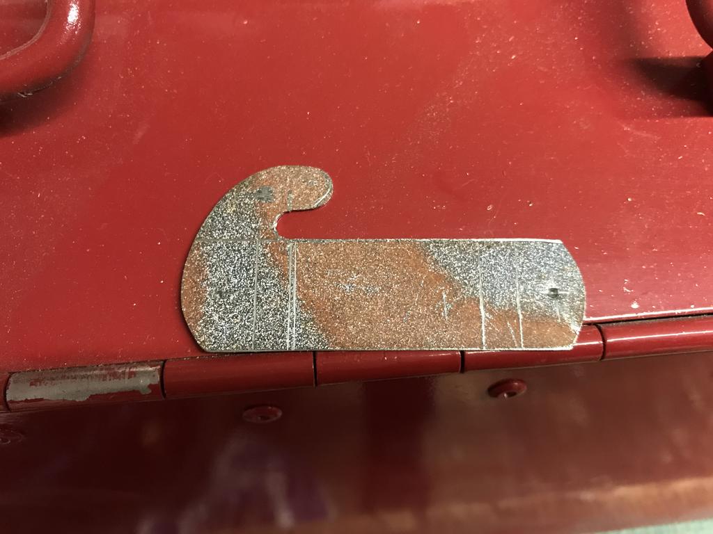

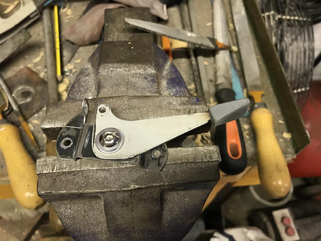

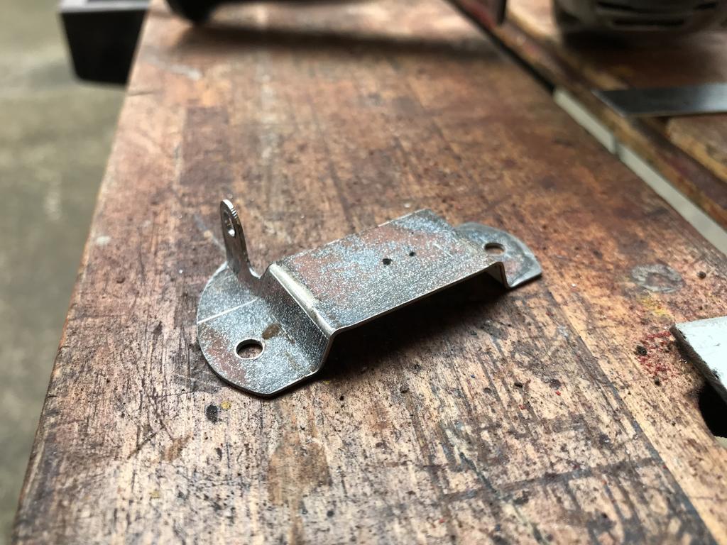

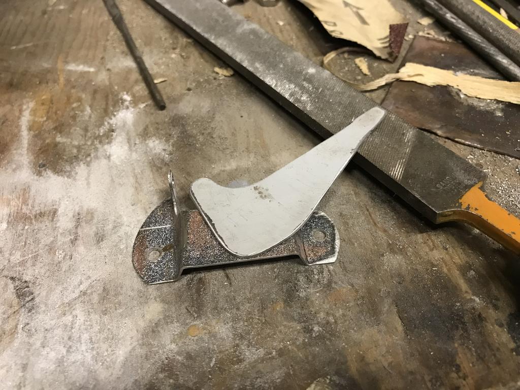

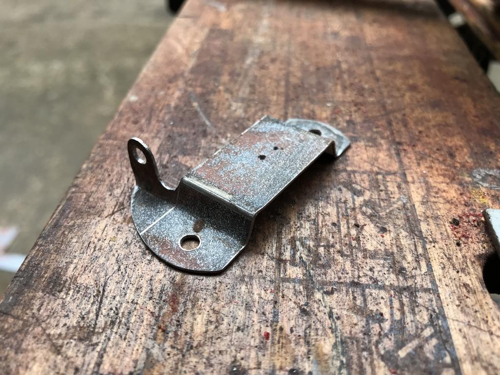

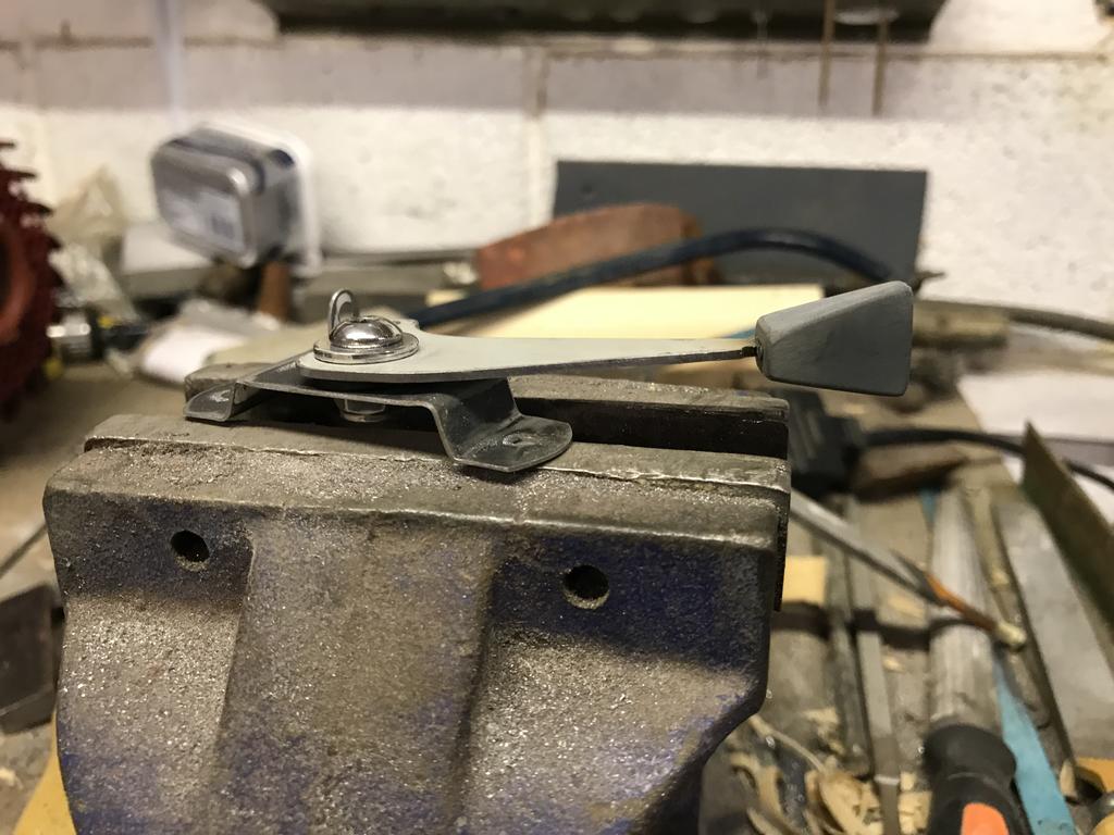

Cub Cadet 613 #87 Posted March 5, 2018 Little bit more done recently, the throttle was missing so looking at a few photos I mocked one up in card that looked about right and then cut it out in a piece of scrap, it will do for now if it works. 5 Alan, the showman, Anglo Traction and 2 others reacted to this Share this post Link to post Share on other sites

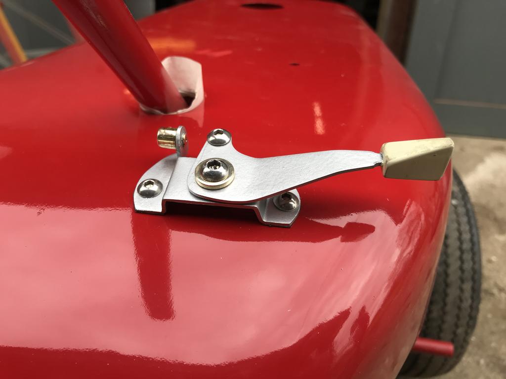

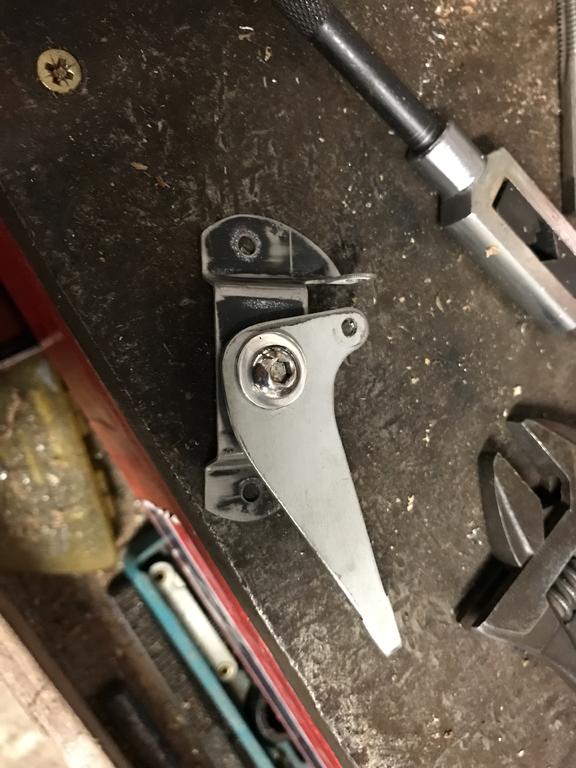

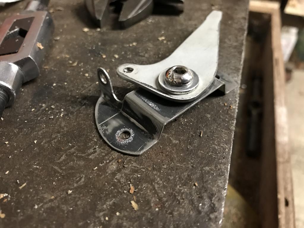

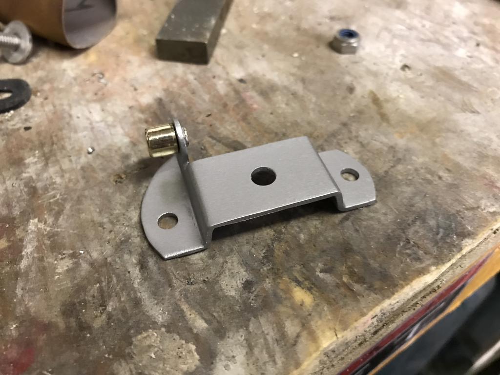

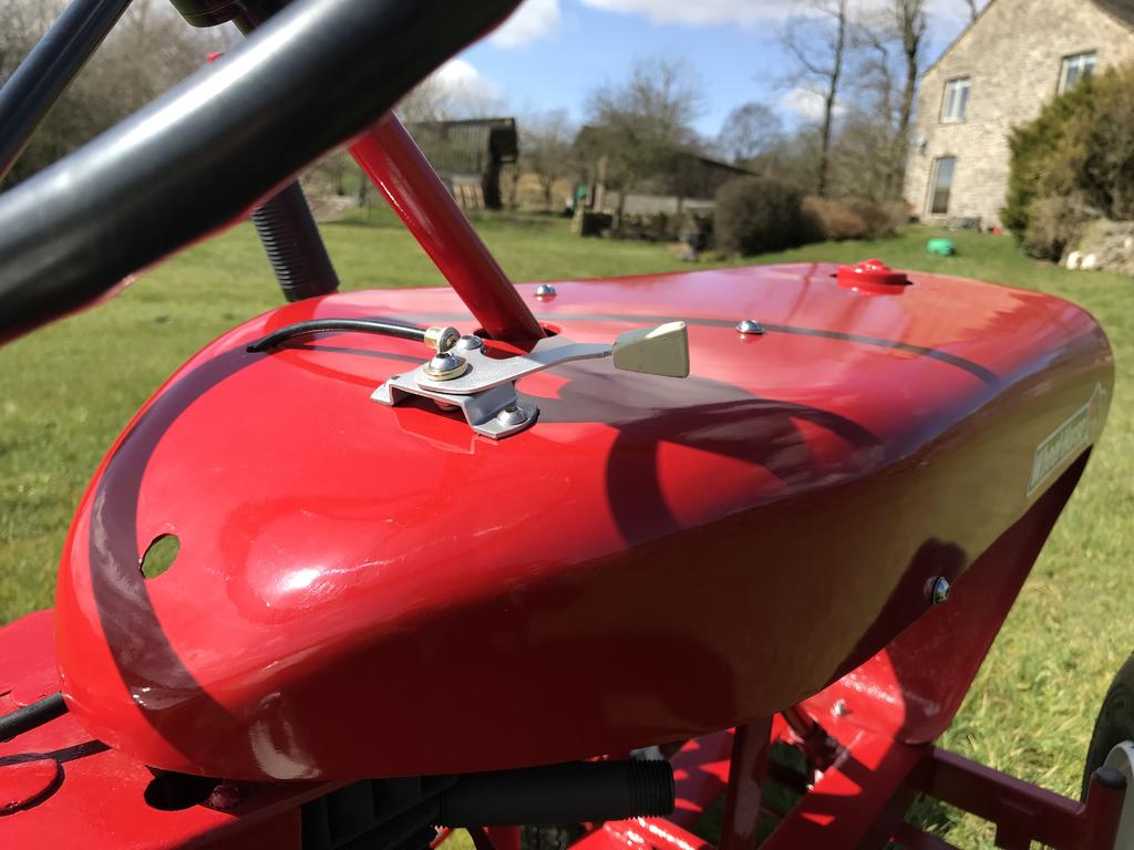

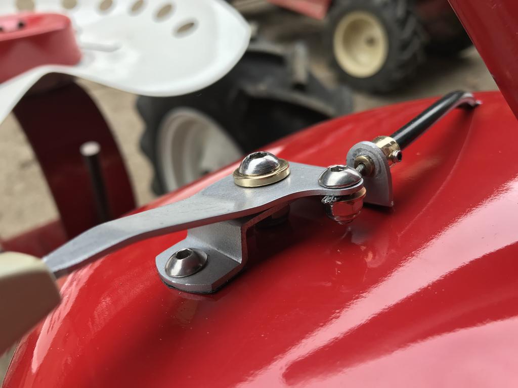

Cub Cadet 613 #88 Posted April 2, 2018 A little more progress now I’m home for Easter break. I remade the throttle out of some thicker steel and gave it all a coat of paint. We are using bike brake cables for the linkage. Not an exact match to the original but I’m pleased since I made it up from some photos. 4 meadowfield, Stormin, Alan and 1 other reacted to this Share this post Link to post Share on other sites
Alan 1,274 #89 Posted April 2, 2018 Looks good Ewan. Stands out against the red paint. 1 Cub Cadet reacted to this Share this post Link to post Share on other sites
Stormin 4,458 #90 Posted April 3, 2018 Top job, Ewan. 1 Cub Cadet reacted to this Share this post Link to post Share on other sites
Cub Cadet 613 #91 Posted April 3, 2018 21 hours ago, Alan said: Looks good Ewan. Stands out against the red paint. 11 hours ago, Stormin said: Top job, Ewan. Thanks! it sure does Alan Share this post Link to post Share on other sites
Anglo Traction 1,017 #92 Posted April 4, 2018 As already mentioned, great work Ewan . your decision to remake it in thicker steel was the wise one. It look's perfect for purpose and good to see you chose to place a gasket between it and the paintwork........quality ! . .......and the good, clear images in your posts also make all the difference. 1 Cub Cadet reacted to this Share this post Link to post Share on other sites
Cub Cadet 613 #93 Posted April 4, 2018 55 minutes ago, Anglo Traction said: As already mentioned, great work Ewan . your decision to remake it in thicker steel was the wise one. It look's perfect for purpose and good to see you chose to place a gasket between it and the paintwork........quality ! . Thanks Richard, the original one was only ever going to be a template but once i'd made it I couldn't be bothered to remake it out of thicker steel. One of the holes was too small so it forced me to remake it but i'm glad I did I always try to save the paint if I can however it will inevitably get chipped at some point Share this post Link to post Share on other sites

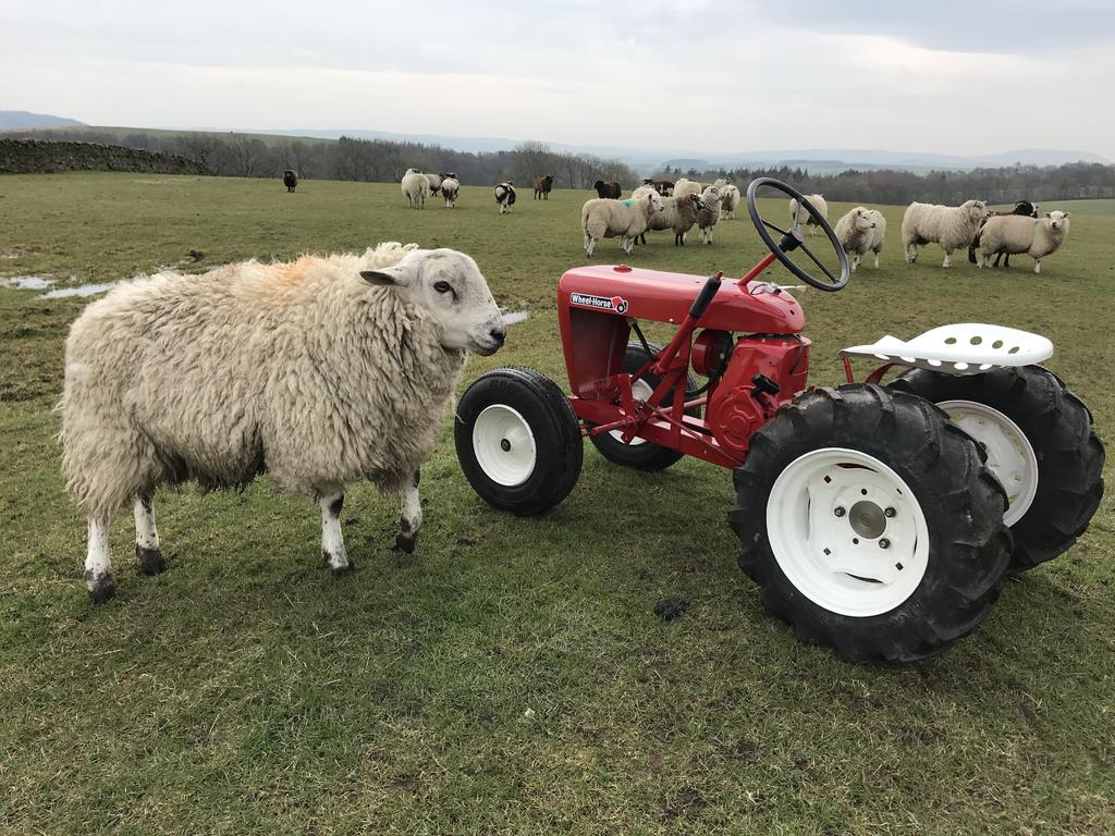

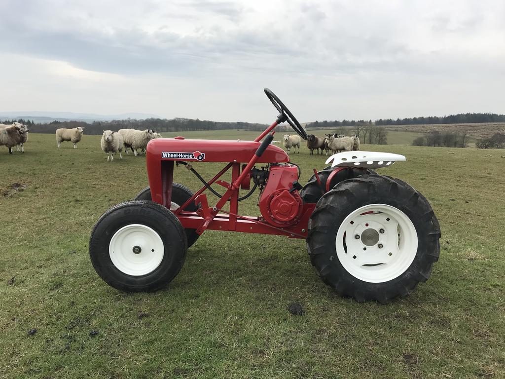

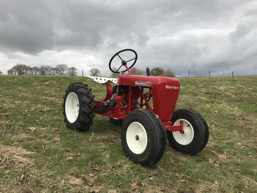

Cub Cadet 613 #98 Posted April 8, 2018 So apart from a few parts still to make and bits still to finish painting the RJ looks about finished. We've had the RJ running for about an hour solid today and we haven't had any issues which is good. Here are some photos. 3 the showman, Anglo Traction and Stormin reacted to this Share this post Link to post Share on other sites
Anglo Traction 1,017 #99 Posted April 8, 2018 Looking good Ewan !. perhaps a piece of a fleece will go well on that cold iron seat . 1 Cub Cadet reacted to this Share this post Link to post Share on other sites
Alan 1,274 #100 Posted April 8, 2018 Another top job Ewan The sheep looks well impressed. 1 Cub Cadet reacted to this Share this post Link to post Share on other sites
