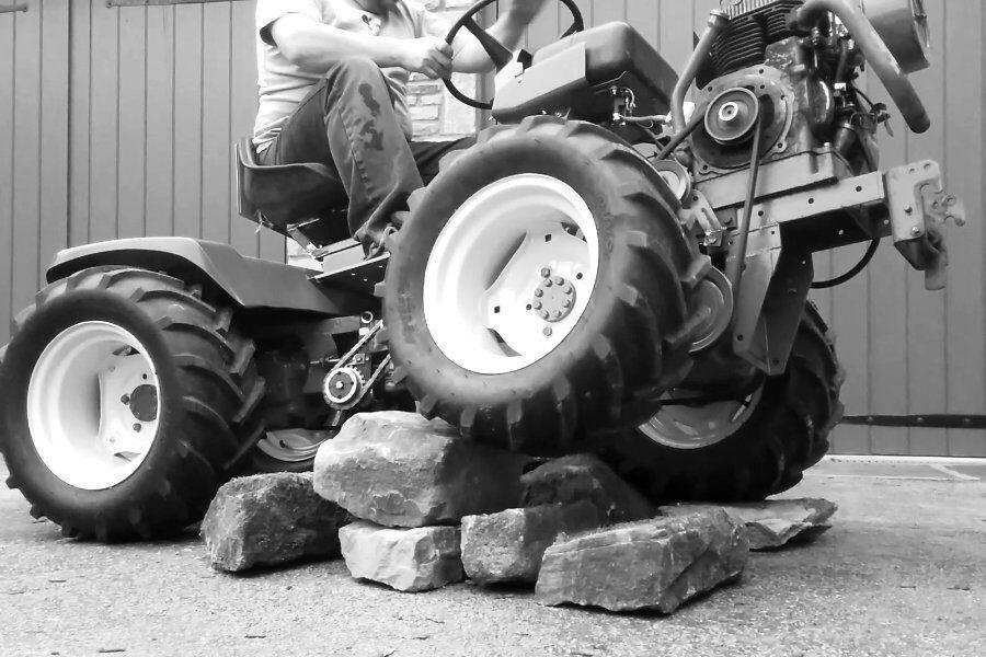

meadowfield 1,901 #184 Posted October 25, 2014 been a busy day we've been staging scenes from back to the future and extreme trials Share this post Link to post Share on other sites
meadowfield 1,901 #186 Posted October 25, 2014 And the video.... 5 jak3_smith, the showman, nigel and 2 others reacted to this Share this post Link to post Share on other sites

Ian 2,417 #192 Posted October 29, 2014 A bit late catching up with this, great video Mark... Bendy looks to have plenty of traction and a rather strong drive train to get all four wheels spinning Share this post Link to post Share on other sites
