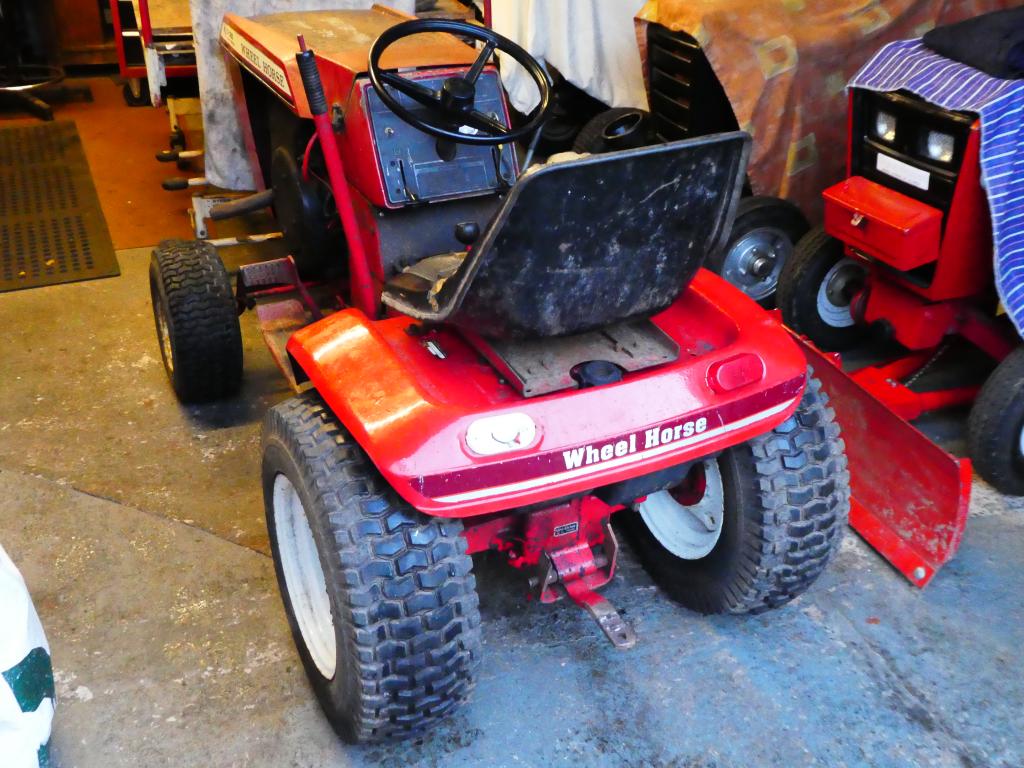

Stormin 4,458 #1 Posted December 30, 2019 A mate of mine and myself picked up this C-125 a month or so ago. Unused for around two years and stored in a shed. A none runner and in need of some TLC. Yesterday it arrived at my workshop to sort out. Started on it this morning and I'll up date as progress is made. Mainly a case of fixing any issues and a general tidy up. It's to be a worker on the property he and his Good Lady have acquired, over the border in Scotland. 2 Alan and Triumph66 reacted to this Share this post Link to post Share on other sites
Stormin 4,458 #2 Posted December 30, 2019 It now runs after a points clean up and setting. And sweetly after a warm up and carb adjustment. Carb seems to be a plastic one. Works OK though. May need a new HT lead. Doesn't look to good. Drove it in and out of the workshop ok after blowing the tyres up. Doing that let me know the rears are water ballasted. Wee'd on the floor. I also think the brake needs attention. Stops dead when you depress the clutch. You can push it about easily though. Another steering wheel is on the cards. It has a 'eck of a wobble. The steel insert in it is very loose. The shaft is fine. Engine oil will be changed and trans drained, flush and refilled. Some nice cream in there. Gear lever boot is practically none existent. Axle seals etc. etc. etc. First thing though, is to sort out the charging system. Cos it isn't. Electrics not my forte and my tame electrician is currently sunning himself in Spain. 2 Triumph66 and nigel reacted to this Share this post Link to post Share on other sites

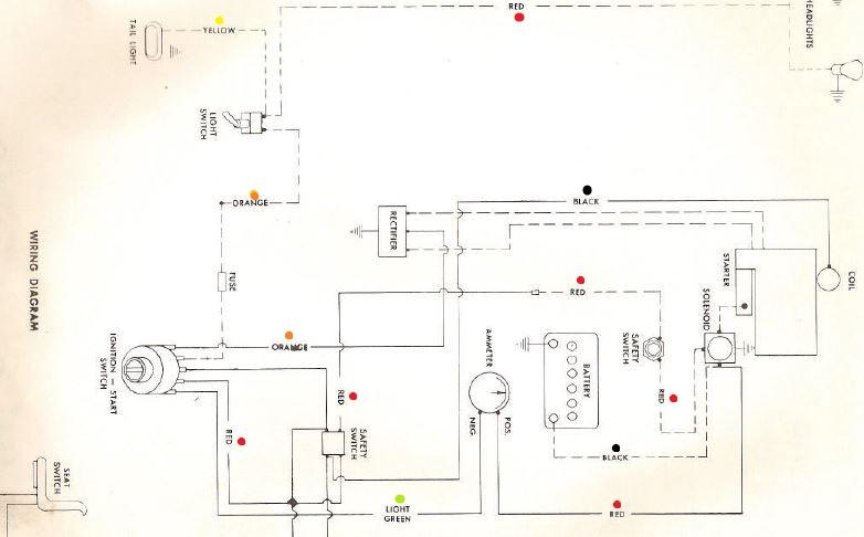

Stormin 4,458 #19 Posted January 17, 2020 I noticed the other day something I had not noticed before. When starting the engine, I go right from on, to the start position. I have now discovered that the starter is turning the engine as soon as the key is turned on and before the start position. If the engine doesn't start and the key released to go back to the on position, the starter motor is still running. Though not engaging the ring gear. Can't be heard with the engine running of course. Switch problem? Got a new switch today and fitted it this afternoon. Same thing happening. I'm thinking two things. (1) The wiring has been messed about a bit at sometime. There is no plug on the harness to the switch. Female connectors on the wires. 4 wires. Red. Orange. Green. Black. I need to know which wire connects to which terminal. Just in case they have been connected wrongly. The wiring diagram doesn't show that, as it is supposed to have a plug connector. (2) Is the starter solenoid faulty. Maybe sticking in start mode. Can it be tested? I hope all that makes sense. Any help gladly accepted before I go doolally and set fire to the thing Share this post Link to post Share on other sites
the showman 4,074 #20 Posted January 17, 2020 Can’t you borrow a solenoid from another tractor to test it ? Share this post Link to post Share on other sites
Stormin 4,458 #21 Posted January 17, 2020 Going to try that tomorrow if I'm in the mood. Share this post Link to post Share on other sites
nigel 1,881 #22 Posted January 17, 2020 Sounds to me the ignition switch is wired up wrong Share this post Link to post Share on other sites
Stormin 4,458 #23 Posted January 17, 2020 I've made enquiries on RS about the switch wiring. 1 nigel reacted to this Share this post Link to post Share on other sites
Anglo Traction 1,022 #24 Posted January 17, 2020 Hi Norm, You don't say what model it is, so I presume it's 1980/81 which uses a 3 position/5 pin 103990 Ign Switch. I've handed my C-120 Info on to Roly with the Tractor, but checked for comparison using parts list. This diagram should be identical for you to check yours- The solenoid may look non serviceable, but I only needs 4 rivets drilling out and replacing after a clean out. Covered it in my C-120/Raider update if you want a link?. Hope it helps. Edit - 103990 switch pins are marked- S- Safety Switch/ Sol Start. R- Rectifier. A- Accessories (lights). I - Igntion (poss via seat safety switch) . B - Battery/Ammeter . 1 1 nigel and Stormin reacted to this Share this post Link to post Share on other sites
Stormin 4,458 #25 Posted January 18, 2020 82 Richard. A new switch has been fitted and connections checked. Several times. Same result. Switch on and starter motor engages. When engine stops turning, without starting and Bendix returns, starter motor continues to run until switch turned off. Took a solenoid off my C-125 and tried that with the same result. I'm suspecting a wiring fault. There are no safety switches fitted and the wires have been joined together. Live to negative. I'm thinking of running two new wires too the solenoid. Bypassing those in the harness. Also may swap the starter motor and the ammeter. Though I can't see either of those being the problem. I'm beginning to wish I'd never seen the darn thing. I've just realised something on reading back. When the key was originally in the on position, the ammeter showed a discharge but did not energise the starter. Oh boy! The plot thickens. I'll go back over everything I've done. Share this post Link to post Share on other sites
