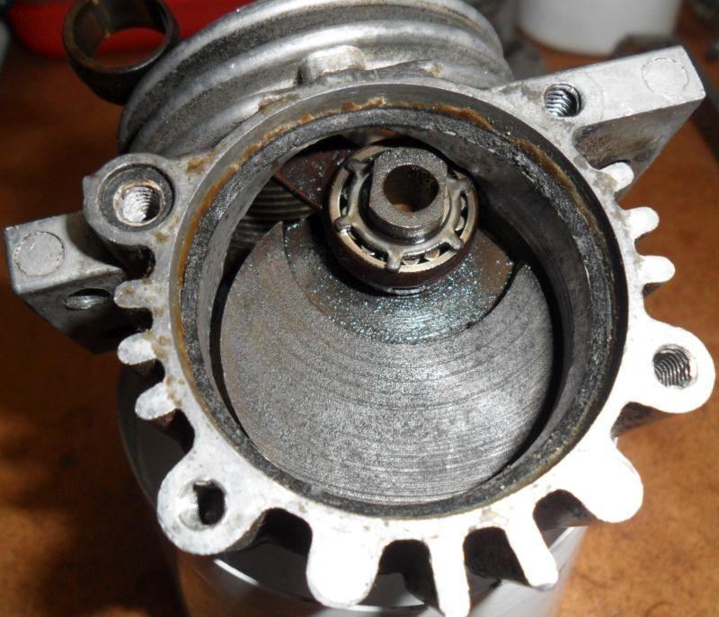

JUST O&R 237 #27 Posted February 1, 2020 Started cleaning up parts today the reed gasket and the induction gasket seem to be the wrong ones very thick . I think some one's been here before the induction gasket is about .017 to .018 thick and the reed gasket was pretty thick too. they maybe from a13b I have a induction gasket and its about .017 thick not sure on the reed gasket 200470 I had to scrap it off Share this post Link to post Share on other sites
CNew 408 #28 Posted February 1, 2020 Definitely seems too thick for a 13A. Share this post Link to post Share on other sites

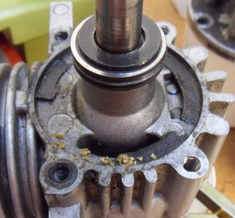

factory 487 #32 Posted February 15, 2020 Here is the first set of the thicker gaskets I came across inside a hedge trimmer engine from 1973 (a year after your Aquabug engine was made). It didn't want to come apart in one piece either. Note: there are different sized gaskets for the exhaust collector on some engines too. David Share this post Link to post Share on other sites
JUST O&R 237 #33 Posted February 15, 2020 That look exactly what I found when I opened this one up. Well maybe I should take it apart and make a few gaskets. Seems like it has enough end play . Share this post Link to post Share on other sites

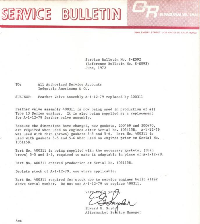

factory 487 #34 Posted February 15, 2020 Found the appropriate service bulletin, from engine SN #1051158 (May 1971) all Series 13 engines used feather valve #400311 with the thicker gaskets (#200469 & #200470), for fitting the feather valve to older engines the thinner brown gaskets (#5-5 & #5-6) are still used. I'm sure I have a sealed NOS feather valve somewhere, supplied with both types of gaskets, the bad news is they also state the shaft seal is not replaceable in this newer feather valve. David Share this post Link to post Share on other sites

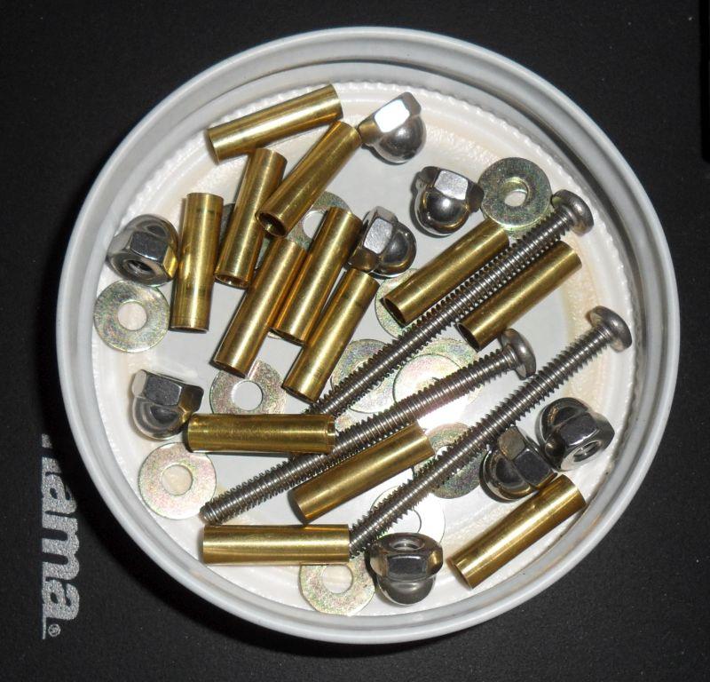

factory 487 #47 Posted February 28, 2020 On 2/22/2020 at 7:13 PM, JUST O&R said: David do you remember how long the spacer were for the cover I will need to round all that up? Will check them at the weekend, I ended up making my own from brass tubing as I couldn't find anything suitable. David Share this post Link to post Share on other sites
factory 487 #48 Posted March 1, 2020 The spacers were made to approx 11/16" length, the wide washers are to prevent damage to the cover (two used per screw). I had to order more screws (#6x32 2" long) as the first ones I ordered were too short, a set of these were sent to Paul for his Aquabug restoration. David 2 Wallfish and pmackellow reacted to this Share this post Link to post Share on other sites
JUST O&R 237 #49 Posted March 4, 2020 Thanks David that helped out got all the spacers cut and found some nuts for the top. The top cracked a little when I tightened the nuts but not bad . I will live with it for now but still came out ok. . 4 factory, pmackellow, CNew and 1 other reacted to this Share this post Link to post Share on other sites
