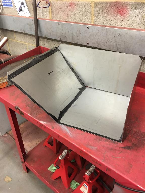

beardyrich 29 #12 Posted March 2, 2020 Did a bit more on my barrow attachment today. Top edges rolled over and just tacked together to check panel fit. 2 Alan and pmackellow reacted to this Share this post Link to post Share on other sites
pmackellow 2,738 #13 Posted March 2, 2020 Neither bucket had the proper clamps unfortunately I have bought some pipe clamps to use on this one, should get a snug fit but still retain the tilt function - hopefully ! Share this post Link to post Share on other sites
Alan 1,274 #14 Posted March 2, 2020 Looking good Richard, but think you are running short of axle stands. Share this post Link to post Share on other sites
beardyrich 29 #15 Posted March 2, 2020 (edited) Paul, I’ll sort out the bucket release mechanism after fabricating the hinges, which I think were made of nylon originally. I don’t think I’ve got any nylon but I might try using some polyurethane material instead. I’m thinking if 2 U shaped pieces which will drop over the tine guard handle when the bucket is tipped upright but hold the bucket in place when it’s lowered. Alan, yes I know... plenty of axle stands. Didn’t realise they were sold in pairs so instead of 10 I got 20!!! Edited March 3, 2020 by beardyrich More information 1 Stormin reacted to this Share this post Link to post Share on other sites
