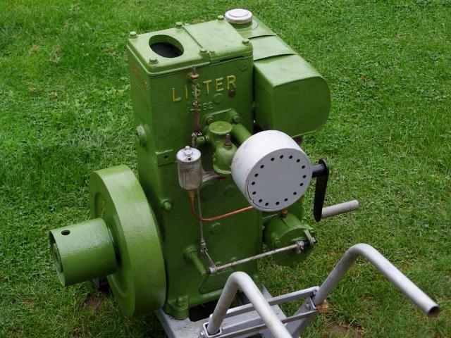

paul 64 #8 Posted August 5, 2014 Here you go Neil. Some more pics of the lister d Share this post Link to post Share on other sites

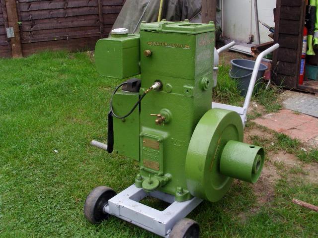

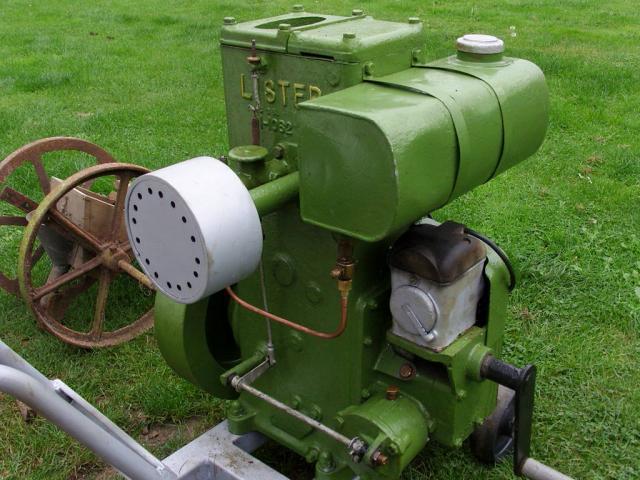

paul 64 #9 Posted September 20, 2014 Lister d finished now. Paul 5 Anglo Traction, Triumph66, Ian and 2 others reacted to this Share this post Link to post Share on other sites

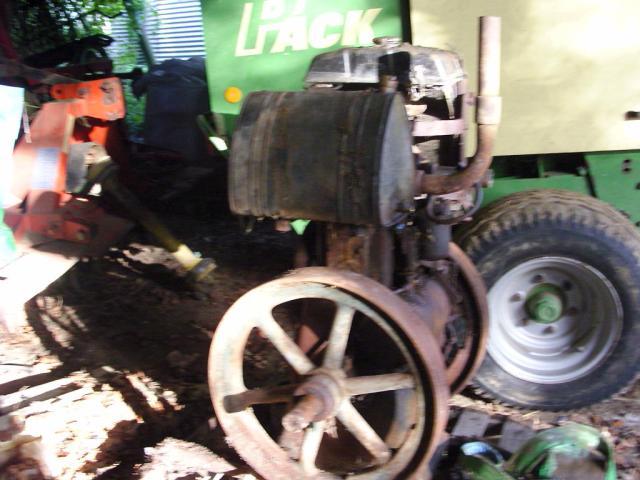

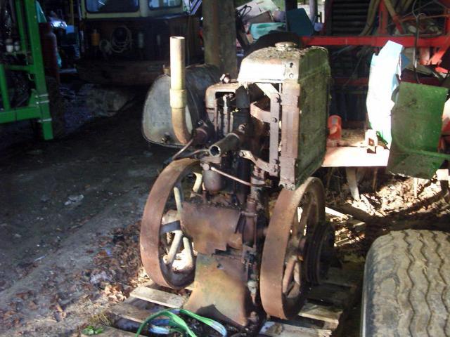

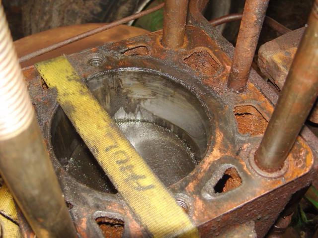

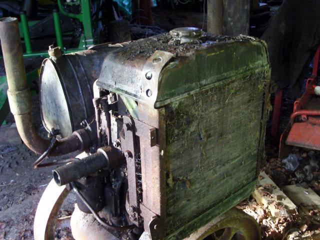

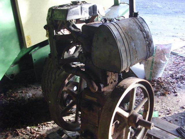

paul 64 #14 Posted October 21, 2014 Hi All This is the last engine in the mentioned barn, a Lister CS 6/1. I thought the engine was seized but when drained about 3 litres of water out it turned over as you can see the bore dosent look to bad. Just got to free most the moving parts up now. Paul 3 Anglo Traction, Lauber1 and Ian reacted to this Share this post Link to post Share on other sites
Lauber1 51 #15 Posted October 22, 2014 like that fuel tank, reminds me of an old style lunch bucket. 1 Ian reacted to this Share this post Link to post Share on other sites
Ian 2,417 #16 Posted October 22, 2014 That's good news about the engine not being seized Paul, your soon have it up and running at the speed you work That is a rather funky shaped gas tank 1 Lauber1 reacted to this Share this post Link to post Share on other sites
meadowfield 1,901 #17 Posted October 22, 2014 it's not a fuel tank - it's a mail box good work btw 1 Lauber1 reacted to this Share this post Link to post Share on other sites
Stormin 4,458 #18 Posted October 22, 2014 it's not a fuel tank - it's a mail box Or one of those things you take your cat to the vets in. 1 Lauber1 reacted to this Share this post Link to post Share on other sites
nigel 1,881 #19 Posted October 22, 2014 Or one of those things you take your cat to the vets in. looks like one of my mrs handbags 1 Lauber1 reacted to this Share this post Link to post Share on other sites
paul 64 #20 Posted October 22, 2014 Hope your mrs does'nt want it back nigel , it stinks of diesel, no hole in it though so will have to see if your wifes left some money in it. Still judging be the other witty comments the smell could be a dead cat. Joke on the side it does have a badge on it but cant remember what it says, I will look. The cap on it is stamped B P (British Petroleum I suppose). I have just made the trolley for the engine today as the one on it was completely rotted so hopefully I can put it on and move it about this weekend. Paul 2 Lauber1 and nigel reacted to this Share this post Link to post Share on other sites

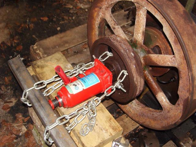

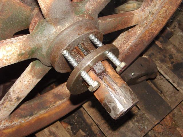

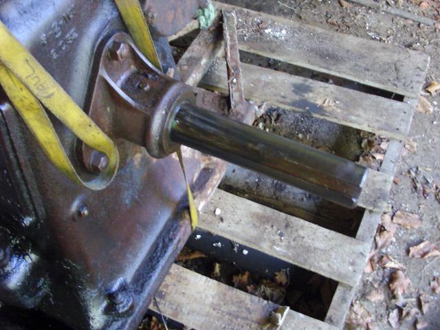

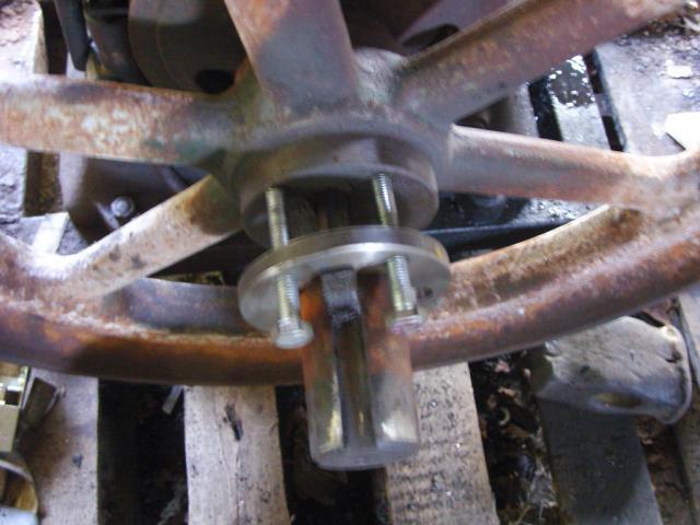

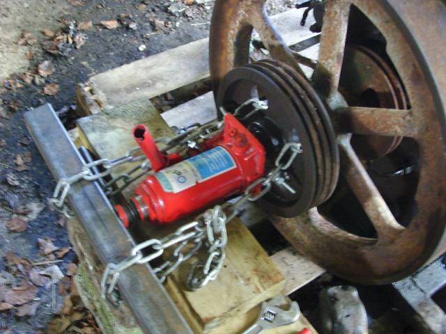

paul 64 #21 Posted November 3, 2014 Hi All I didn't get round to putting the engine on its new trolley over the weekend but managed to get the gib keys out and remove the flywheels. That took most of Saturday, problem is it gets dark quick now or is it that it gets later earlier. Here is some pics. Paul 2 nigel and amcrules00 reacted to this Share this post Link to post Share on other sites
pmackellow 2,738 #22 Posted November 3, 2014 Making progress then mate Share this post Link to post Share on other sites
amcrules00 24 #23 Posted November 4, 2014 Now that's a puller. Share this post Link to post Share on other sites
