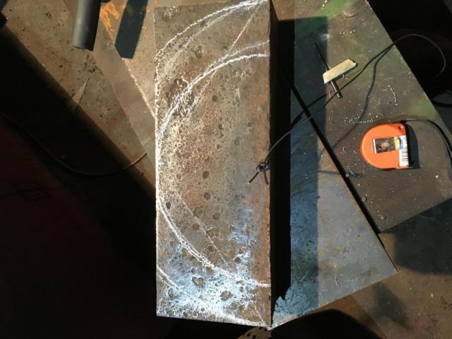

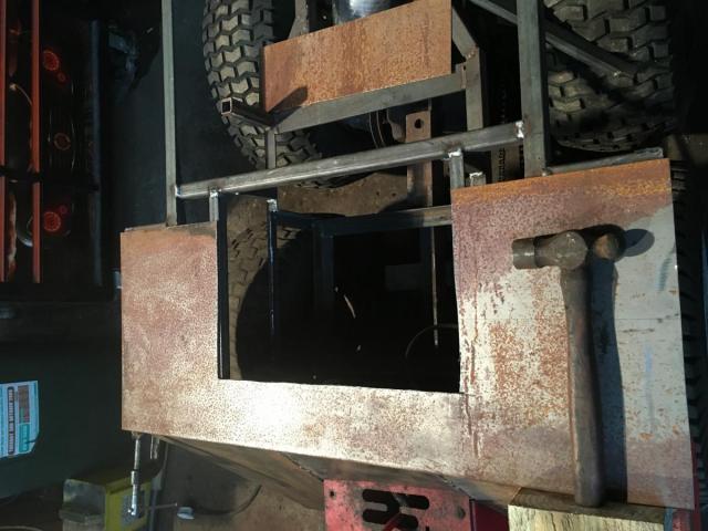

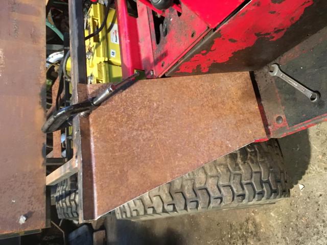

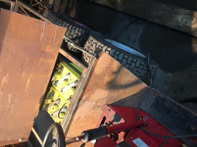

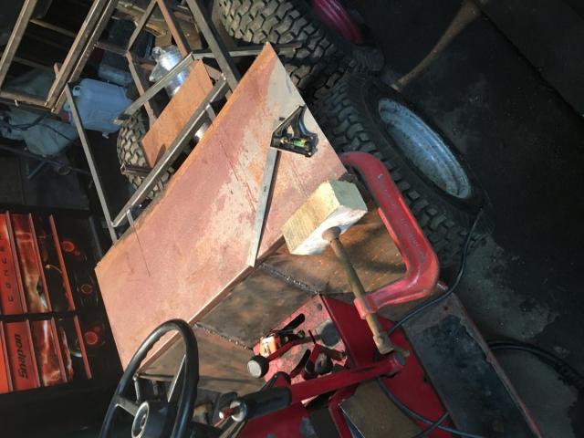

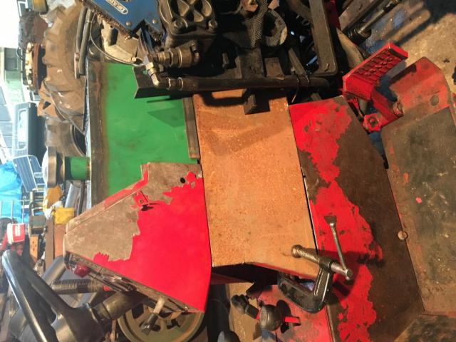

diggerjames 543 #226 Posted January 29, 2016 Hi all another update had a sheet metal day today been fabrications the seat pan and battery access hatch still loads left to do yet but I'm on the down hill push now I hope!! Share this post Link to post Share on other sites

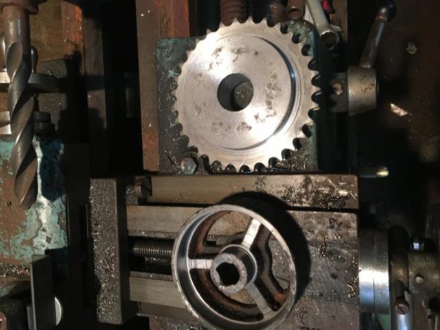

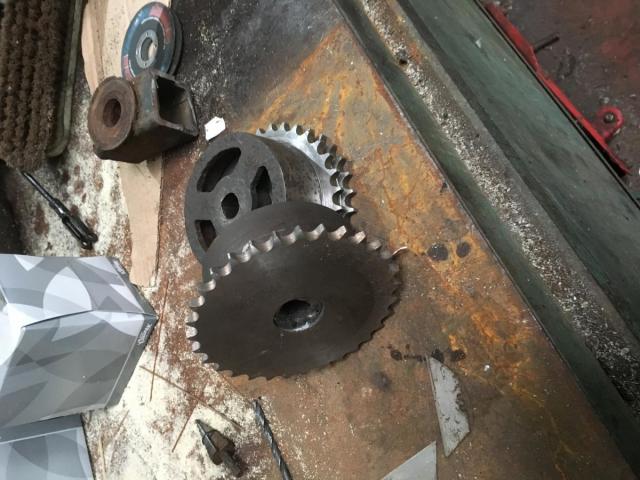

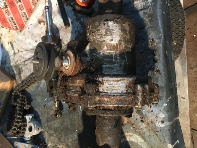

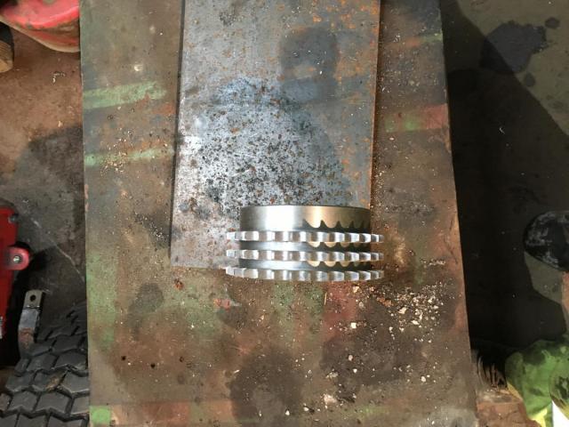

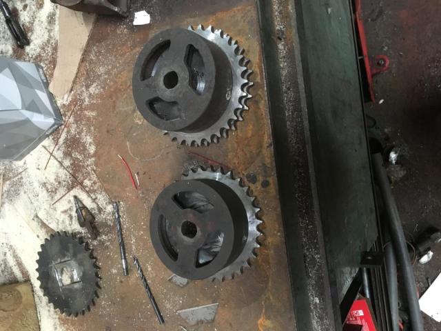

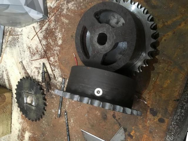

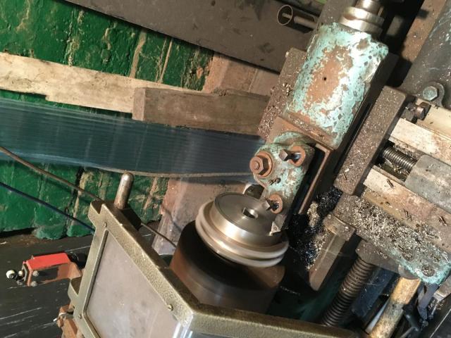

diggerjames 543 #235 Posted February 6, 2016 Hi all as I mentioned earlier I kept having chain issues with the rear drive so i ordered new pilot bore sprockets Similar to What Mark used in fact I have copied his very clever idea on mounting them ( I asked him first if I could copy him ) any way now that my lathe is up and running I bored out the brake drums and the sprockets here's is what I have done 5 meadowfield, Cub Cadet, pmackellow and 2 others reacted to this Share this post Link to post Share on other sites
meadowfield 1,901 #236 Posted February 6, 2016 Nice work buddy, glad I could help 1 diggerjames reacted to this Share this post Link to post Share on other sites
the showman 4,074 #237 Posted February 6, 2016 Good .neat job James 1 diggerjames reacted to this Share this post Link to post Share on other sites
nigel 1,881 #238 Posted February 6, 2016 Nice job james 1 diggerjames reacted to this Share this post Link to post Share on other sites

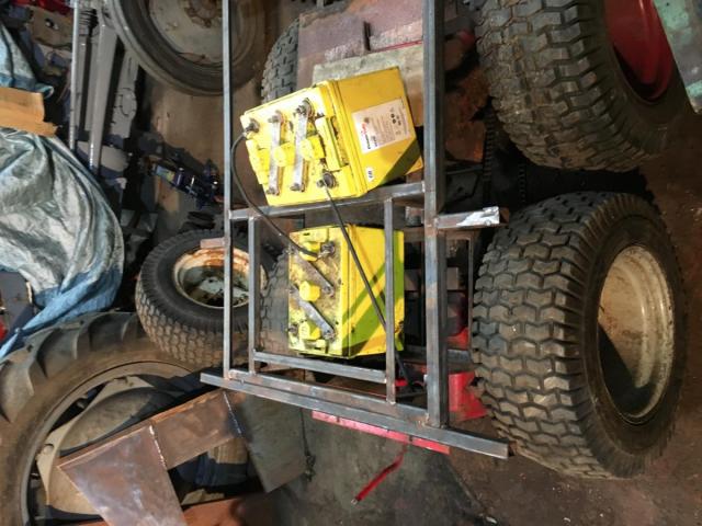

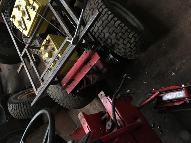

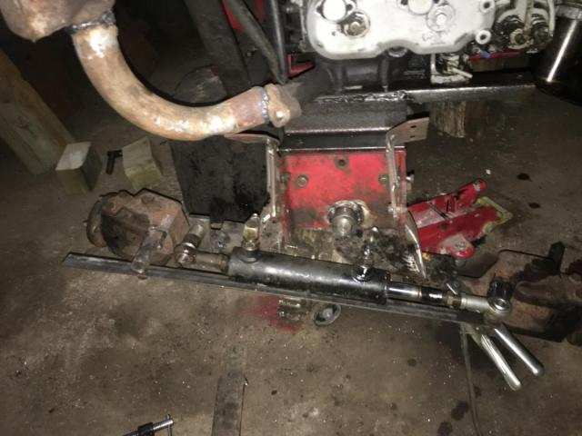

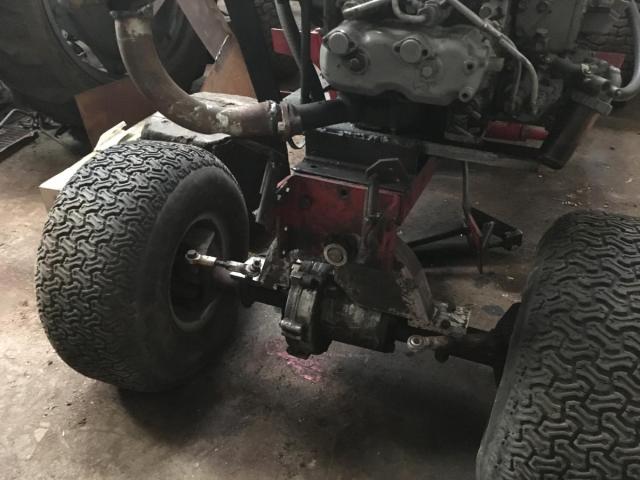

diggerjames 543 #239 Posted February 19, 2016 Hi all a bit of a major update on the project , I've always admired Mark ( meadowfield) c 4x4 and how he did the drive etc any way a couple of weeks ago I managed to get an axle the same as marks what he used I was gonna use it for another project but I thought why not make the 4x6 into a 6x6 so I sat and thought about it after all the work I put into making the steering etc work any way I bit the bull it and using marks thread as a guide I decided to offer up the axle here is what I've done so far!! 6 Ian, nigel, meadowfield and 3 others reacted to this Share this post Link to post Share on other sites

the showman 4,074 #241 Posted February 19, 2016 Surprised your changing all the front end after all the work you did with the power steering but will be nice when its done 1 diggerjames reacted to this Share this post Link to post Share on other sites
diggerjames 543 #242 Posted February 19, 2016 Surprised your changing all the front end after all the work you did with the power steering but will be nice when its done I've saved all the brackets so I can put the same setup on another project Share this post Link to post Share on other sites
Ian 2,417 #243 Posted February 19, 2016 If your gonna build it might as well build it BIG That's going to be a beast of a machine when it's done.. Keep up the mad work mate 1 diggerjames reacted to this Share this post Link to post Share on other sites

diggerjames 543 #245 Posted February 20, 2016 Hi all a quick update I've now fitted the new chain which seems to be a lot better in quite impressed with it , and I've tested the new steering which also works quite well I do however need to make a few adjustments to the steering bracket which fastens to the axle ! Here's a quick video Since fitting the new axle it has picked up the front end up thus lifting the middle axle and making the middle axle air Bourne so I have now got to split the tractor and re drill the axle mounting plate to level up the tractor 1 nigel reacted to this Share this post Link to post Share on other sites
