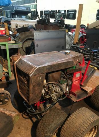

diggerjames 543 #251 Posted March 1, 2016 Evening all progress has been a little slow as late with work and family but I have managed to do a few things ! With me now making it six wheel drive I now don't need to have the rear axle articulating this does two things , makes me able to strengthen up the load bed , and makes it less likely for the chain to slip off , I have plenty of articulation on the front axle so it should be ok ! I have also put the bonnet on and I have to say it sits nice and tall such I love ! 2 Ian and nigel reacted to this Share this post Link to post Share on other sites

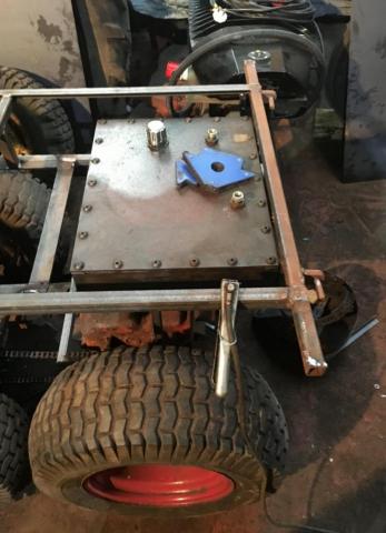

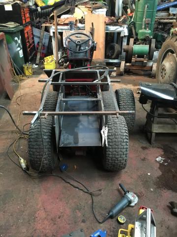

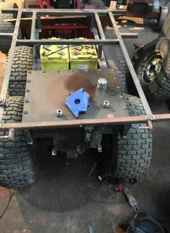

diggerjames 543 #272 Posted March 11, 2016 Hi all a quick update restarted the fabrication work on the rear tub , I will post more pictures in due course here is a taster of what I've done so far Share this post Link to post Share on other sites
the showman 4,074 #273 Posted March 11, 2016 Wow-cha, you've done it mate 2 expeatfarmer and diggerjames reacted to this Share this post Link to post Share on other sites
Stormin 4,458 #274 Posted March 11, 2016 Whey! Hey! No more kinked necks. 1 diggerjames reacted to this Share this post Link to post Share on other sites
