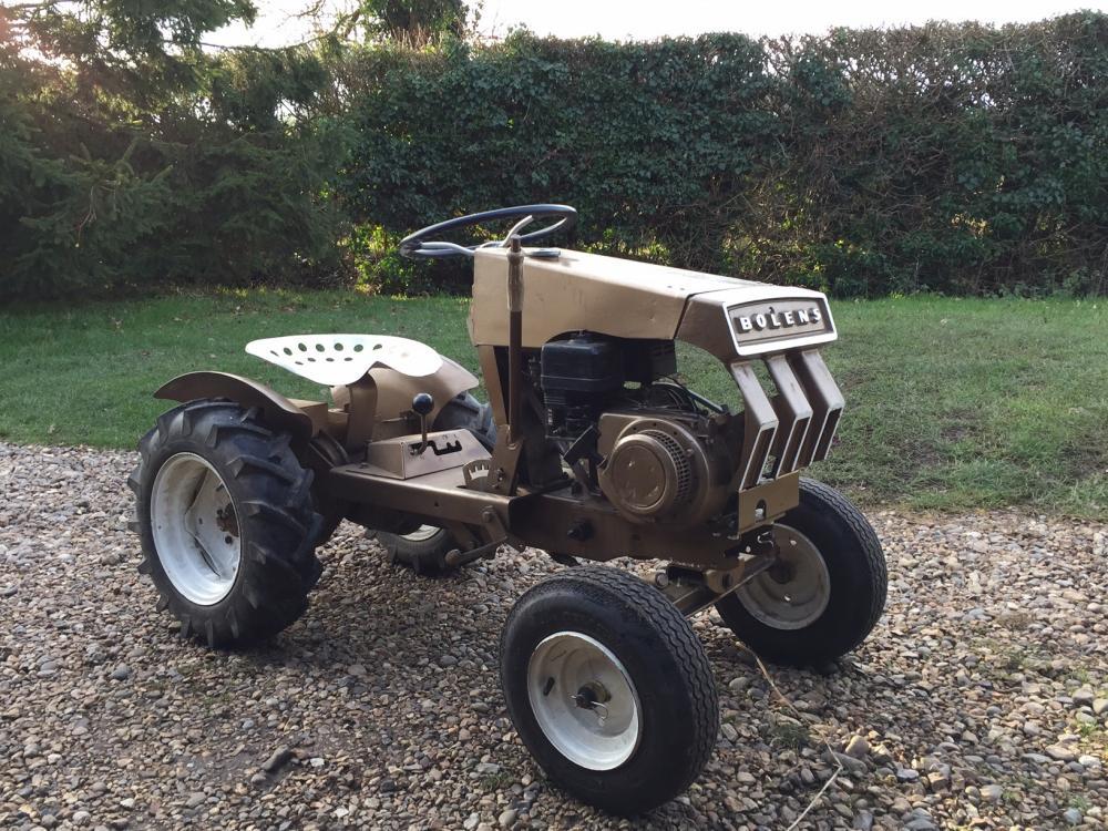

HeadExam 1,783 #33 Posted September 7, 2016 26 minutes ago, Wallfish said: There's one for sale up by me. But isn't $700 a bit over priced? it can always ship to OK fairly inexpensive using Fastenal. The price is not objectionable for a nice complete '62, unfortunately this one has some issues. The belt guard is missing, as is the rear lift and chassis cover, looks like it was removed. Also some kind of wire hanging out front for somthing, probably a plow lift, missing plow. The steering wheel shows hard wear. The front axle looks like it might have been replaced, again hard wear. No attachments. I saw a restored one with deck rear lift, front finger mower, and snow plow for 1000.00, I should have bought it, but I was and am still buying accessories (limited funds) of other tractors. I would bet the owner would negotiate on this '62, but I have a strict rule I follow, that if it isn't worth the asking price, it probably isn't worth the sale price. I want the one that is the one, it's always out there. I really appreciate you letting me know about this one, everyone I see I learn more about them. I use Fastenal as well and find it is a better deal for a whole tractor than a set of wheel weights. Thanks 1 slf-uk reacted to this Share this post Link to post Share on other sites
slf-uk 914 #34 Posted September 7, 2016 7 hours ago, HeadExam said: The price is not objectionable for a nice complete '62, unfortunately this one has some issues. The belt guard is missing, as is the rear lift and chassis cover, looks like it was removed. Also some kind of wire hanging out front for somthing, probably a plow lift, missing plow. The steering wheel shows hard wear. The front axle looks like it might have been replaced, again hard wear. No attachments. I saw a restored one with deck rear lift, front finger mower, and snow plow for 1000.00, I should have bought it, but I was and am still buying accessories (limited funds) of other tractors. I would bet the owner would negotiate on this '62, but I have a strict rule I follow, that if it isn't worth the asking price, it probably isn't worth the sale price. I want the one that is the one, it's always out there. I really appreciate you letting me know about this one, everyone I see I learn more about them. I use Fastenal as well and find it is a better deal for a whole tractor than a set of wheel weights. Thanks Alain, finding a ride-a-matic that still has the belt guards is always a challenge, someone could make good money pressing out replacements. Two of the RAM's I have I bought as parts tractors specifically because they still have the belt guards fitted, although I can't bring myself to break them up and one day I hope to get at least one running. Your spot on with the wire hanging out the front, this is for lifting the front attachments which is very crude compared to the sophistication of the rear lift. The earlier RAM's had a chain as a front lift mechanism. 2 HeadExam and Triumph66 reacted to this Share this post Link to post Share on other sites

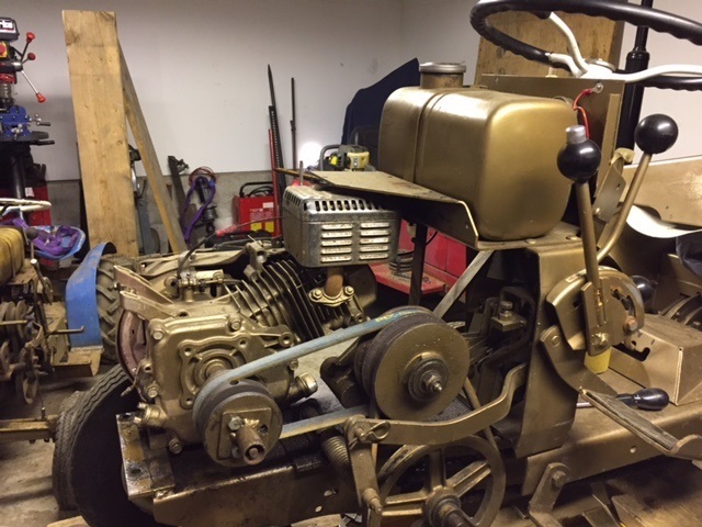

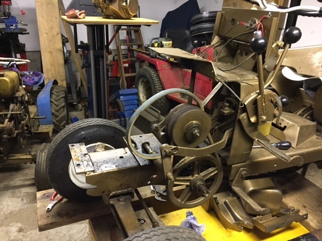

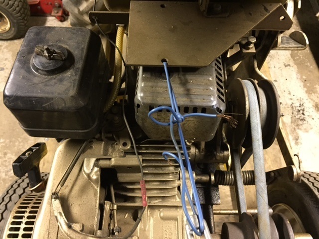

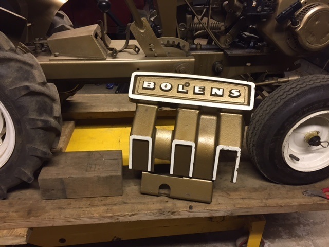

slf-uk 914 #35 Posted December 27, 2016 Today Joseph and I had a day in the workshop and we did some work on the 1962 RAM. The original plan was to fix some of the bodges and make up some missing parts. The more we looked at it the more problems we found. We ended the day with the hood, grill, fuel tank and engine off. The blue wire was the fixing to hold the top of the grill I was surprised how heavy the cast grill was Then the hood came off which is was fiddly We ended the day with most of the front apart The fuel system was dismantled and cooked in the ultrasonic cleaner, all the missing fixings were replaced and a few other jobs. It's now ready for reassembly. Iain 2 Triumph66 and HeadExam reacted to this Share this post Link to post Share on other sites
Triumph66 1,256 #36 Posted December 27, 2016 Iain and Joseph your RAM looks fantastic and I will be very interested in seeing how the carbs cleaned up in the cleaner. Again I am struck at how much of a quality and well built machine these RAMs are. I would love a '62 (?) RAM myself as I do like the front design of it. You better secure it Joseph when I pop in sometime..... 2 slf-uk and HeadExam reacted to this Share this post Link to post Share on other sites

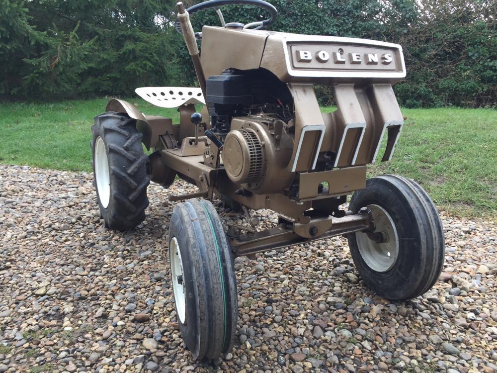

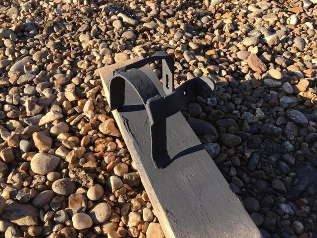

slf-uk 914 #37 Posted December 29, 2016 We got the tractor back together today and running. To enable the Versamatic to work correctly I made this bracket from some scrap To complete the planned work I needed to make a bracket to hold the grill. I cut all the parts and then my very expensive and not very old MIG decided to break. It is still under warranty so not the end of the world, but not helpful. A temporary fix was put in place so we could test the tractor. I did a quick video of the test run on my phone and yes it was cold Iain 4 Triumph66, HeadExam, Alan and 1 other reacted to this Share this post Link to post Share on other sites
Triumph66 1,256 #38 Posted December 29, 2016 Fantastic update and good to see it running well. The engine sounds sweet too even though it's a tad noisy! Your welding is looking spot on ! You guys got to be on the home straight now on the RAM? 1 slf-uk reacted to this Share this post Link to post Share on other sites
Chris 642 #39 Posted December 29, 2016 Mini Iain does look like he can steer Needs bigger exhaust system I will have to venture up to try it soon 3 Triumph66, slf-uk and HeadExam reacted to this Share this post Link to post Share on other sites
slf-uk 914 #40 Posted December 30, 2016 16 hours ago, Triumph66 said: Fantastic update and good to see it running well. The engine sounds sweet too even though it's a tad noisy! Your welding is looking spot on ! You guys got to be on the home straight now on the RAM? Thanks Andrew, I have just ordered a replacement exhaust. We are planning to move on to something else today. 14 hours ago, Chris said: Mini Iain does look like he can steer Needs bigger exhaust system I will have to venture up to try it soon I was unsure if he was going to steer away, you may have noticed the nervous camera shake. You welcome anytime Chris it is always good to see fellow GT collectors. Iain Share this post Link to post Share on other sites
Triumph66 1,256 #41 Posted December 30, 2016 8 hours ago, slf-uk said: I was unsure if he was going to steer away, you may have noticed the nervous camera shake. You welcome anytime Chris it is always good to see fellow GT collectors. Iain Iain, i did noticed the camera shalke at the end but put it down to the vibrations from the RAM"s echaust ! 1 slf-uk reacted to this Share this post Link to post Share on other sites
HeadExam 1,783 #42 Posted January 7, 2017 On 12/30/2016 at 4:52 AM, slf-uk said: Absolutely beautiful. A real piece of history Share this post Link to post Share on other sites

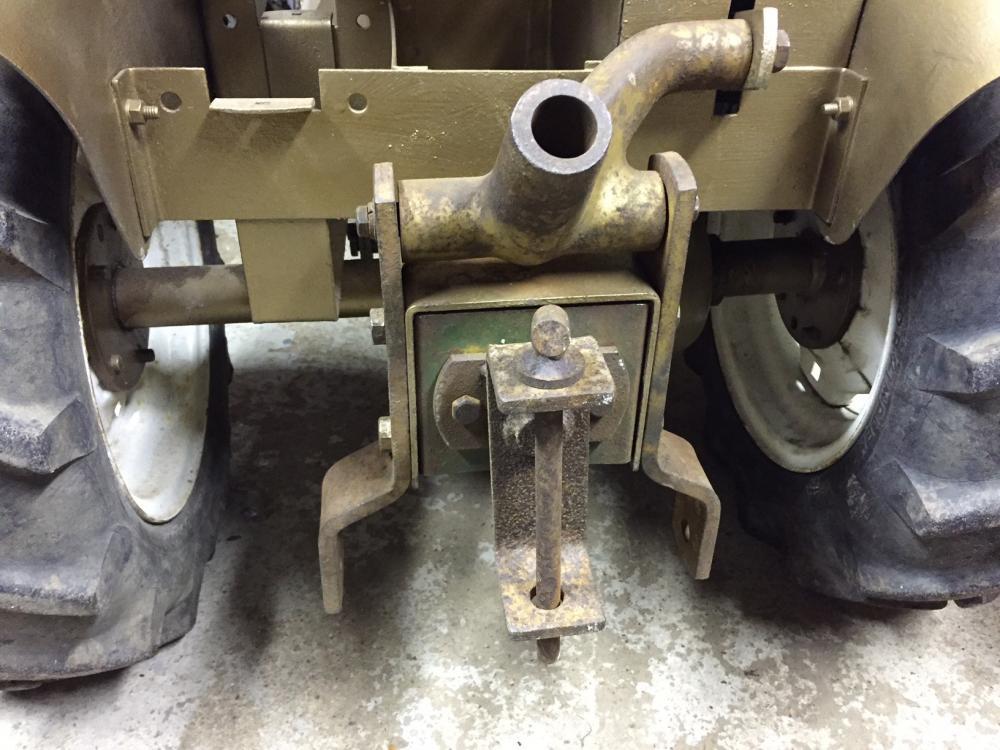

slf-uk 914 #43 Posted January 28, 2017 We had a bit of tractor time today. A replacement exhaust was fitted, the fuel system sorted and a rear closing panel and tow hitch on the chassis. For the hitch a couple of Bolens buddies in the US sent some parts over and I borrowed a couple of small bits from my other Ride-a-matics. I now need to copy all the parts for the other tractors. Lots of jobs still to do but it is now a useable tractor We decided to use the tractor to tidy up some old pallets. Not sure if the cat was happy but it kept Joseph warm First tractor time since the Christmas break which was great. Iain 1 Triumph66 reacted to this Share this post Link to post Share on other sites
