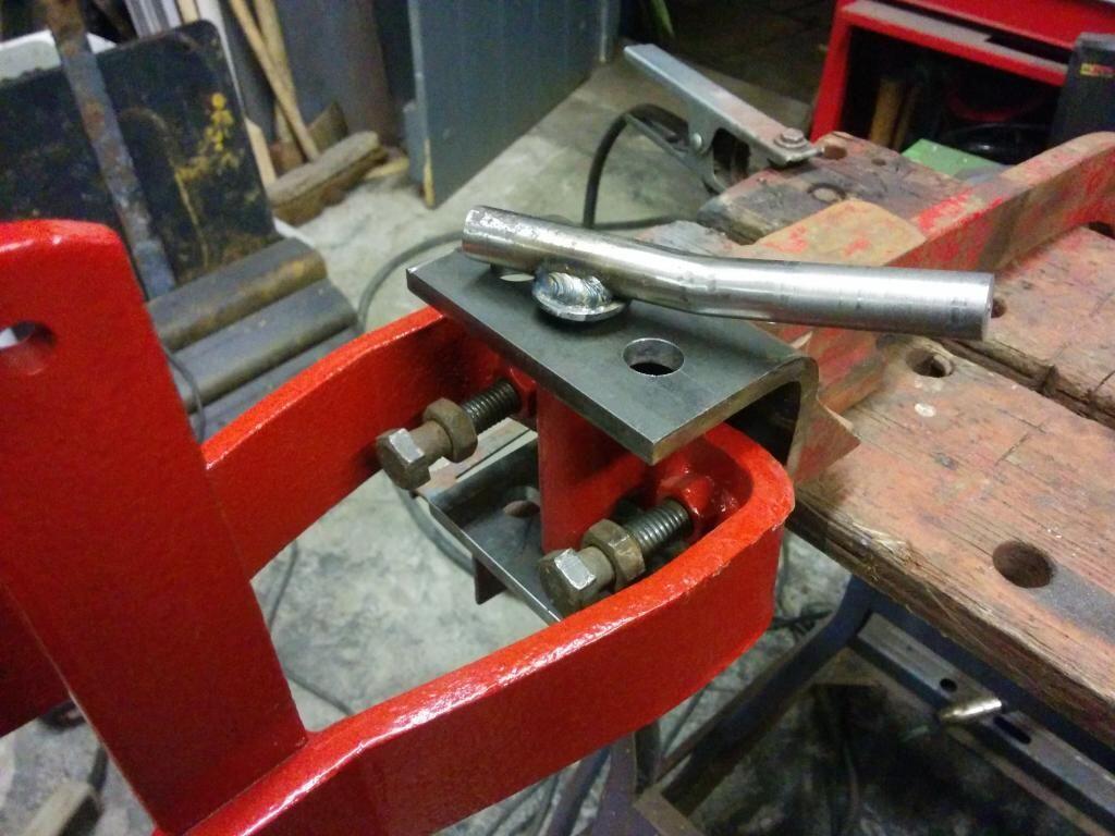

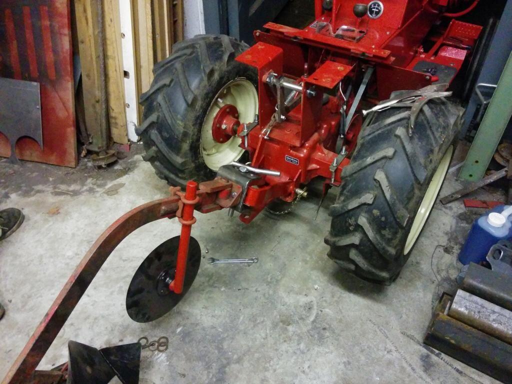

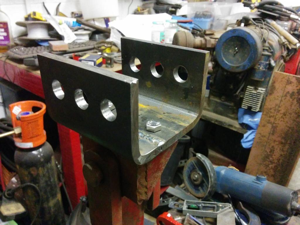

meadowfield 1,901 #1 Posted January 2, 2015 My son bought a plough cheap at a show, finally got round to modifying it to clevis mount. Firstly making the mount from a few chunky bits of metal from Doug And then making the handle 3 nigel, ranger and Triumph66 reacted to this Share this post Link to post Share on other sites
Stormin 4,458 #2 Posted January 2, 2015 Now this I will follow with great interest. Plenty of photo's please. 1 meadowfield reacted to this Share this post Link to post Share on other sites
Ian 2,417 #3 Posted January 2, 2015 Nice fabrication work mate.. Is that my old clevis hitch? If so it certainly looks a million times better with some paint on it.. Share this post Link to post Share on other sites
meadowfield 1,901 #4 Posted January 2, 2015 Nice fabrication work mate.. Is that my old clevis hitch? If so it certainly looks a million times better with some paint on it.. Tis indeed, has had the 10 ton press treatment to straighten it out Now this I will follow with great interest. Plenty of photo's please. Will see what we can do! Share this post Link to post Share on other sites

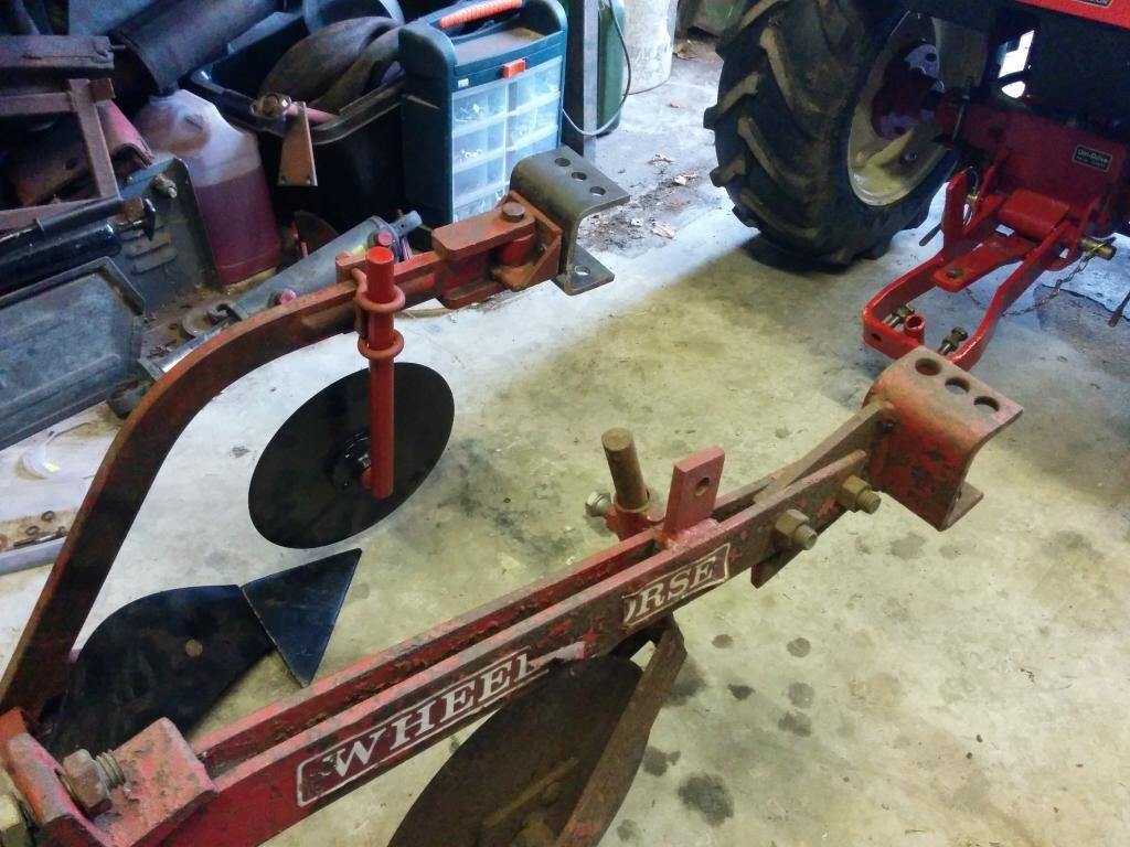

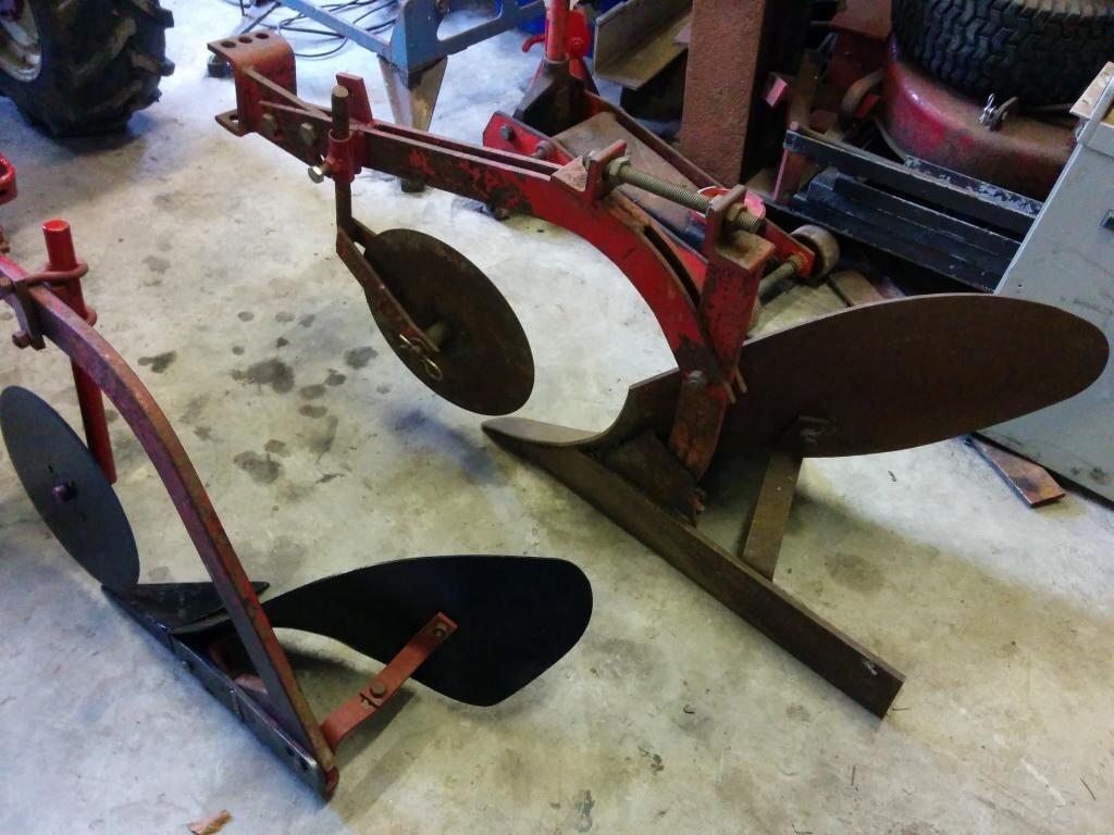

Tom 215 #7 Posted January 3, 2015 Looking forward to this, is that the rigid body or adjustable barford atom plough? I have always thought of doing this to one of mine.. Tom Share this post Link to post Share on other sites
meadowfield 1,901 #8 Posted January 3, 2015 Looking forward to this, is that the rigid body or adjustable barford atom plough? I have always thought of doing this to one of mine.. Tom No idea Tom, it was fastened to a 2 inch round tube, there's no adjustment so we will need to modify Share this post Link to post Share on other sites

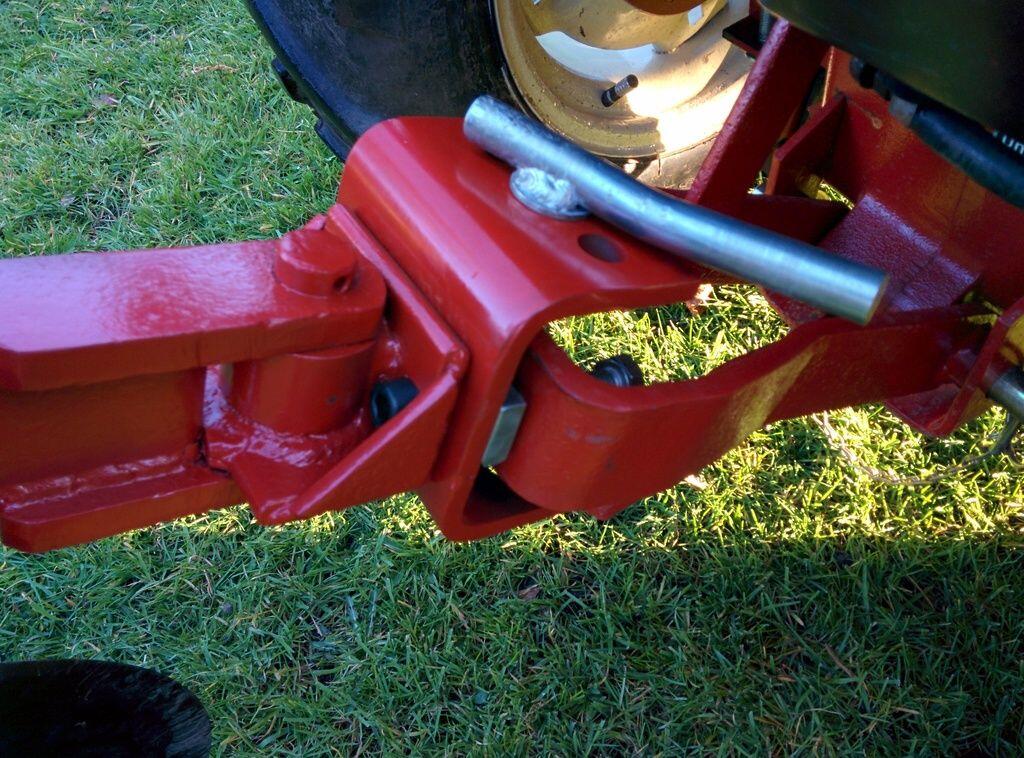

meadowfield 1,901 #9 Posted January 3, 2015 Actually set it at the side of my mahoooosive 12" plough... Other than size the geometry is about the same So other than painting the clevis adapter, that's about it! 2 Triumph66 and ranger reacted to this Share this post Link to post Share on other sites
meadowfield 1,901 #10 Posted January 4, 2015 Well it does lift from the deck handle too, made a rocker shaft, bushes and lift arm. Might do a thread on that... 1 Stormin reacted to this Share this post Link to post Share on other sites
Tom 215 #11 Posted January 4, 2015 Looking really good mark, you have done an excellent job. Definitely post up a thread regarding the rocker shaft as I have been thinking about making one too and it would be interesting to see how you did yours. Tom 1 meadowfield reacted to this Share this post Link to post Share on other sites
Stormin 4,458 #12 Posted January 4, 2015 Well it does lift from the deck handle too, made a rocker shaft, bushes and lift arm. Might do a thread on that... Please do. Looks a lot better and stronger than the WH cable arrangement. My main problem would be the fuel tanks, being at the back. Share this post Link to post Share on other sites
meadowfield 1,901 #13 Posted January 4, 2015 Here you go boys! http://myoldmachine.com/topic/1532-wheel-horse-clevis-hitch-lift-assembly/ It's strong enough to lift my 17 year old son... He stood on the clevis whilst I pulled the handle Share this post Link to post Share on other sites

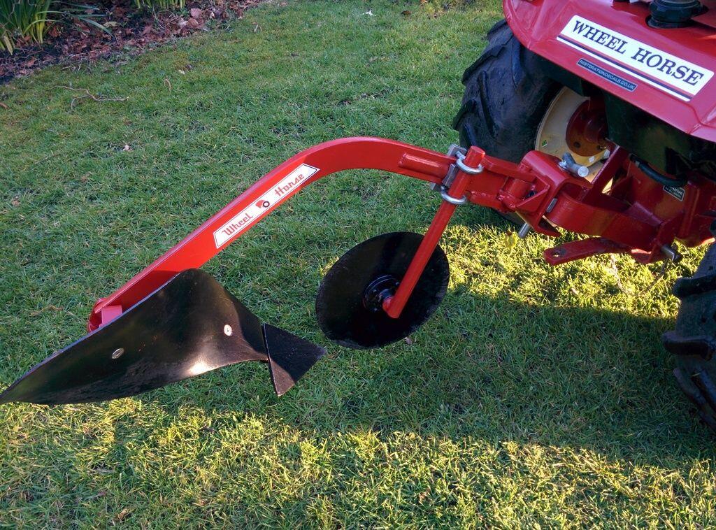

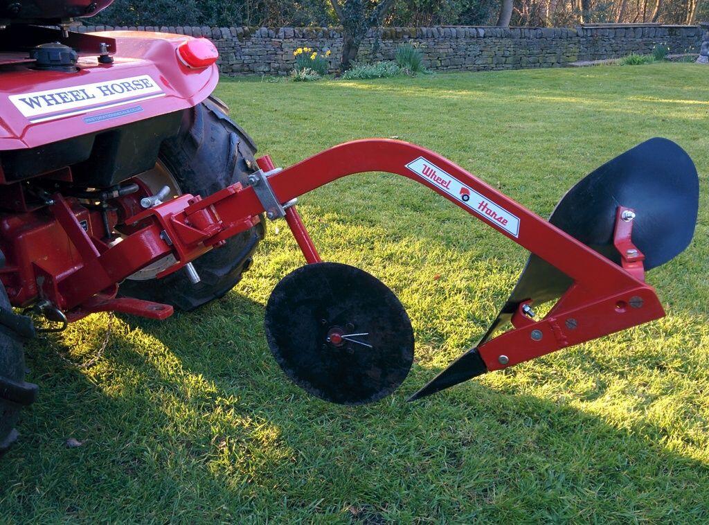

meadowfield 1,901 #14 Posted March 27, 2015 been a while since this thread was updated.... Ewan has been hard at work plating parts and using all new stainless fasteners. With a lick of paint and a few stickers, here is the finished plough! All ready for this years Wheel Horse roundup 3 Ian, slf-uk and Triumph66 reacted to this Share this post Link to post Share on other sites
Tom 215 #15 Posted March 28, 2015 Very nice Mark, you guys have done a great job, you'd never know it was off of a Barford atom. I look forward to more pictures of it after the wheel horse roundup. Tom Share this post Link to post Share on other sites
Stormin 4,458 #16 Posted March 28, 2015 Very nice. I'm going to have a good look at that at Newby. Share this post Link to post Share on other sites
Tom 215 #17 Posted March 29, 2015 Hi Mark, I was just wondering if you knew what the rough height of the hitch end of the plough was when it's sitting on the floor? Tom Share this post Link to post Share on other sites
meadowfield 1,901 #18 Posted March 29, 2015 I'll take some measurements at the weekend. Geometry wise it's a smaller version of my 12" mouldboard, it seems to scale right for the depth. Other then the lawn we haven't tried it yet.... Share this post Link to post Share on other sites
