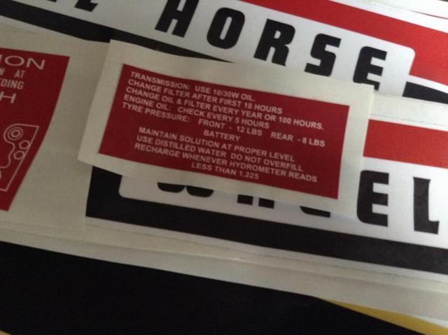

meadowfield 1,901 #20 Posted January 10, 2015 It does sound wrong using engine oil, but times have moved on. Things have improved and engine oil on modern cars is used for the gearbox/diff as well.... My C101 has 10w40 in the transmission too for the last 4 years. Only downside is it leaks out faster Share this post Link to post Share on other sites
Stormin 4,458 #21 Posted January 10, 2015 The old girl was incontinent; hence my supply of EP90 Nah! She was just marking her territory. 1 meadowfield reacted to this Share this post Link to post Share on other sites
meadowfield 1,901 #22 Posted January 10, 2015 I said 10w40, but the sticker says 10w30. But as it's always colder here then 40 is better anyway 1 Joe the small engine man reacted to this Share this post Link to post Share on other sites
