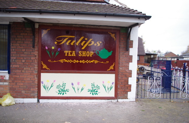

Mister Mad Mower 64 #12 Posted November 3, 2016 (edited) Just knocked this sign up today for a friend who i have done a lot of work for over the past 18 months . The building was built in 1927 as a garage , The sign is over the old entrance which once was 2 wooden doors then blocked up in the 70's as 3 fuel pumps were installed in the alcove it created , then it has ended up following 18 months of work as a bungalow in the rear workshop area and tea rooms ( shop ) in the front . The sign is not the best as the new occupier wanted me to just paint the burgundy and cream onto the old plywood ! . But the vinyls have made it stand out along an otherwise plain , long road . Diverging slightly - When digging out for the foundations i had to remove the origonal 1927 floor , it was simply 1" to 3" limestone embedded in bitumen ( tar ) with around 3/4" of cement covering it , No need for the breaker on this one it just dug up ...But nice to see how it used to be done . The blue fencing , i cut down and welded from 10 foot high to 4 foot to give the new bungalow a more residential feel , taking away the industrial look of the high fence . My old 1976 Villiers powerd mixer can just be seen peeking around the corner of the building ( wheel and yellow painted frame ) The sign it's self was set out by using chalk to mark the center line on the sign boards and chalk on the lifting tape of the stickers to indicate the center length of the writing / graphics. The required heights marked with chalk on the frame and masking tape run between them to make a removable line to sit the lower edge of the words etc on to get them level . The top of the paper backing material was folded back to the top of the vinyl and folded under to expose the top of the lifting paper .The folded under paper keeps the lifting paper away from the sign allowing for easy positioning before sticking the exposed lifting tape down . The backing paper can then be removed , holding the sticker away from the sign whilst doing this . As the top edge of the lifting paper is stuck down , as the rest is lowered and swiped to remove air , the lifting tape positions the wording / graphics as you go due to it's stiffness . The sign is 2.5m x 2.5m in size , so the writing isnt small by any means , but the above method allowed for easy and precise placing , even in the drizzling windy conditions i had . Though due to the 5deg temp i had to leave the lifting tape over the vinyl for around 20 mins to allow the vinyl's glue to get a hold as otherwise the stickers just wouldnt have stuck to the painted sign boards and could have lifted / ripped . ( yellow bags on the floor have the removed backing paper in , a good idea on windy days ) . Edited November 3, 2016 by Mister Mad Mower 3 Will-Haggle, Stormin and Alan reacted to this Share this post Link to post Share on other sites
