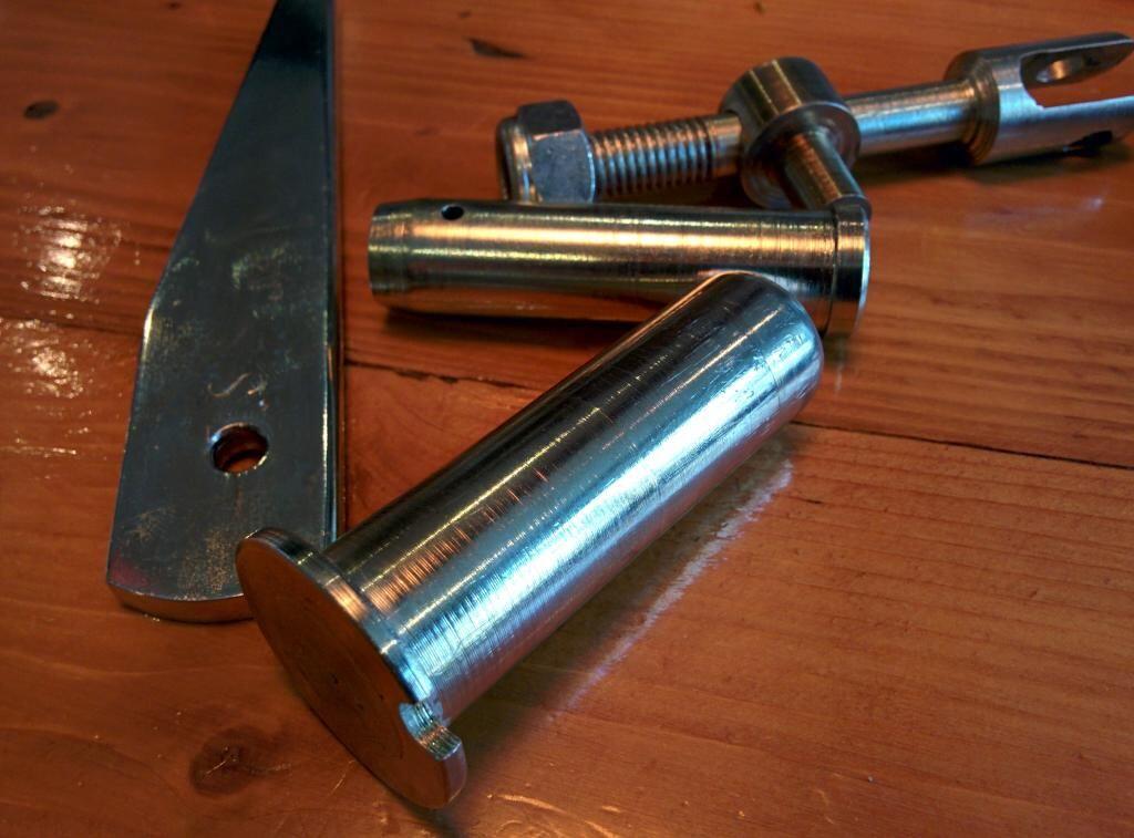

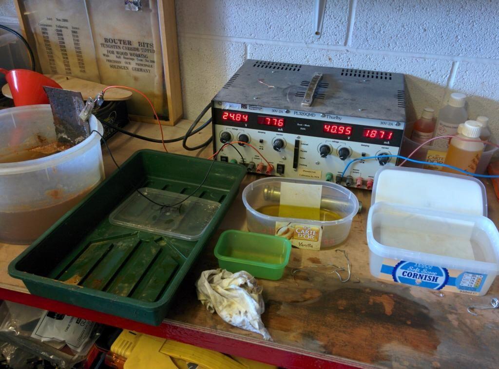

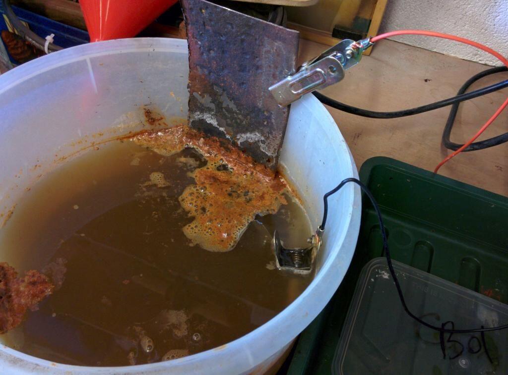

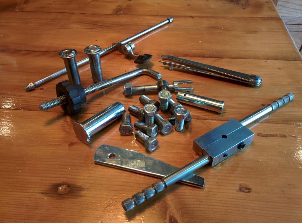

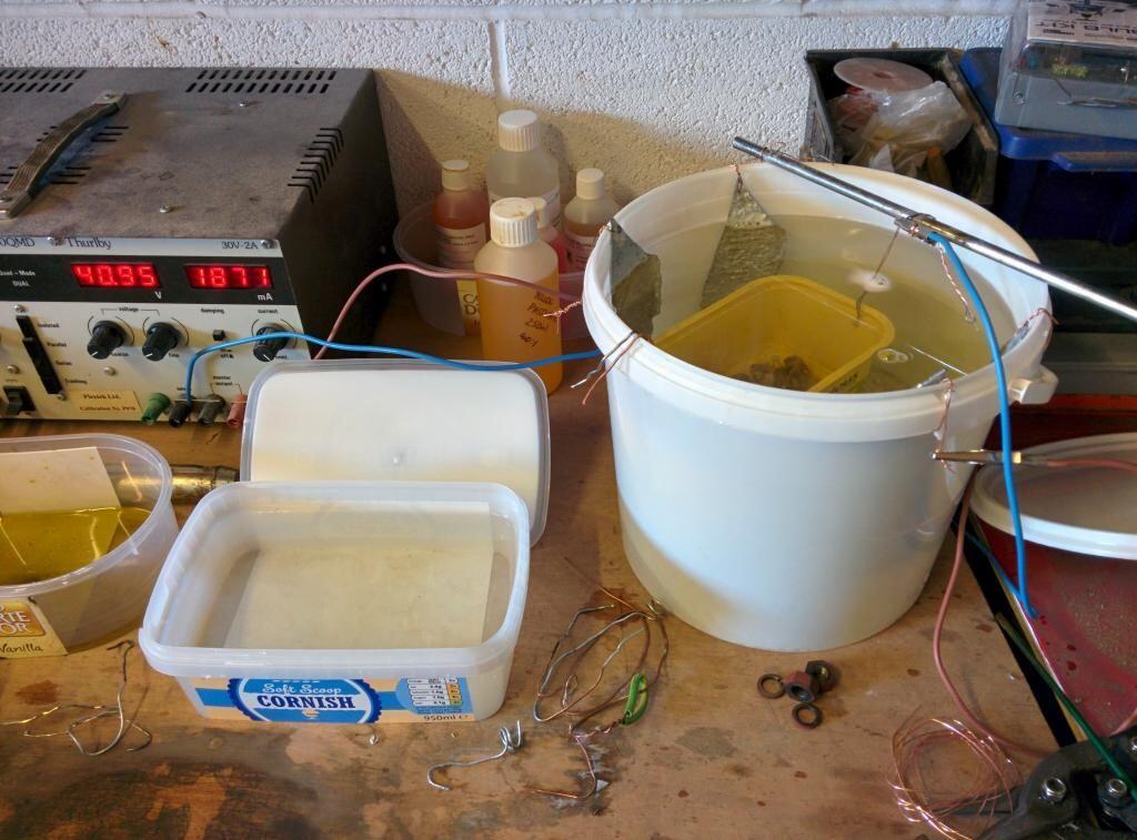

meadowfield 1,901 #1 Posted February 21, 2015 I've been a big fan of e tanks for a while now, they are great labour saving items and work wonders on all manner of things. Here's my small setup on the bench cooking small pieces for bendy. These were lug nuts with 45w of power running through them, you can't see the gassing - but a reasonable amount of hydrogen was being given off So this is only one half of the set up... I looked into electro plating years ago and just couldn't lay my hands on the correct electrolyte. It was a bit Heath Robinson even by my standards About 6 months ago my brother managed to source a kit and has had some pretty good results tarting up parts on his range rover. So I bought the chemicals and some zinc before Xmas. So now the other half is my plating rig, parts go in rusty or bare metal and come out shiny and fairly rust resistant. The camera doesn't do it justice on some of the pieces. Here's a few bits we've done Which means bendy can actually get 5 bolts per wheel, when I get them all cleaned 1 nigel reacted to this Share this post Link to post Share on other sites

meadowfield 1,901 #9 Posted February 21, 2015 looks very pretty, now, where did you get those chemicals? and maybe some instructions? The ammonium chloride, and zinc chloride are part of a kit I managed to buy. The bits separately were more expensive than paying for a packaged kit. The expensive bit that helps is a really good power supply. The hardest bit is the cleaning, everything has to be spotless, the plating then takes 30 mins Interesting stuff, Mark. When can I bring some bits over? If they are small enough and spotless, you are welcome to see the results! Good work Mark, what would be the rough cost to set that lot up ???? About £80, not including the power supply Neil 1 neil reacted to this Share this post Link to post Share on other sites

Anglo Traction 1,023 #12 Posted September 21, 2015 From what I have read, learned and tested over the years of using this process, the best Battery Charger set up is to have an older type Charger that has no 'Auto Reduction' or Cut Out. 4 Amps is about ideal, but I've obtained good results with 2.5 amps (or less) and used an Auto Reduction Charger . It just takes longer to do it's job on large pieces/panels. Power/efficiency reduces with build up of corrosion on the Anode Rod(s) and resistance increases ,so you can work with what you have if you clean the Rods regularly and keep the gap between Anode and the Work piece to a reasonably close position. A handy method I use is to have 2 sets of Anode Rods. I use one set then switch them over, but use the process to clean the old Rods, saves a lot of cleaning. Share this post Link to post Share on other sites
Wristpin 400 #13 Posted September 21, 2015 Thanks for the suggestions. At present my anode is a section of steel grid facing the target area but I'm in the process of obtaining enough to completely line the inside of the drum. The charger that I'm using is around thirty years old and seems to be working reasonably well ; when I was reversing the process to derust the interior of some mower fuel tanks I had to put a twenty watt light in series with it or it would shoot up to ten amps and the trip it's thermal cutout! I really like the idea of "reverse cleaning " the anodes. Share this post Link to post Share on other sites
meadowfield 1,901 #14 Posted September 22, 2015 I'd say for a huge drum you need more than 12V, I have used a 28V power supply from the aviation industry with good results. Or two 12V batteries in series... To get as close as possible to the anode I have often put the parts to be cleaned in a container and sat it straight on the anode. I too have reversed the anodes - I've also used this process to age metal when I was making reproduction hinges Share this post Link to post Share on other sites

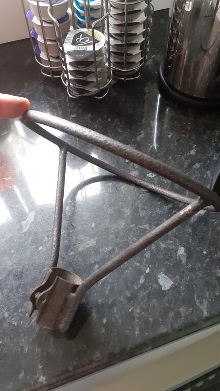

Sharri Dandy 5 #16 Posted June 25, 2020 Just showing off my wee set-up. I use it for anything covered in a rusty crust. Currently making carrot and corriander soup for dinner hence the set-up being in the kitchen😜. Ok its the prop guard from my Atco boatimpeller before it possibly goes for powdercoating with a bag of bits from other projects not decided on the finish yet. The powder coating guy only charges me a nominal £5 or £10 for each item if I do all the hard work. Wiping the sludge off and a quick wire brush isnt really hard work. In the interests of safety it is sat next to an open window. Due to the success of this set-up I have tried zinc plating but the 12v charger appears to be just a little bit harsh leaving things furry. Im going to try it again with only a couple of volts from a battery. I'll try and post the results if successful. Share this post Link to post Share on other sites
expeatfarmer 591 #17 Posted June 26, 2020 I used a 45 gallon plastic drum with a 6mm weldmesh grid against the inside wall all round, worked very well on 12 volt charger 4 amps, just out of interest I tried an old 80 amp stick welder as the power supply, the weldmesh disappeared overnight and the liquid was nearly boiling, item to be de rusted was immaculate but very black !!!! Share this post Link to post Share on other sites
Sharri Dandy 5 #18 Posted June 26, 2020 Just a bucket with a rebar cage type construction inside, water and soda crystals. I just pulled the boat impeller part out and gave it a wipe. Before and after pics attached. People have to remember this is set up, switch on, have a coffee, do some odd jobs around the house, have some food, sit n read the paper with a coffee, switch off, pull it out to check and look at in wonder, then repeat. Finish off with a rinse and a wipe. Not as fast as attacking it with an angle grinder but much more chilled and the kids are impressed with all the science stuff. Looking good so far! Share this post Link to post Share on other sites
