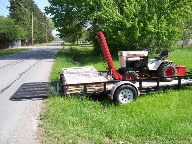

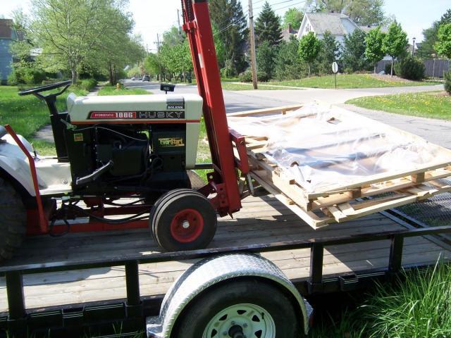

OldBuzzard 186 #30 Posted May 10, 2015 Right then, back to the Operation. When we last posted, the Forklift was still on the trailer as were the makings of the crate. This morning I went out to unload everything and put the crate to a place where I could still get to it later for assembly. Now one thing to consider is that the forklift has very little ground clearance and with the weight box on the back having a long overhang, it doesn't take much to high center it. That means that you have to be a bit creative to get it on and off a trailer. Fortunately my North lot has a drainage ditch that is just perfect. I just back the trailer down the ditch and the tailgate is now level with the road :D I also found that a byproduct of taking the forklift with me when I picked ut the crate was that the crate was resting just fine of the forks. So, unloading the crate was just a matter of lifting the forks so that it cleared the trailer sides, driving off the trailer, and Bob's your Uncle. I'd like to be able to claim that I planned that, but it was just pure happenstance. Pics of how the unloading went. 2 Triumph66 and Alan reacted to this Share this post Link to post Share on other sites

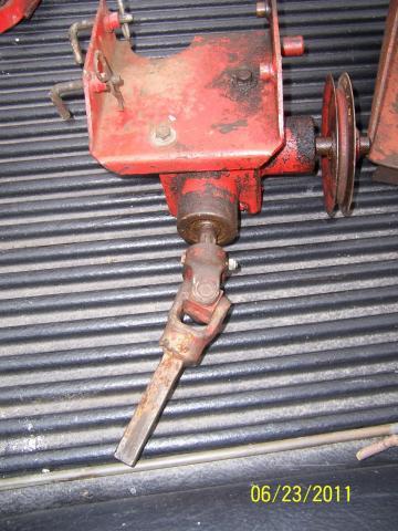

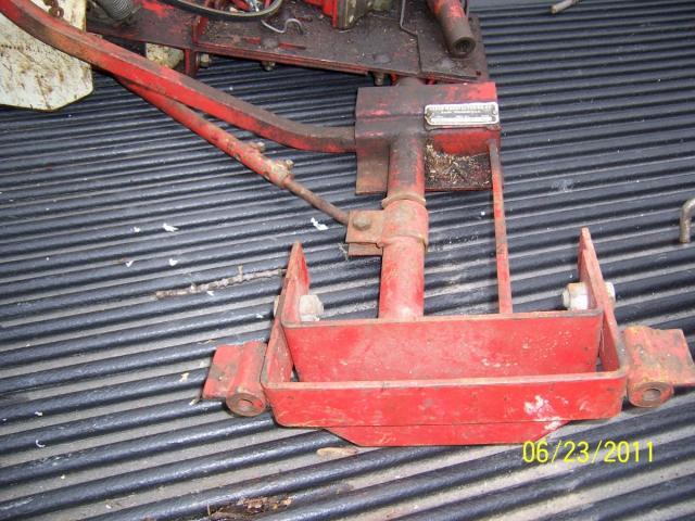

OldBuzzard 186 #37 Posted May 15, 2015 Interesting. The 425 isn't one that you see very often! Don't bet the farm on it, but it just may be possible to make that work on the later tube frames like the 1050, etc. Looking at the manual, which I'll attach, it looks like it may have been a 405A that was modified to fit the QT series. That's not unusual for Haban as they were masters at taking a basic design and modifying it to work across several brands. I found out about that with my first Sickle-Mo. It was a 414 which was for some Wheel Horse models, but by removing the extra bits that Haban attached so that it would hang on the Wheel Horse axle, and having the stub for the prop shaft lengthened a few inches, it was than identical to the 405A. The other extra bit was a 90 deg. gear box that attached under the Wheel Horse chassis to transmit the power to the Sickle-Mo I just have in storage. You can see the extra bits on the front hanger and the gearbox in these two pics: Haban Model 425 Manual Year 1974 for Bolens QT16, QS16 Tractors.pdf 1 Triumph66 reacted to this Share this post Link to post Share on other sites

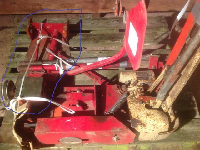

slf-uk 914 #39 Posted May 15, 2015 Andrew, Despite my attachment being in very poor condition it is complete. Very happy to drag it out and take whatever measurements and pictures you need. From memory I think the bits I have marked within the blue border are wrong Iain 1 Triumph66 reacted to this Share this post Link to post Share on other sites

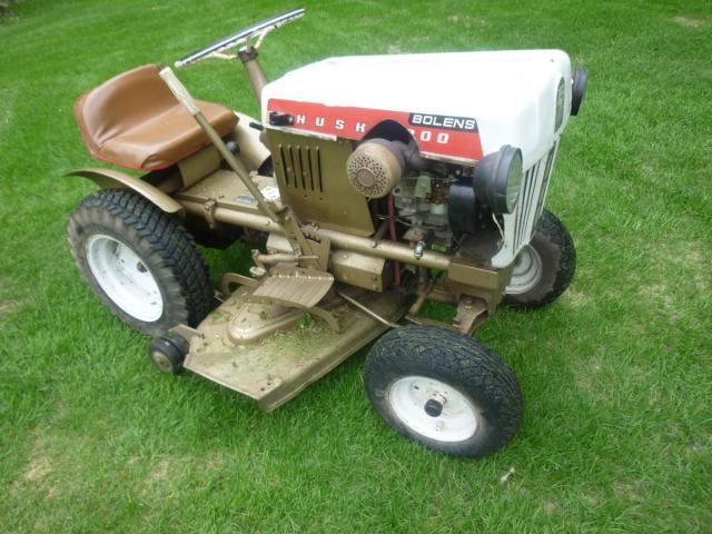

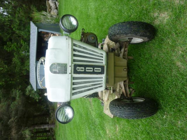

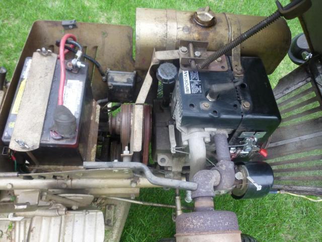

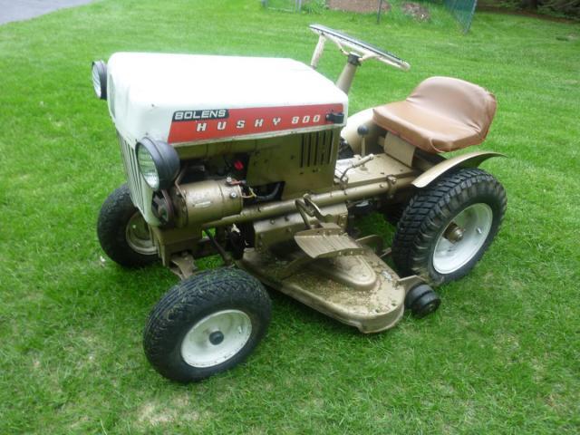

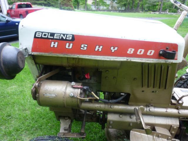

rgrottk 3 #42 Posted May 19, 2015 Okay so as promised, I picked-up the Bolen's 800 (with a fresh Tecumseh 10HP engine) from my niece this past Sunday, starts good, runs good, comes with the deck shown. DROP ME A P.M. IF YOU INTERESTED........ Tractor is as is and as shown in he attached pictures, don't think you'll find a nicer one, great for parades or shows. Pick up only at my home in Brewster. Think $550.00 is a fair price. Thanks Share this post Link to post Share on other sites

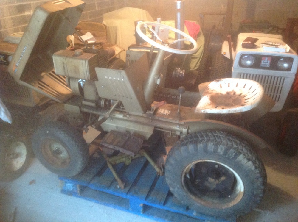

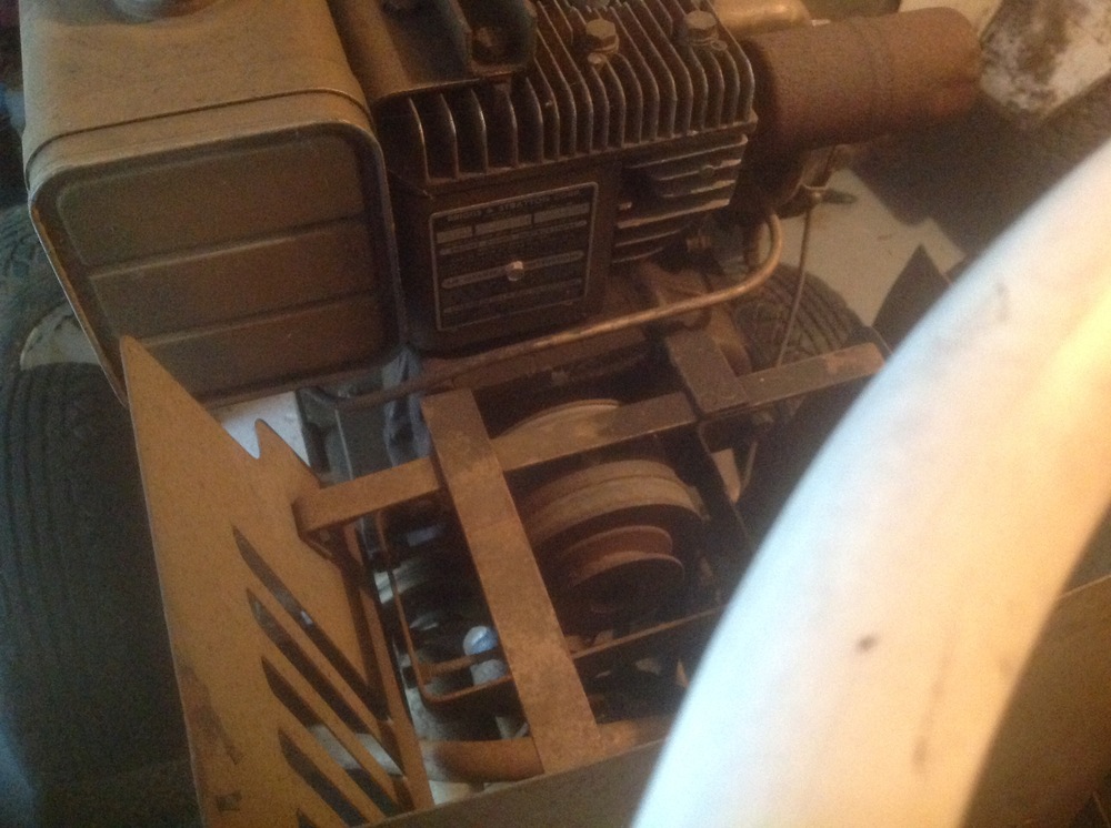

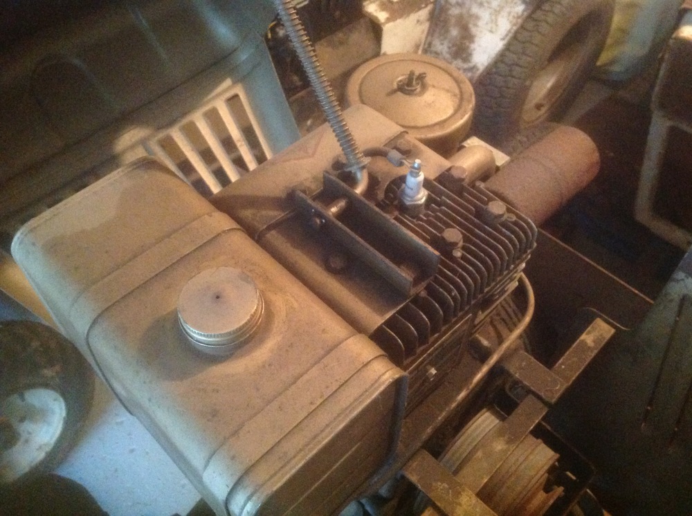

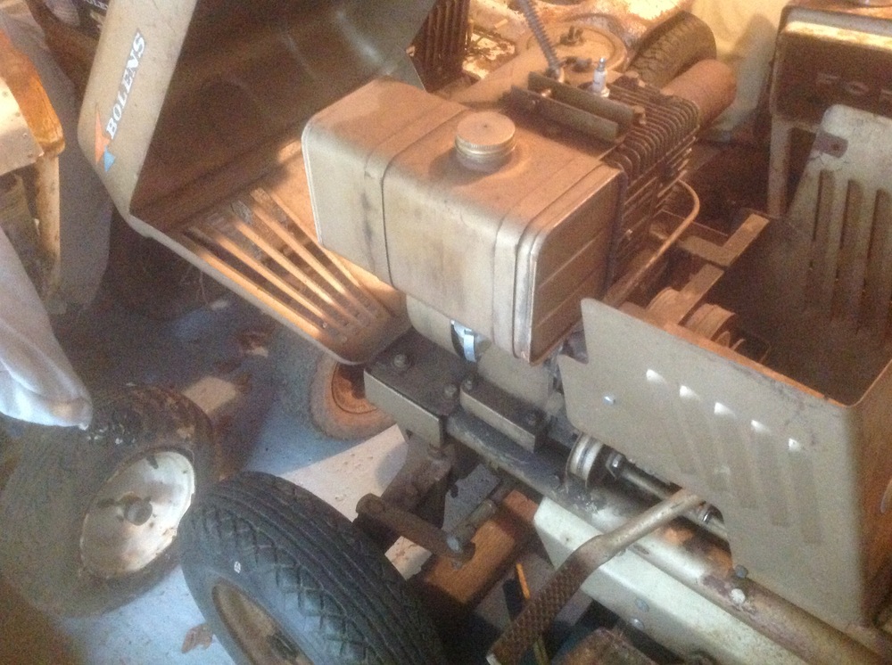

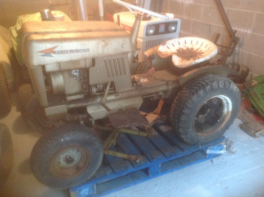

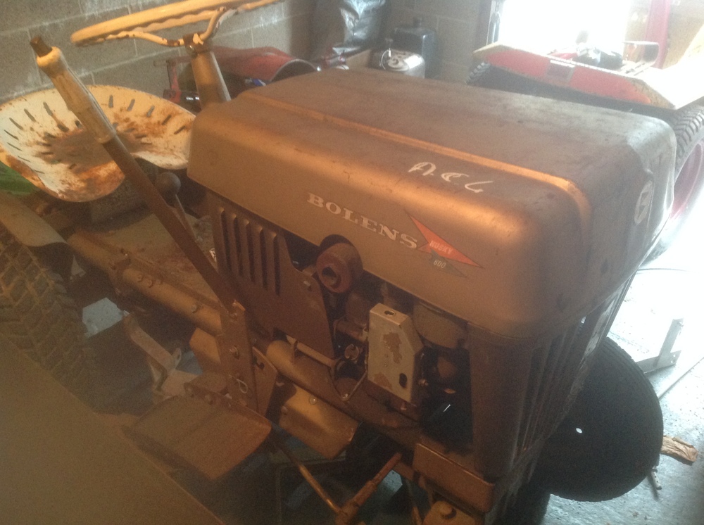

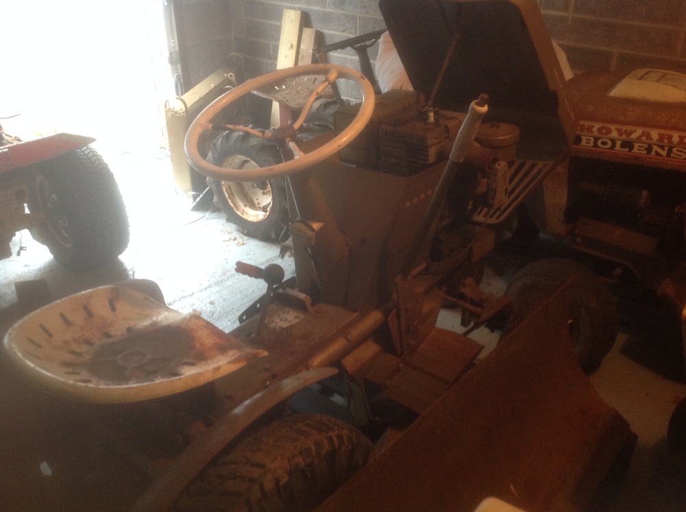

Triumph66 1,256 #43 Posted August 1, 2016 At long last the 600 is now in it new home in the UK along side fellow Bolens and a rogue Ford. It was meant to be delivered on Friday but they couldn't do it then so re arranged it for Monday morning. Whilst waiting for the delivery, I connected up the 1050 air filter unit plus a new air filter element. I turned the fuel tap on and it fired into life after several attempts. It was a wee bit smokey though. I also had a good look through it too. I am always amazed at how well built these little tractors are. The 600 is just as good in the metal as it were and I wiped off accumulated grease and dirt to reveal gleaming paintwork! There was some subtle differences to Chris's 600. The three differences I noticed to date were that mine got a white steering wheel whereas Chris got a black one, the throttle lever was mounted at the front of the steering column not on the side like the other one and the foot pedal on mine is just a simple bar whereas Chris one is a more elborate pedal. I will be interested to see my other 600 to compare the differences. I think someone mentioned that this one from the US is an early example. My thanks to Dave (Old Buzzard) for his time to check it out and collect it and storing it. Also to my consultant, Iain, for his encouragement and knowledge. I contacted several shippers but in the end I went with Chris Sutton's (The Showman) recommendations using DLR Shipping. Is it worth it? Was it worth the angst? To me, yes, as I have picked up a really early example and an original one as well of the 600 with a belly deck and a front plow plus a Brinly sleeve hitch for roughly £150 plus shipping. It was also saved from the scrapie too...... Would I buy another garden tractor again? Yes I would but it got to be in it original paint job with some attachments too and also one that you can't get over here. A Bolens Deluxe Ride a Matic from the late 50s would be an example or a Copar Panzer. For the moment, I won't be buying anything from the US for the moment...... 4 Alan, slf-uk, Stormin and 1 other reacted to this Share this post Link to post Share on other sites
slf-uk 914 #44 Posted August 1, 2016 Andrew, Your 600 is stunning I expect you will have a smile on your face all day. Iain Share this post Link to post Share on other sites
Triumph66 1,256 #45 Posted August 1, 2016 I have taken two short videos of the 600 in its present state. The plan is to give it a really good clean and preserve the patina with a coat of Owatrol and a change of fluids plus replace the belts too. IMG_1424.MOV IMG_1425.MOV Share this post Link to post Share on other sites
OldBuzzard 186 #46 Posted August 1, 2016 Andrew, I've been waiting for you to post that it got there. It's definitely and early example. One easy clue is that the hitch is cast into the rear end and not a bolted on one. 1 Triumph66 reacted to this Share this post Link to post Share on other sites
