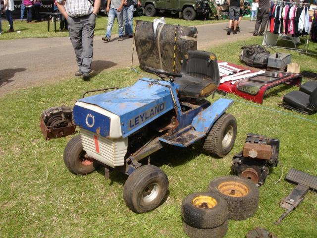

WestwoodGazelle 106 #26 Posted August 16, 2015 Oh I forgot to say! I was at Billing Land Rover show recently and guess what I saw 1 Triumph66 reacted to this Share this post Link to post Share on other sites

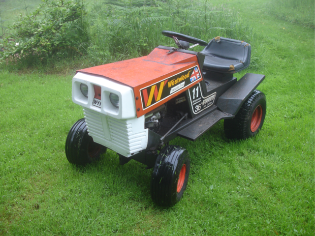

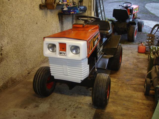

madmatt01 107 #43 Posted June 19, 2016 Rubbish photo alert! I'm useless with models.... what models are these two? The 11hp has the lights on the front. 8hp just the grill front Share this post Link to post Share on other sites
WestwoodGazelle 106 #44 Posted June 19, 2016 38 minutes ago, madmatt01 said: Rubbish photo alert! I'm useless with models.... what models are these two? The 11hp has the lights on the front. 8hp just the grill front Nice! The 11hp looks like a mid-1980s Westwood Gazelle W11, and the 8hp looks like a 1980's "baby" Westwood Gazelle. 1 madmatt01 reacted to this Share this post Link to post Share on other sites
