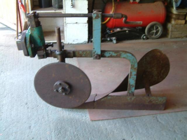

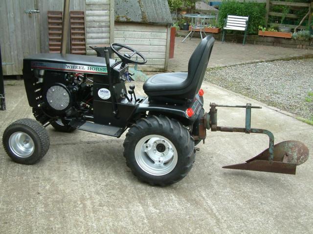

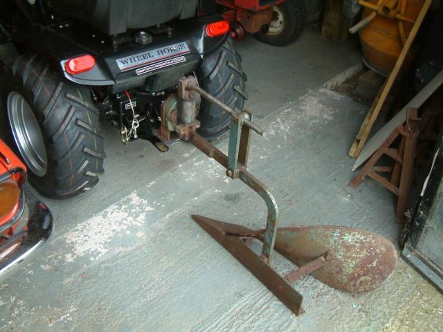

Stormin 4,458 #1 Posted July 21, 2015 At the Newby Hall show, The Showman brought up a plough for me he'd collected from Alans friend John. Last night on reading young Toms post on preparing for Rural Past Times, I was hit by inspiration. Doesn't happen often. Off into the workshop I hastened, and the plough, all in bits, was roughly put together. Today a trip up to the farm for some scrap metal. Back home I set too. The result is below. I could do with some heavier gauge cable for the lift, I haven't got any. Or chain and run it through a custom tube? I have the bits for that. Or make a solid bar mechanism? I have some bits for that. I may also shorten the arm by an inch or two, where it goes down to the shoe. Give a bit more ground clearance when raised. Decisions! Decisions! 4 Alan, Ian, Triumph66 and 1 other reacted to this Share this post Link to post Share on other sites

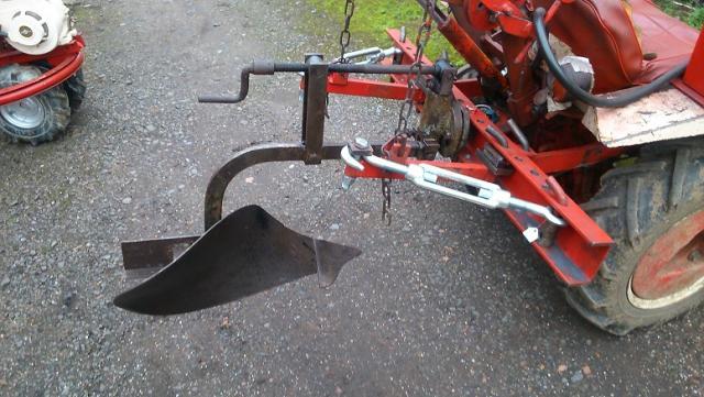

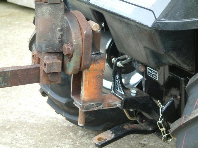

The Fife Plooman 632 #2 Posted July 21, 2015 Hi Stormin Consider making your bracket to fit pin hole on plough bracket this will give you lateral movement in case you hit a stone it allows plough to move left or right please see hitch on my gutbrod hope this helps my check chains will have free play for the same reason George S 3 Stormin, Ian and Triumph66 reacted to this Share this post Link to post Share on other sites
the showman 4,074 #3 Posted July 21, 2015 What did you have to do that for, now I'll have to do something to mine or use yours 😜😜😜 3 Stormin, Triumph66 and Alan reacted to this Share this post Link to post Share on other sites
Stormin 4,458 #4 Posted July 21, 2015 Your plough is the same as mine. I did think of using the pin hole and I understand what you mean. I'll have to have a re-think. How much sideways movement do you have? What did you have to do that for, now I'll have to do something to mine or use yours You've got 17 days. 1 Triumph66 reacted to this Share this post Link to post Share on other sites

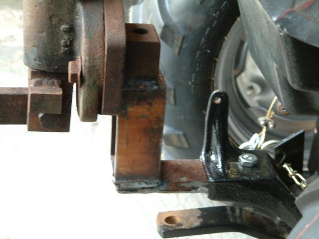

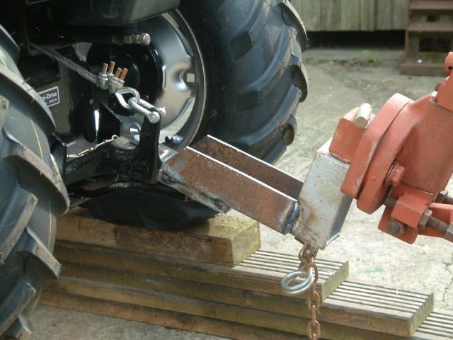

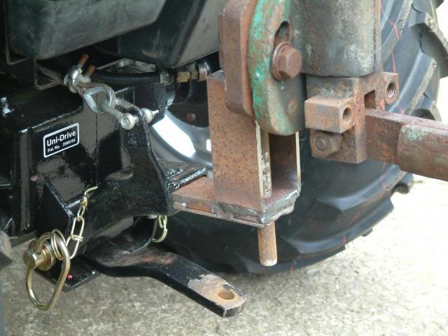

Stormin 4,458 #14 Posted July 22, 2015 Bit of modifying this morning. The square bit the pin goes through was cut off the box section. Box section drilled to take a pin. Long bolt procured from the farm and made into a pin while there. Also came back with some heavy duty electric fence wire that was going spare. Fence wire is now lift cable and it lifts the plough nicely. Well it does after I reset it. I fitted it at first with the lift lever in the up position. There now is a bit of swing in the plough as George suggested. Is there enough or maybe to much? I haven't a clue. Anyway, the plough now fits the tractor. Still bits to do yet. 4 S1g, Triumph66, Alan and 1 other reacted to this Share this post Link to post Share on other sites
the showman 4,074 #15 Posted July 22, 2015 That looks good Norm, will you need any weight on the front when you lift the plough Share this post Link to post Share on other sites
Stormin 4,458 #16 Posted July 22, 2015 I'll find out at it's first trial. Share this post Link to post Share on other sites
The Fife Plooman 632 #17 Posted July 23, 2015 Hi Stormin The two threaded bolts should be put in adjust them to give you some free play believe it or not half inch of play can make a difference try it. best of luck with your ploughing George S Share this post Link to post Share on other sites
Stormin 4,458 #18 Posted July 23, 2015 Thanks George. You've just answered something I've been wondering. I wasn't sure if that shaft should swivel or not. It's seized solid. The bolts had been screwed right in, so it couldn't move anyway. Going to take some freeing, methinks. Share this post Link to post Share on other sites
The Fife Plooman 632 #19 Posted July 23, 2015 Hi Stormin Get it free before you start ploughing it will make all the difference it is called trial trial trial have been there Share this post Link to post Share on other sites
Stormin 4,458 #20 Posted July 23, 2015 Managed to get it free. Tightening and slackening the adjusting bolts, plenty of penetrating oil, banging it on the floor and patience. Took about an hour. Painting in progress now. 5 Triumph66, Alan, nigel and 2 others reacted to this Share this post Link to post Share on other sites

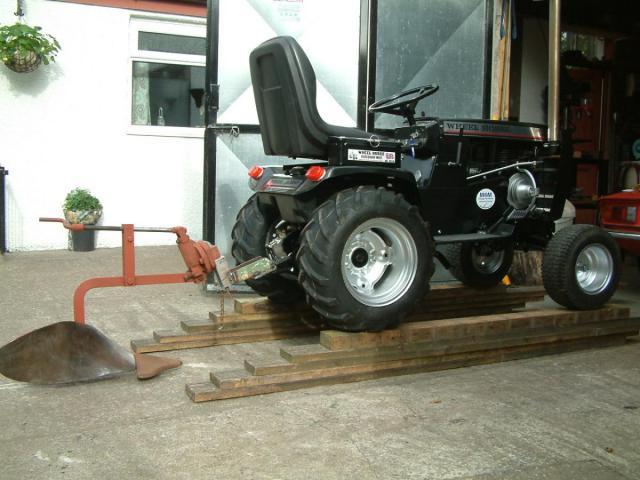

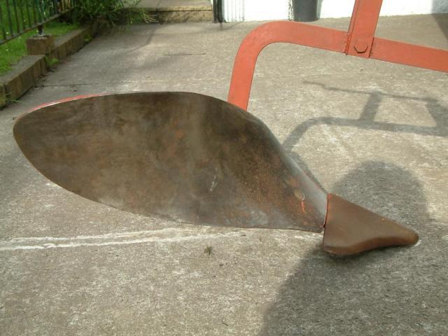

Stormin 4,458 #24 Posted July 24, 2015 I'm posting here George, rather than a PM, as your advice and comments may help others. Not just me. I've re-made the hitch, as ground clearance when traveling was very little. The next photo is it on 7-1/2" boards with plough fully down. Plough is not touching the ground. Front tip is 1-1/4" off the ground and rear is 1". I cannot get the plough level as no more adjustment. This last photo is of plough in position as if to start ploughing. I'm guessing here, that from my measurements, the plough will drag itself down to 6". Distance from share to inside of rear wheel is 6-1/2 inch. From your figures, guessing again, depth would be approx. 4". Again, your comments, suggestions and advice greatly appreciated. 5 Triumph66, meadowfield, the showman and 2 others reacted to this Share this post Link to post Share on other sites
Stormin 4,458 #25 Posted July 24, 2015 I know one thing, it's flamin' 'eavy. I'll have to get the dumb bells out or work out some spring assistance to lift it. May have to reverse to get it out of the ground. Share this post Link to post Share on other sites
