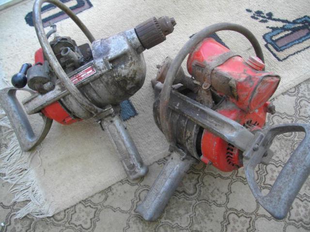

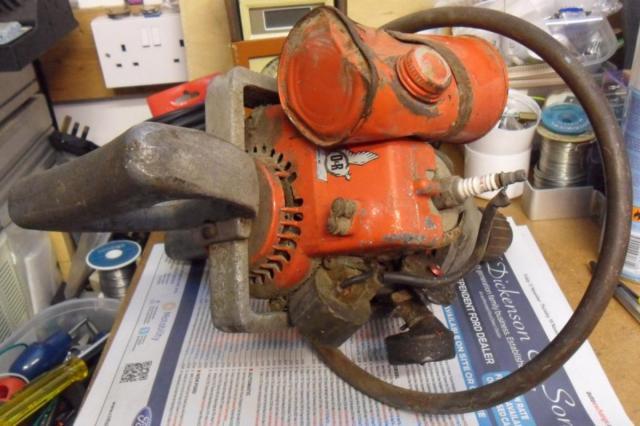

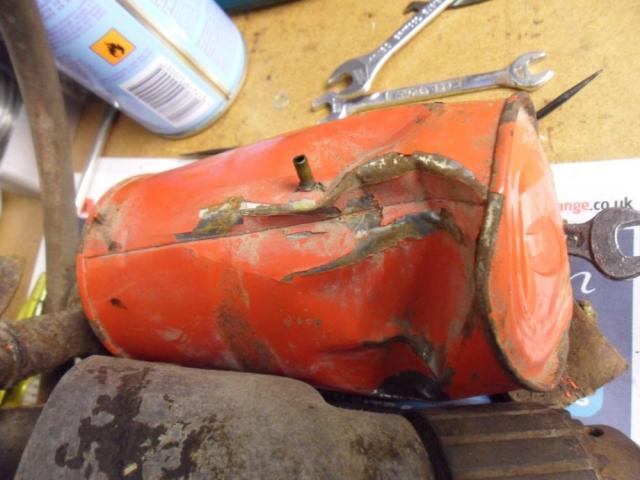

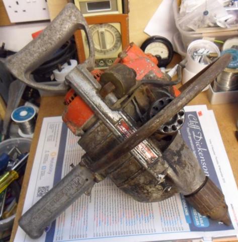

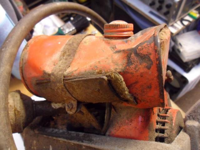

factory 487 #1 Posted November 17, 2015 A rare find in the UK, a pair of Petro Chug-A-Drills, I was going to put these in the other Chug-A-Drill thread but they are not yet restored. Unfortunately there is only one tank between the two & it's badly crushed! No other damage though and both are free to turn over. David 3 HeadExam, pmackellow and Wallfish reacted to this Share this post Link to post Share on other sites

Wallfish 718 #4 Posted November 17, 2015 VERY NICE!!!!!! And one of the coolest looking O&R tools out there. They are very rare and difficult to find over here too. I got lucky and bought one from Webhead and have only seen one other for sale so far. Appears those two should clean up real nice. Share this post Link to post Share on other sites
Ian 2,417 #5 Posted November 18, 2015 A couple of nice finds there It's a shame about the fuel tank, I'd be inclined to cut it in half, beat the two halfs back into shape and weld it back together.. It's worth a go and you have nowt to loose Share this post Link to post Share on other sites

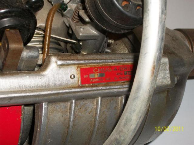

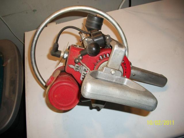

factory 487 #6 Posted November 18, 2015 (edited) VERY NICE!!!!!! And one of the coolest looking O&R tools out there. They are very rare and difficult to find over here too. I got lucky and bought one from Webhead and have only seen one other for sale so far. Appears those two should clean up real nice. They do seem quite rare, I had also only seem one other sell in the US and another that sold in South Africa in 2013 here; http://www.bidorbuy.co.za/item/89694683/1962_PETROL_POWERED_DRILLING_MACHINE_Chug_A_Drill.html I did a google search for "Chug-A-Drill" this evening, there were only 8 results, including one that didn't sell for $1000!!! Also found was a new looking 1HP Almico branded one (still has Petro cast into the handle), someone definitely got a bargain; http://www.ebay.com/itm/Gasoline-powered-Drill-/221729491998 its so nice I've added some pictures of it before they disappear. . Lastly an article from 1962 in Desert Magazine, on page 6 from here http://dezertmagazine.com/mine/1962DM07/files/196207-desertmagazine-1962-july.pdf A couple of nice finds there It's a shame about the fuel tank, I'd be inclined to cut it in half, beat the two halfs back into shape and weld it back together.. It's worth a go and you have nowt to loose Sounds like a good idea, it will probably be tin though, it may be possible to solder on a brass band to overlap the join. David Edited November 18, 2015 by factory Share this post Link to post Share on other sites
Wallfish 718 #7 Posted November 18, 2015 Over here we can get can openers which cut the bead around the lid and not the lid. Imagine you guys can get them too. After repairs you can just solder around the edge and file it smooth. Once painted no one would ever notice. You're right about someone getting that deal. If it was listed under Ohlsson & Rice it would've sold for $350+ 1 Stormin reacted to this Share this post Link to post Share on other sites

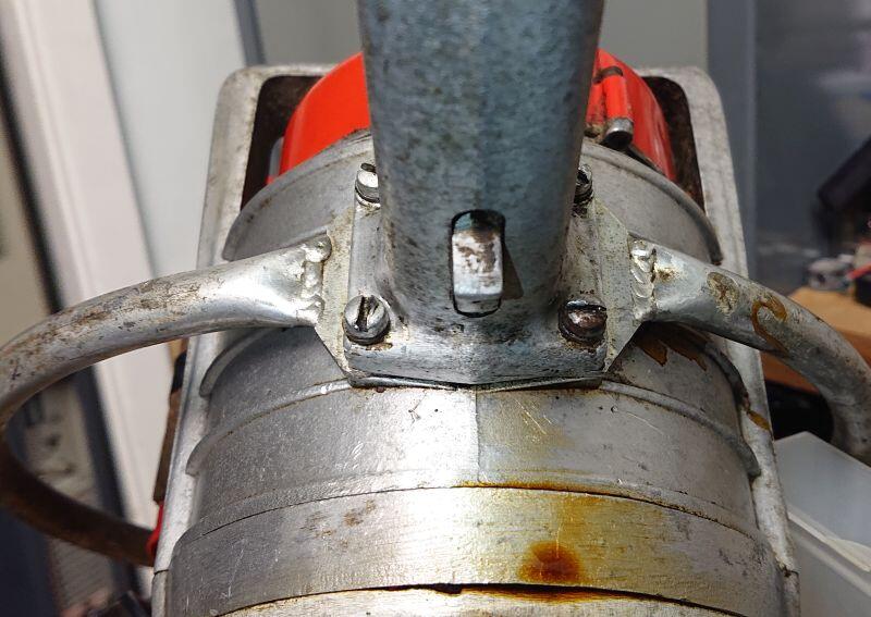

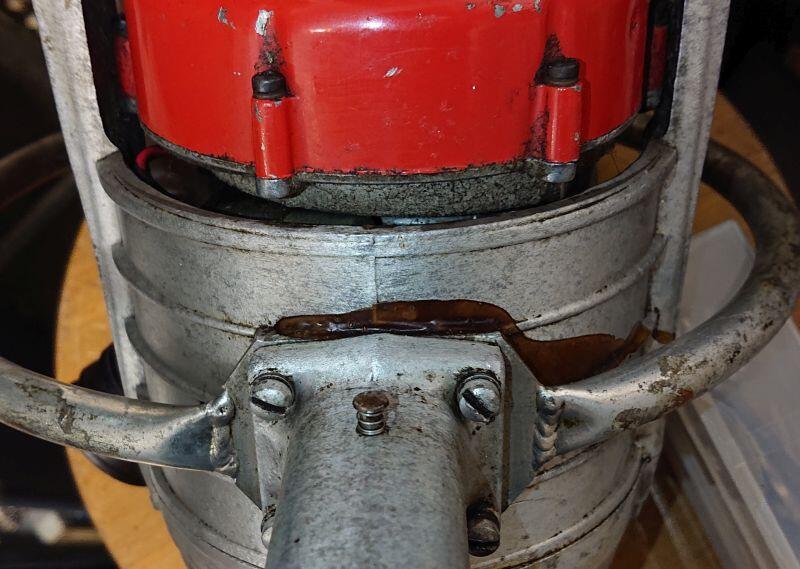

factory 487 #14 Posted April 2, 2021 The handle is almost a complete circle, it's welded to a flat section underneath, shouldn't be too hard for someone to recreate. David Share this post Link to post Share on other sites

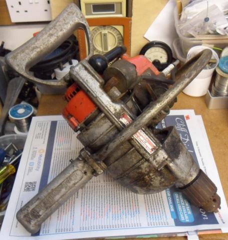

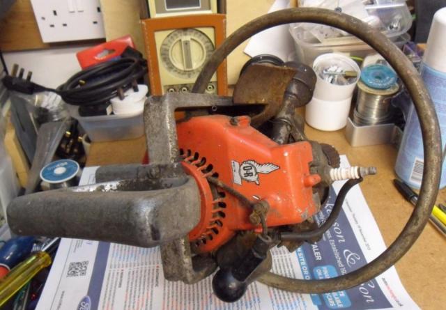

factory 487 #15 Posted April 2, 2021 A couple of better pictures from underneath, the outside diameter of this handle is approx 10" , approx as it's not quite round. On 4/1/2021 at 2:56 AM, CNew said: The tank is pretty dinged up and it’s been used over it’s life. Your tank is pretty good compared with one further up this page, even has an original decal. David Share this post Link to post Share on other sites
CNew 408 #16 Posted April 2, 2021 David- thank you for the photos - those are very helpful. Yes, I was very glad to see the decal still on the tank. It’ll be fun cleaning this one up! Share this post Link to post Share on other sites

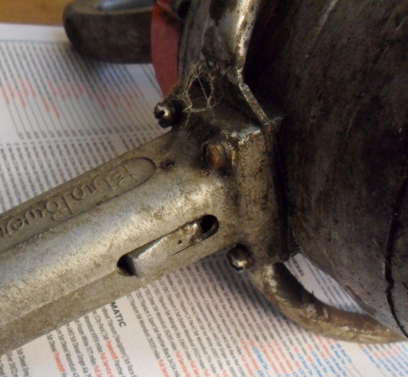

factory 487 #17 Posted April 5, 2021 Some more pictures of the handle, outside diameter is approx 10", the height from the flat section is approx 9½" and the tube is approx ½" diameter. The flat section is approx 1, 15/16" by 1, 11/16" with a hole to suit the switch fitted, I suspect my switch has been replaced judging by how chewed up the nut is. David 2 pmackellow and CNew reacted to this Share this post Link to post Share on other sites
CNew 408 #18 Posted April 6, 2021 David, This is fantastic! Thank you for taking the time to take all the detailed measurements and photos of the handle. Share this post Link to post Share on other sites
