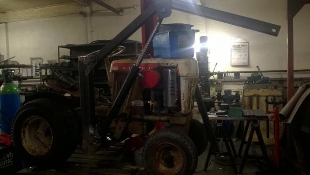

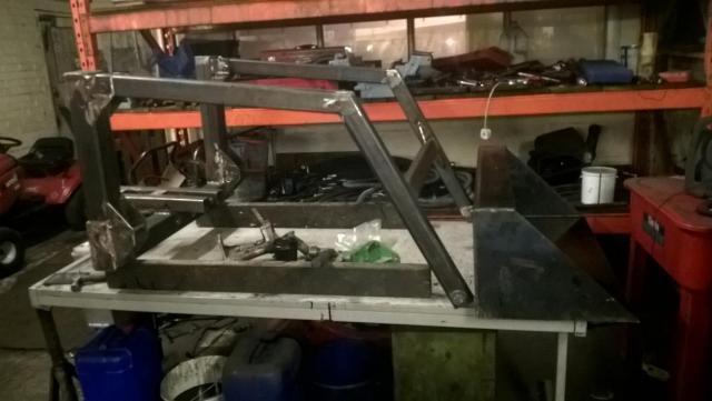

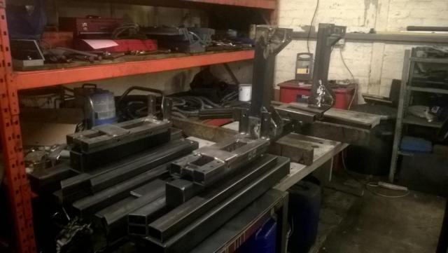

adrian 29 #1 Posted March 9, 2016 loaders in unit been built tanks been tested arms 7 C-101plowerpower, ranger, wurzel and 4 others reacted to this Share this post Link to post Share on other sites

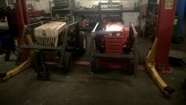

adrian 29 #2 Posted March 9, 2016 (edited) and before any of you talking crap or saying theres only two loaders there ,loaders have two tanks you have 10 tanks in pick up awaiting pressure testing that's five loaders then the kits already made up on the table awaiting assembly which is 3 of them then mine on my tractor and one on bolens plus last one on floor going to customer in Shropshire. and no none of it is stolen it all belongs to me and its not a shed either there at home this is in my unit, Edited March 9, 2016 by adrian 2 wurzel and expeatfarmer reacted to this Share this post Link to post Share on other sites

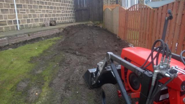

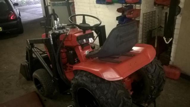

C-101plowerpower 548 #11 Posted March 9, 2016 look REALLY WELL build, but please put a flywheel screen on that tractor 1 adrian reacted to this Share this post Link to post Share on other sites
adrian 29 #12 Posted March 9, 2016 i would plowerpower but i cant find one to fit to it at the minute besides this engine maybe coming out yet. i broke the screen while rebuilding the engine little did i know at that point there hard to replace. Share this post Link to post Share on other sites

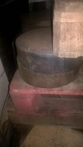

adrian 29 #17 Posted March 9, 2016 everything is fine mate i took a little critism to heart but not been called a theif and a scammer that pissed me off , i make weights in to sizes you have 15kg singles or 35kg singles ill see if it will allow me to post pics mate there are a small set of 4 15kgs on ebay now they will be drilled and painted ready can make heavier ones if required these are 35kgs each sorry the others are 17kgs each Share this post Link to post Share on other sites
Stormin 4,458 #18 Posted March 9, 2016 I think 35kg/77lb would be more than enough for me. I'd have to start doing press ups. What weight are standard Wheel Horse weights? Anyone know? 1 adrian reacted to this Share this post Link to post Share on other sites
adrian 29 #19 Posted March 9, 2016 if w find out the real weight i can mill them down to that weight at the minute i made them to fit inside the wheels im using 35kg on my tractor Share this post Link to post Share on other sites

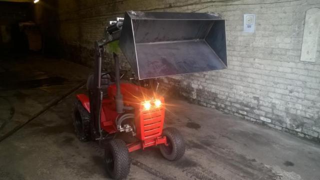

Chris 642 #20 Posted March 9, 2016 How wide is the bucket please? I have a bolens loader which is missing a bucket Share this post Link to post Share on other sites
adrian 29 #21 Posted March 9, 2016 i can make what ever size bucket you require however on mine and the customers bolens its 3ft wide 1foot tall and has a 3inch top lip preventing fallout of materials buckets are made with 5mm sheet steel folded twice and cnc lazer cut end caps there 100 plus vat unpainted Share this post Link to post Share on other sites
