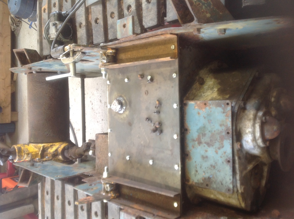

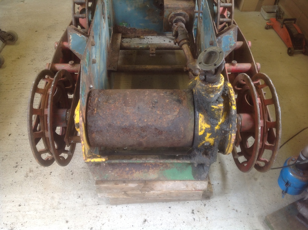

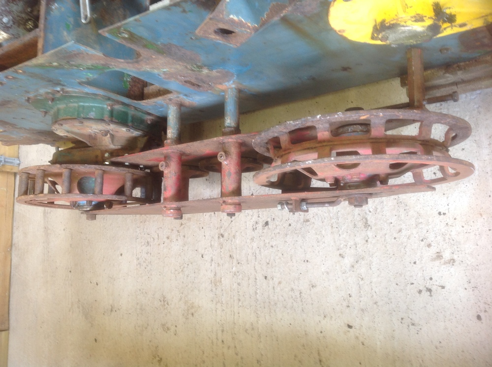

Rocboni 257 #27 Posted July 31, 2016 Having wire brushed off the flaking paint and rust and chipping off all the hard sand/grease I could reassemble. All seal and bearings appear to be in good condition which is good as aim is to spend as little as possible. I Spent ages freeing up all the rollers on the drive wheels, all I could do is hit them with a hammer and twist with a set of vice grips the ones which have been nearest the ground are quite bad but will do. I've still got the other wheel to do! At least it is getting to the point where I can touch it without bits falling off! 3 Alan, hpearce and Stormin reacted to this Share this post Link to post Share on other sites

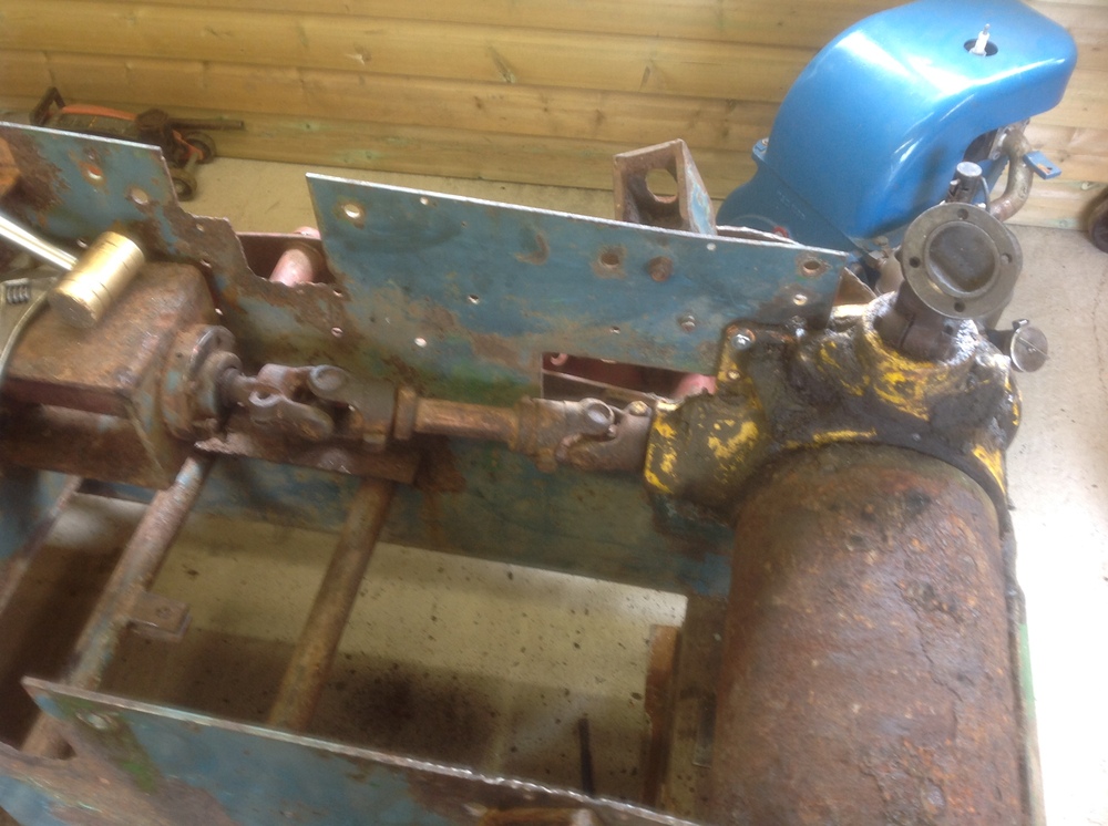

Rocboni 257 #28 Posted August 1, 2016 Second side cleaned and reassembled. I have refitted the belt drive roller and gearbox, weighs an absolute ton, the engine crane was priceless for this job. I do not like to think about how much this machine weighs all together! Not sure why gearbox is yellow, must have stole it from Jonathan's skimmer! 1 Stormin reacted to this Share this post Link to post Share on other sites

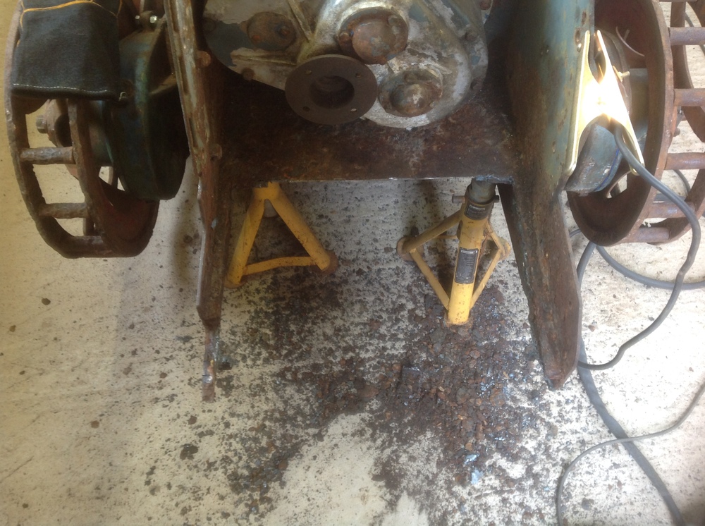

Rocboni 257 #29 Posted August 1, 2016 Oh no, wheres the floor gone! 1 nigel reacted to this Share this post Link to post Share on other sites

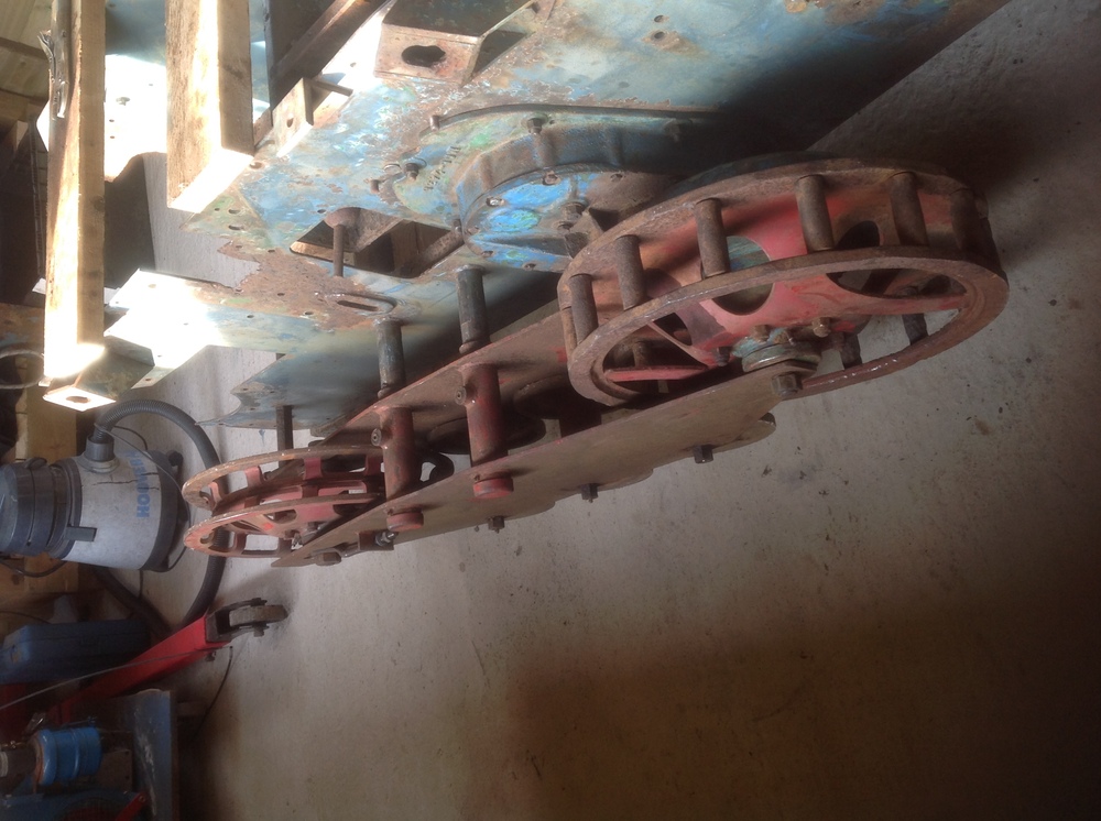

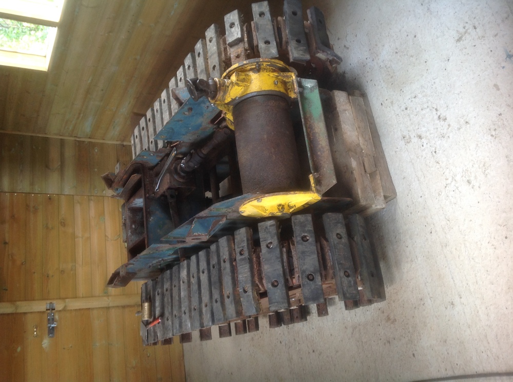

Rocboni 257 #32 Posted August 2, 2016 Tracks back on, one track snapped as I was freeing them up, hopefully no more will snap when driving as bolts are in unknown condition as the are covered with the rubber pads. Off to get some steel today so I can move forward with engine and brakes. 1 Triumph66 reacted to this Share this post Link to post Share on other sites

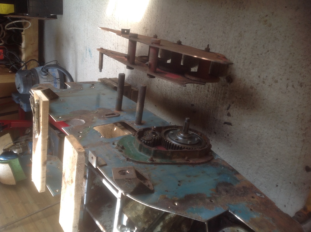

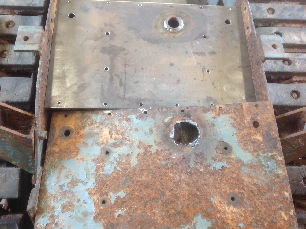

Rocboni 257 #33 Posted August 2, 2016 New top plate fabricated Share this post Link to post Share on other sites

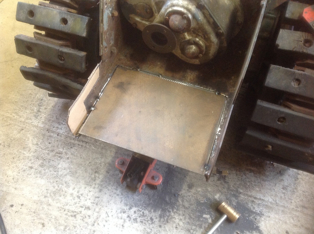

Rocboni 257 #34 Posted August 2, 2016 New floor pieced in, tacked ready to try engine on. Someone has also cut away the side for the kohler oil drain pipe, I think I'll have to replace the cardboard with steel though..... 5 nigel, Triumph66, Stormin and 2 others reacted to this Share this post Link to post Share on other sites

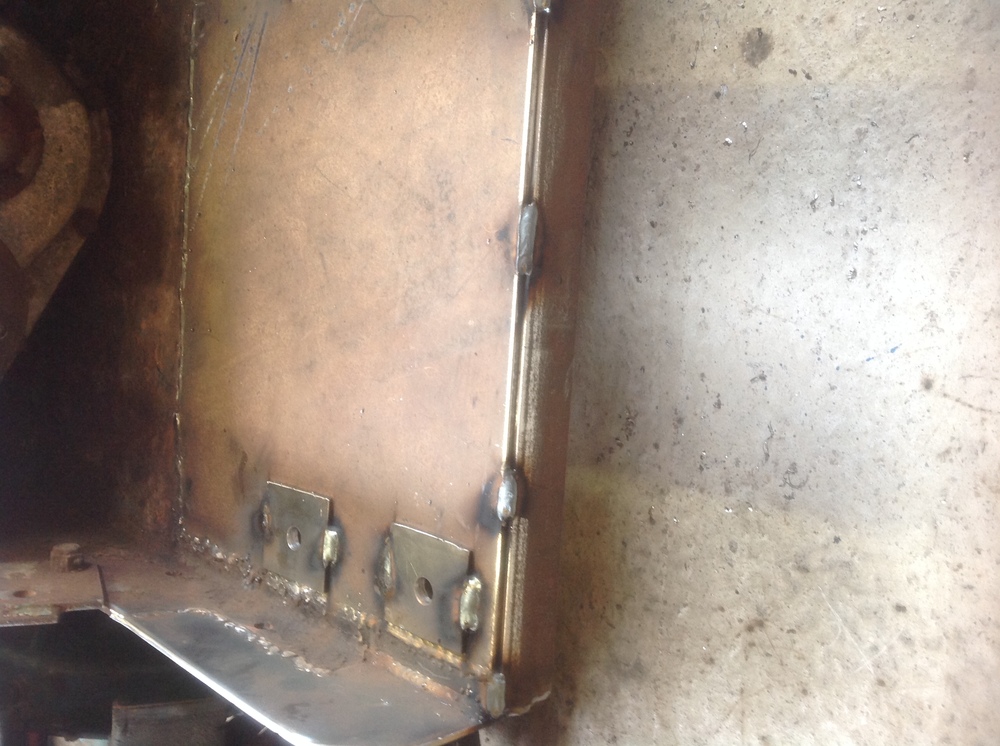

Rocboni 257 #40 Posted August 3, 2016 An early start this morning seen me trial fit the engine, and decide on packer thickness this allowed me to fully weld in the floor, also cut side and patched that in aswell. Just waiting on a package today so I can rebuild Clutch and fit engine permanently. 2 HeadExam and Stormin reacted to this Share this post Link to post Share on other sites

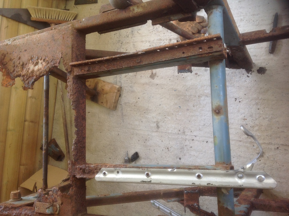

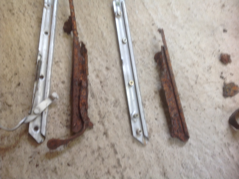

Rocboni 257 #47 Posted August 3, 2016 What's left of the old seat runners.....the NOS ones still fits on the rails! 1 Stormin reacted to this Share this post Link to post Share on other sites

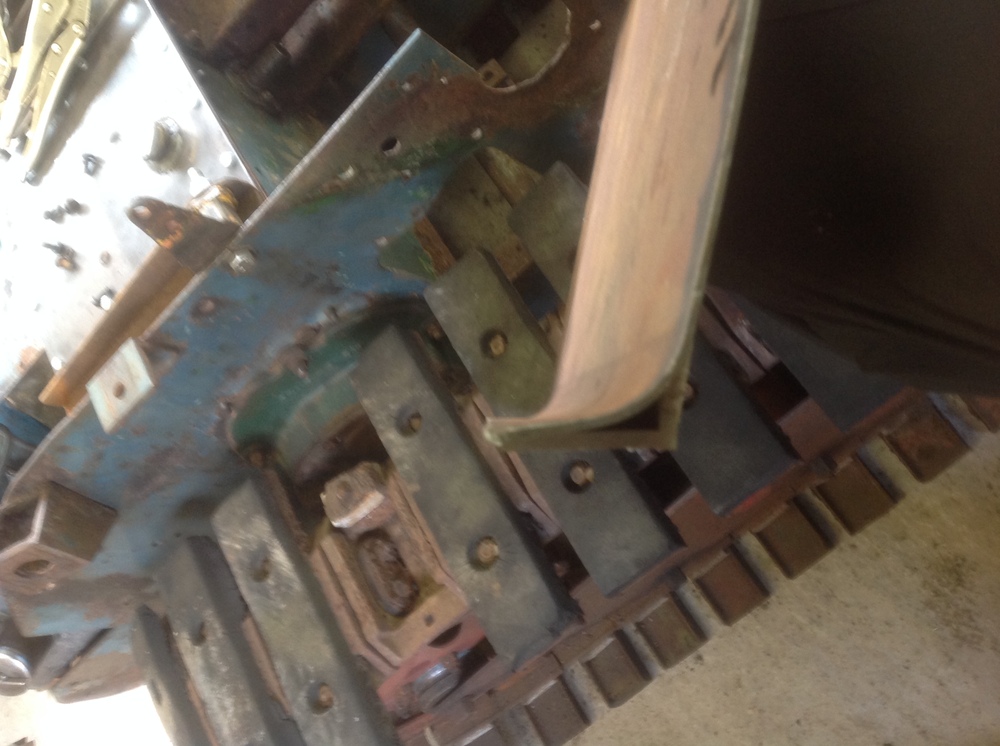

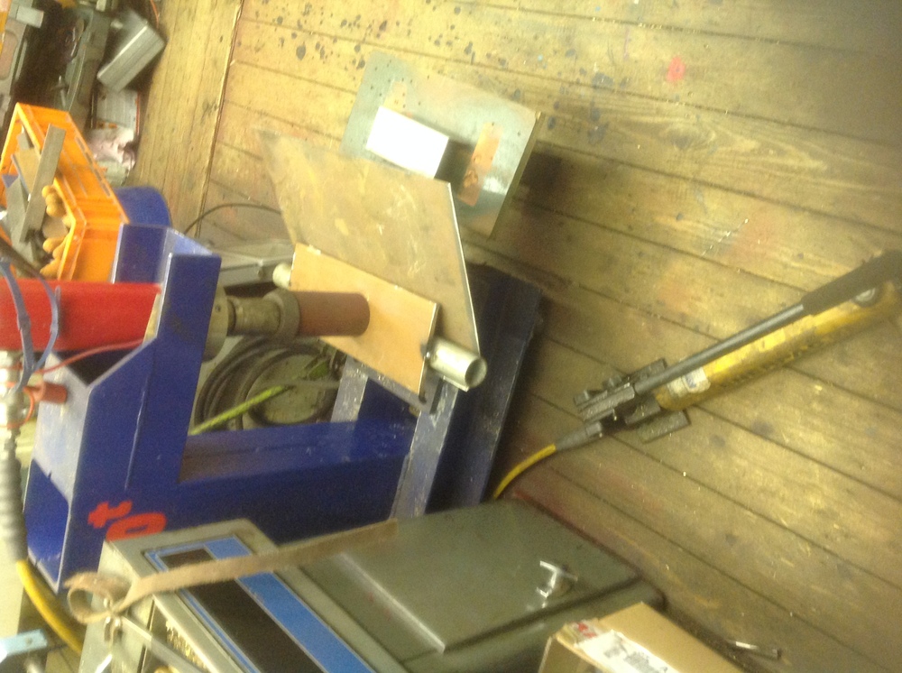

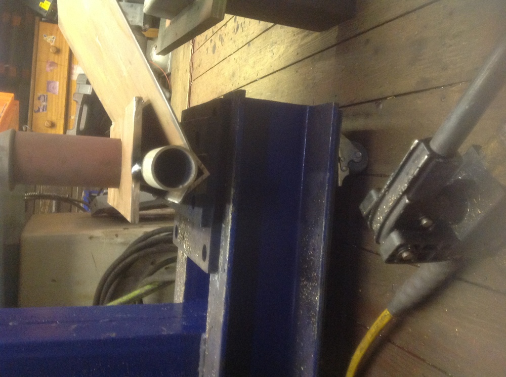

Rocboni 257 #48 Posted August 3, 2016 I needed to put a curve on the back of a 3mm sheet 20inches long, after a bit of thought in the press and 10Tones or so, I had a nice curve! 4 Stormin, nigel, HeadExam and 1 other reacted to this Share this post Link to post Share on other sites

Rocboni 257 #50 Posted August 3, 2016 That press has been the best thing I've made. Wish I could find a seat, probably going to have to make one as well. Share this post Link to post Share on other sites
