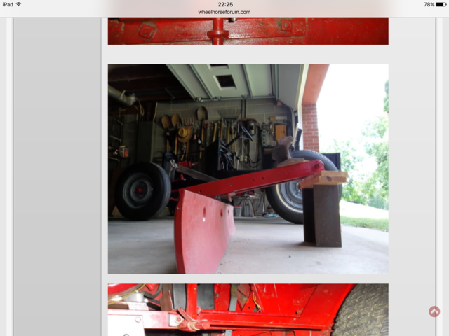

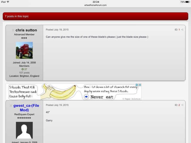

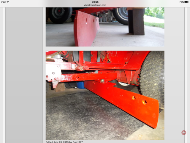

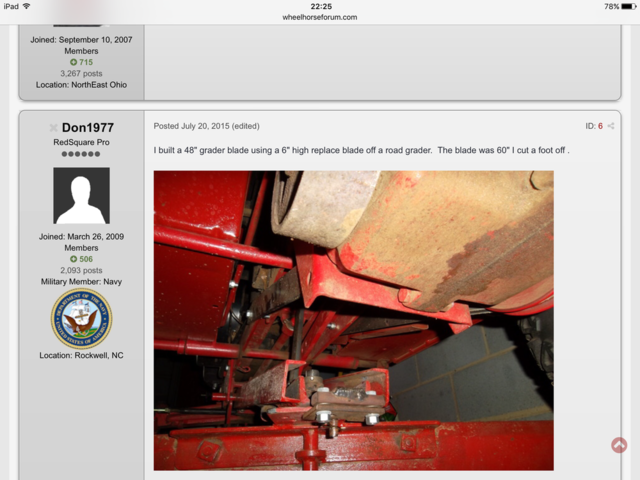

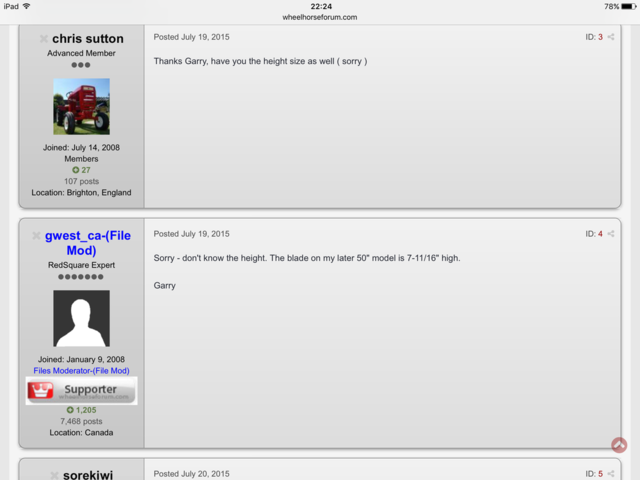

the showman 4,074 #3 Posted August 6, 2016 Hope to make something similar to this. 2 Triumph66 and Ian reacted to this Share this post Link to post Share on other sites
Ian 2,417 #4 Posted August 6, 2016 That will be a cool project Chris... Your soon be down grading the beach 1 HeadExam reacted to this Share this post Link to post Share on other sites
C-101plowerpower 548 #5 Posted August 6, 2016 http://www.wheelhorseforum.com/topic/64592-custom-graderbelly-blade/ Share this post Link to post Share on other sites
the showman 4,074 #6 Posted August 7, 2016 Brilliant idea using an old dozer blade, I've got a spare frame somewhere in the woodshed just need the blade Share this post Link to post Share on other sites

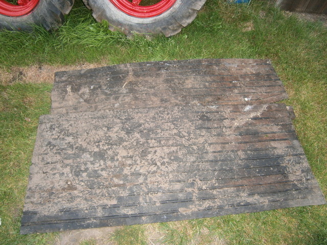

pmackellow 2,738 #10 Posted August 8, 2016 This is the rubber matting I was talking about Chris, its 50 inches long so should do the trick... 2 Triumph66 and the showman reacted to this Share this post Link to post Share on other sites
the showman 4,074 #11 Posted August 8, 2016 Looks just the job Paul, thanks 1 pmackellow reacted to this Share this post Link to post Share on other sites

the showman 4,074 #24 Posted August 9, 2016 Rubber mat now on site thanks to Paul and Wendy. Share this post Link to post Share on other sites
pmackellow 2,738 #25 Posted August 9, 2016 14 minutes ago, the showman said: Rubber mat now on site thanks to Paul and Wendy. Glad to be of service Mr Showman Share this post Link to post Share on other sites
