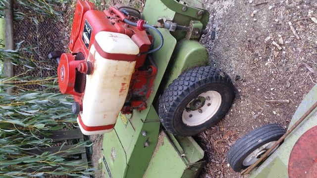

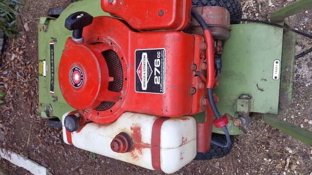

Rod 7 #4 Posted October 4, 2016 Couple of pics will do a few more tomorrow think i found serial numbers but hard to see got to wait for my son to get home from work so can use his far younger eyes 🤓 1 Triumph66 reacted to this Share this post Link to post Share on other sites
Rod 7 #5 Posted October 4, 2016 Just got these numbers from outer casing above spark plug are they useful.Model...70702. Type...213501. Code...84030129 cant work out if the year is in there Share this post Link to post Share on other sites
Anglo Traction 1,018 #6 Posted October 4, 2016 14 minutes ago, Rod said: Just got these numbers from outer casing above spark plug are they useful.Model...70702. Type...213501. Code...84030129 cant work out if the year is in there Yep!,there should be a 1 at the start, otherwise correct. Your engine is a replacement and the date is 1984. March 1st . Not a great many changes from the original engine spec. The Engine Manuals for it are (hopefully) available from this LINK . Machine look's in very good condition. Share this post Link to post Share on other sites

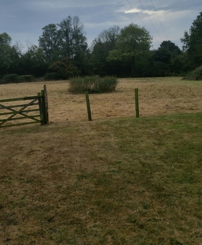

Rod 7 #13 Posted October 9, 2016 Got the osprey to keep running long enough to finish the field its the one over the fence about 2/3rd acre in 3hrs no sweat for the osprey,I left the patch in the middle to show how it all looked before.I do beleive this machine is unstoppable so pleased with it. 3 Alan, Stormin and ranger reacted to this Share this post Link to post Share on other sites

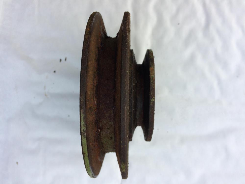

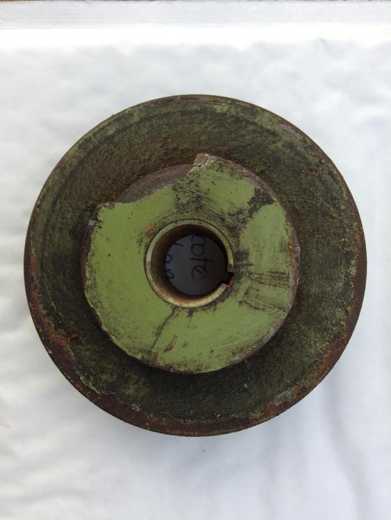

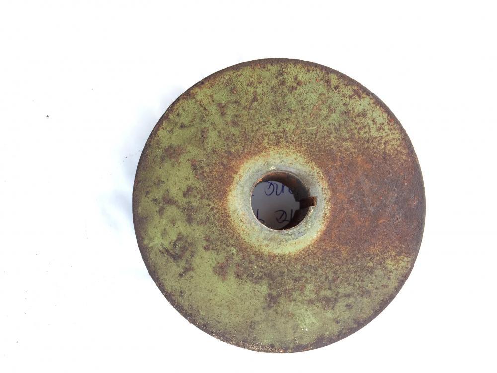

Stubmiester 0 #18 Posted March 15, 2017 Nigel It would be outstanding if you did. Here are the pics-let me know. Stuart Share this post Link to post Share on other sites
nigel 1,881 #19 Posted March 17, 2017 Can you tell me the width across the big pully edge to edge then the same with the small one, I will have a look then, it's not the one I thought it would be, but I do have quite a few pulleys kicking around Share this post Link to post Share on other sites
Stubmiester 0 #20 Posted March 17, 2017 Yes of course; Here are the details; Large Pulley OD 107.5mm V belt is 16mm and has the reference Speedonna D1440 (B55) 46 "Square sign" Small Pulley OD 62mm V belt 9mm Overall thickness of split pulley 37mm Centre hole 22mm Let me know if there is anything else. Best Stuart Share this post Link to post Share on other sites
