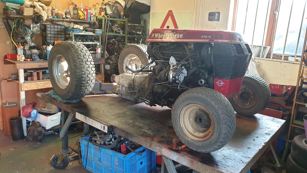

Ian 2,417 #1 Posted January 20, 2018 We all have a "must build" project in mind, and this is mine.. Over the years I have restored WH's Built things that go on them such as a snowplow and harrow... Added a couple of extra wheels - The 6x6.. And even made a fast fun machine - Project Why Not.. Wheel-Vo is the silly/stupid one As you all know I paid The Showman a visit the other day and came back with a car load of WH.. A 312-8 although with no engine and trans it's more like a 300-0 Here it is back in the workshop thrown in a rather neat pile The plan? The title should of given you a clue, I'm on the look-out for a cheap Volvo that will give up a 2.3 turbo engine, gearbox, rear axle and maybe a few other parts, then sell on the rest to get a few £££'s back.. Of course a standard WH chassis won't be suitable so I'm going to have to build one.. A lot of work ahead but I can/am collect parts while I'm finishing Project MadTrax.. There won't be any real updates for a while but I can keep you updated as to how the parts collecting is going.. And of course... Video's 4 HeadExam, the showman, meadowfield and 1 other reacted to this Share this post Link to post Share on other sites

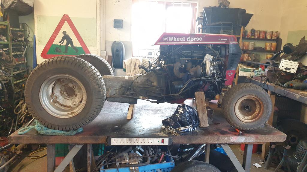

Ian 2,417 #8 Posted June 6, 2018 Morning all, well Project Wheel-Vo has taken a big step forward this week as the new running gear has been found... You might say it's been safely kept in this big metal box A "can't quite get he's head around my thinking" Nigel gives the Volvo 940 2.3 SE Turbo a That's quite a big 4 pot! A Volvo B230FK if your into engine numbers. Here's the important bit... The turbo Size wise a manual gearbox would be smaller, but an auto does make life easier... Also I kinda like the idea of being able to keep both hands on the steering wheel during launch as well I dug out the WH 312-8 bonnet/hood to have a look size wise...... This pic makes me look totally nuts for even thinking of this project! However, lift the bonnet/hood up and plonk the said WH item on and suddenly the engine does not look that big.. A certain amount of errr... "Scaling up" is going to be needed on the WH panels but not as much as I had 1st thought as the actual auto box isn't as long as I had 1st thought. Of course I have to fit a radiator and intercooler under the hood as well. I will be using the Volvo rear axle, they are known to be strong and (quite handy for me) easy to narrow As of yesterday here's where I have got to.. Just need to disconnect the shifter linkage, speedo cable (I think the speedo is driven from the 'box), unplug any electrical bits, unbolt the propshaft, unbolt the 'box crossmember and then the engine and trans can be removed as one.. Glad I have the use of a forklift No idea why the forum software want to put this duplicate pic in at the end, but I can't seem to get rid of it! 3 1 nigel, Cub Cadet, Alan and 1 other reacted to this Share this post Link to post Share on other sites

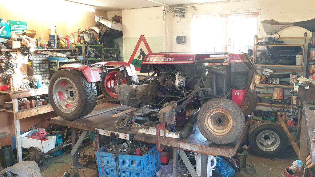

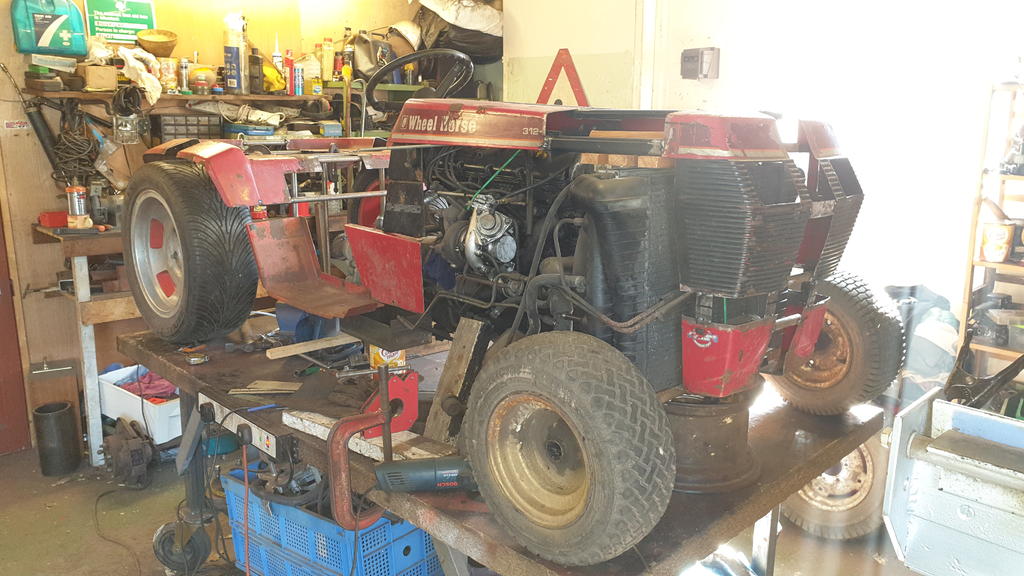

Ian 2,417 #12 Posted June 13, 2018 On 06/06/2018 at 10:16 AM, nigel said: Your barmy mate, as mad as a box of frogs, absolute nutter 🙄🧐 Thanks mate, good of you to notice On 06/06/2018 at 10:37 AM, pmackellow said: Madder than Mad Jack McMad, winner of last years Mr Mad competition! We like mad, go for it Ian ! Hi Paul, mad it certainy will be On 06/06/2018 at 10:39 AM, Stormin said: No! Just inventive. Loopy but inventive. Loopy and inventive... Sounds like the perfect combo to me It's been a very busy and heavy week, but when needs must.. The Volvo engine bay now looks like this.. Engine out.. A big thank you to Rob (far right) who has put a lot of time in over the past 7+ days to help me get this stage done. A thank you to Matt (far left) who did the very careful forklift driving to pull the engine and trans out.. And a thank you to Nigel (middle) for offering advice, getting in the way sometimes, and for sitting on the forklift to make it look like he did the driving Back in the workshop with a few parts plonked in place.. Only roughly plonked as the pallet is getting in the way and the engine is leaning to one side.... But you get the idea To make the engine run a few wires are needed.... Quite a few as it happens.. I need the complete loom from the engine bay back to the front doors.. Which looked like this once the dash had come out.. The fuse and relay box! I won't be needing all of them thankfully!. Why so many wires? Well, being a "modern"-ish car I need one of these brains to run the fuel injection system.. And one of these which is engine management.. I've not opened it up yet to check, I have a feeling it's one of the ECU's that can be "chipped" to get the engine producing the power it should be rather than the "tamed back" from the factory as it is now.. The loom out the car! I won't need about 75% of this as I won't be running power window, rear screen heater, power sunroof or even the headlamp wash/wipers! I think I'm going to need a very good wiring diagram But I do plan to use as many of the guages as I can.. The Volvo now looks like this and is ready for the "metal monkeys" (as I call them) to come and collect. Parts removed.. Engine, trans, wiring loom... Propshaft. Four wheels to smoke the tyres/tires off of Rear axle.. And a new bit of wall decoration 3 1 Alan, Cub Cadet, Stormin and 1 other reacted to this Share this post Link to post Share on other sites

C-101plowerpower 548 #14 Posted June 13, 2018 dont think those front wheels will be on the ground alot absolute madness, i love it 1 Ian reacted to this Share this post Link to post Share on other sites
Ian 2,417 #15 Posted June 20, 2018 On 13/06/2018 at 9:21 PM, Cub Cadet said: This is going to be a crazy build! Looking forward to it Thanks mate, yep crazy it certainly will be On 13/06/2018 at 9:41 PM, C-101plowerpower said: dont think those front wheels will be on the ground alot absolute madness, i love it Hi Koen, it will be interesting to see what the front end does under power.. The brain says the front wheels should lift, but.... at least 75% of the weight will be at the front, so..... ??? Let's start this small update with a video shall we? To keep Nigel happy, here's a pic of him actually driving the forklift as the engine was moved from a pallet to a four wheel'd trolly thingy. Though I think the forklift fumes may of gone to his head a bit With the pallet out the way we could plonk parts in more or less the right place.. For the comedy value the wheels were put where they would be on a standard WH... A bit narrow me thinks I like this view, with the wonky wheels and panels it kinda looks like a wacky cartoon I'm trying to be good and get MadTrax finished before I start on this build, but you just know I have to have a fiddle and make a start even if it's only getting everything in the right place so I can take some measurements.. A lot to work out first before I can even think about making a chassis! And to finish this update, have another video.. Wheel-Vo part 2. 4 HeadExam, Stormin, Alan and 1 other reacted to this Share this post Link to post Share on other sites

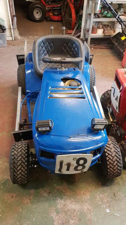

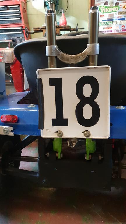

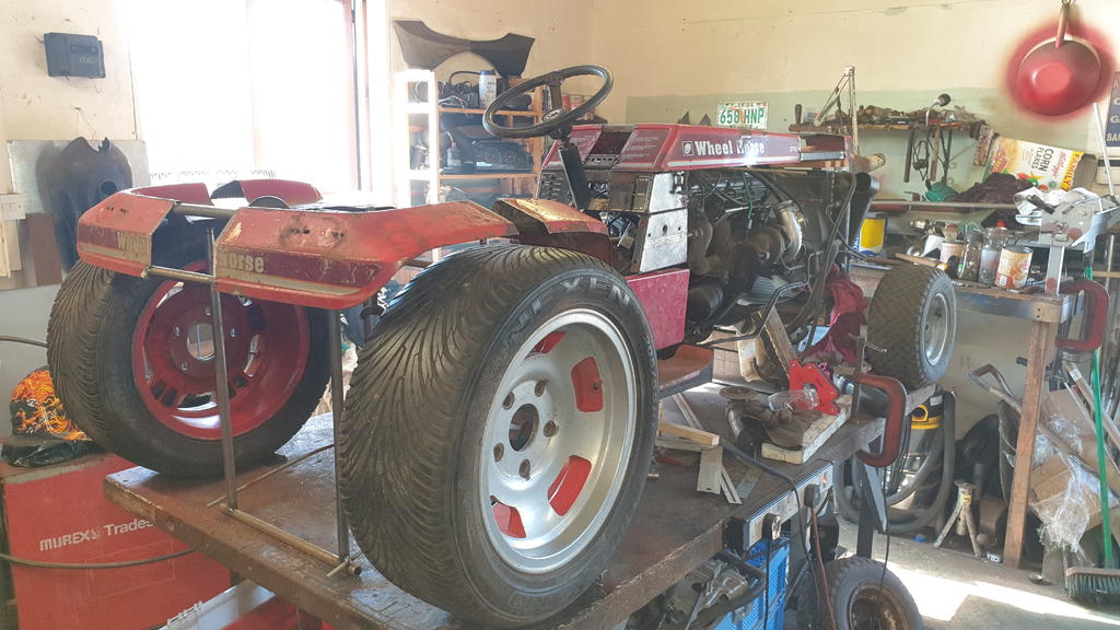

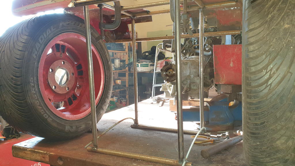

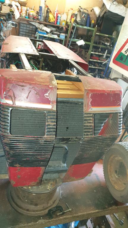

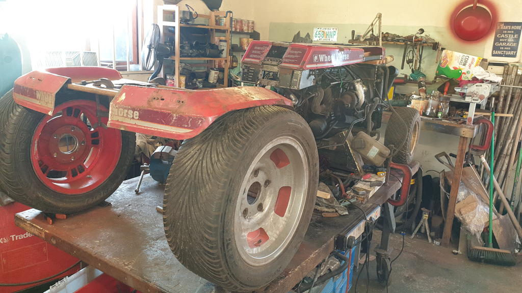

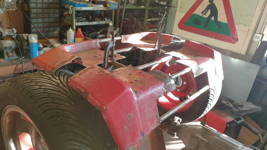

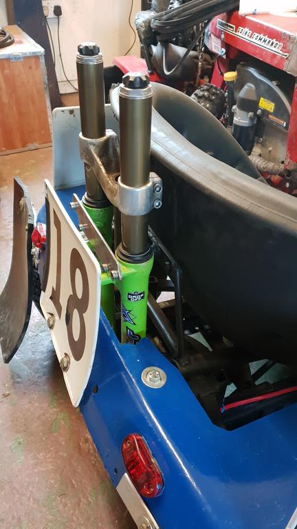

Ian 2,417 #19 Posted March 13, 2019 Morning all, a long overdue update for you all... I have been thinking about the suspension, but for a machine who's main roll in life will be to smoke the rear tyres/tires away, I'm not 100% sure it's going to be needed. with the low height I need there also wouldn't be any real suspension travel, maybe 2-3 inches! Also no suspension would make the build a tad easier!! My current thinking is something I saw on a racing mower which I am told works very well and saves a lot of back pain!! From the front it's hard to spot.. A bit of a give away at the back though Anyway, I'm not quite at that point in the build yet, but not the far off..... Yes work has finally started on Project Wheel-Vo I havn't quite finished my MadTrax quad build yet, but I had got to the point where I needed a few bits to finish it but no cash to buy them.. (Ordered this morning by the way) But MadTrax had reached the point where it could come off the bench... And as the bench was empty of course I needed something to put on it Engine, trans, a few wheels and the bonnet plonked in place.. Although the look is rather grin worthy, there are a few problems such as the bonnet is too short, too wide, and not long enough to not onlt fit over the engine but also cover the radiator, intercooler and tran oil cooler! Sooo best add 12 inches to the length and 4 inches to the width.. At this point I am not sorting the bodywork out, I just need to stretch things a little until Wheel-Vo looks right hence all the random bit of tube and box holding the bonet together.. The fender pan got a bit of a stretch as well.. "Now with an added Nigel" to help you work out the scale.. This is a good point to drop in a video as it kinda covers all of the above. What it doesn't cover is the fender pan getting lengthened a bit.. Seeing the fender pan just resting on the top of the tyres was bugging me, so to get it to stay in the right place and height it gained some legs.. Only one thing for it... Get the ladder out and climb aboard to see how it feels.. The view down the bigger bonnet from the seat is amazing.. You will see it in the next video.. Yes the seating postion looks a bit high, the middle of the fender pan will be chopped out and lowered to get the seat and my vast weight lower.. A couple more pic's without the fat bloke... And that's as far as the build has got, the next job is to copy the fender pans lead and makes some legs/stands to hold the engine/trans in the right place and screw it down to the bench. I still need to tweak the panels around a bit, but I'm not that far off of thinking about the chassis.. 2 Cub Cadet and Alan reacted to this Share this post Link to post Share on other sites
Stormin 4,458 #20 Posted March 14, 2019 I like the low, mean look. Get the seat down low and it will really look the dogs whatsits. Share this post Link to post Share on other sites
mattblack 76 #21 Posted March 17, 2019 That's insane. Brilliant, but insane! Surely it's got to be called the Wheelmoose? Share this post Link to post Share on other sites
