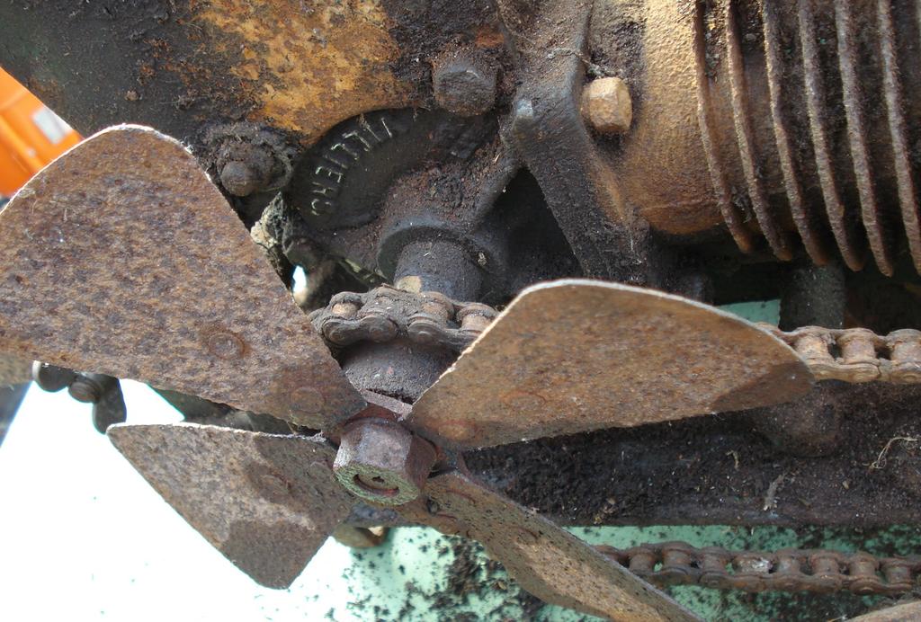

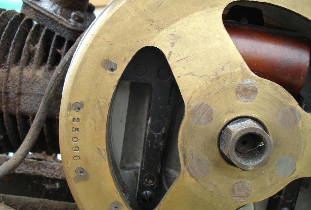

Anglo Traction 1,018 #6 Posted September 29, 2018 Haven't got any pics of the whole unit, it's in bits. I'm head down dealing with the engine assessment (when I'm not prepping the C-120 for sale). If it can't be bought back to life, then it will just be large boat anchor, or garden sculpture potential. The latter was the case for many years, hence the corrosion. The Magneto is clean as it was covered from the elements. Highly unlikely to get a spark out of it. Confirmed the engine date is 1922 with the serial letter/numbers and only have a couple of reference shots of the engine for what they are worth- 3 Alan, Cub Cadet and WestwoodGazelle reacted to this Share this post Link to post Share on other sites
Stormin 4,458 #7 Posted September 29, 2018 Villiers engine I see. Rather intrigued by the chain driven fan. Share this post Link to post Share on other sites
Fix'em all 49 #8 Posted September 30, 2018 Presumably this is a 172cc 2 stroke. The fan looks heavy enough to replace the normal flywheel that would have been used if fitted on a motorbike Share this post Link to post Share on other sites
Wristpin 400 #9 Posted September 30, 2018 Quote Villiers engine I see. Rather intrigued by the chain driven fan. Norm, think that the birthday celebrations have affected your eyesight , the fan is on the crank !!😋 Share this post Link to post Share on other sites
Stormin 4,458 #10 Posted October 1, 2018 9 hours ago, Wristpin said: Norm, think that the birthday celebrations have affected your eyesight , the fan is on the crank !!😋 I know. That's why I'm intrigued as to why. Share this post Link to post Share on other sites
Wristpin 400 #11 Posted October 1, 2018 Quote I know. That's why I'm intrigued as to why. But its not a chain driven fan, just happens to be on the crankshaft that's driving something else. Similar arrangement that used on several old mowers such as Atco Standards. 1 Stormin reacted to this Share this post Link to post Share on other sites
Anglo Traction 1,018 #12 Posted October 1, 2018 On 9/29/2018 at 7:01 PM, Stormin said: Villiers engine I see. Rather intrigued by the chain driven fan. e Nothing special Norm. Fan fixed to Sprocket on the Crank. Fan for additional cooling due partially enclosed compared to the exposed situation it would normally be in when fixed to a motor bicycle. On 9/30/2018 at 1:52 AM, Fix'em all said: Presumably this is a 172cc 2 stroke. The fan looks heavy enough to replace the normal flywheel that would have been used if fitted on a motorbike Had to check the 172cc engine out in the Books. That was an up-rated engine first produced in 1924. The first prototype engine went to a French Racing team (Monet Goyon) and it powered them to winning the French GP of that year. Known as the 'Sports' initially, then 'Sports' with the Auto Lubrication system, then Super Sports T.T and lastly the 'Brooklands'. However, I digress. This engine is the first 2 stroke 269cc engine designed and built by Villiers (in 1913). Fitted to a multitude of Motor cycle makes, direct belt or chain drive initially. Known as the Mk I (should be roman numerals) up to 1916, then Mk II, Mk III. Mk IV is claimed to be the first introduction of their Flywheel Magneto, as prior to this, they used an external chain driven Bosch Mag, but the war got in the way of supply. This engine, the MkV was discontinued from Sept 1922. They built 3 other engine designs (from 1923) - 150, 250 and 350cc as the Mk VI. So everything hangs on this being in working order. It is complete and has the original Carb with it. Also has the Villiers patent Free Engine Clutch. All these bits will need to work ok when fixed. Good news is that my concoction of fluid for loosening bit up worked on the siezed piston/crank after just 1 hour ! and found it was 'freed up' by accident !. So need to remove that nut on the end by the Fan first without any stress on the crank, then pull the cylinder to check the bore/rings and piston. Might have a source of used spare parts too. Also may have a replacement option for the HT Coil (same style). 3 Fix'em all, Alan and Stormin reacted to this Share this post Link to post Share on other sites

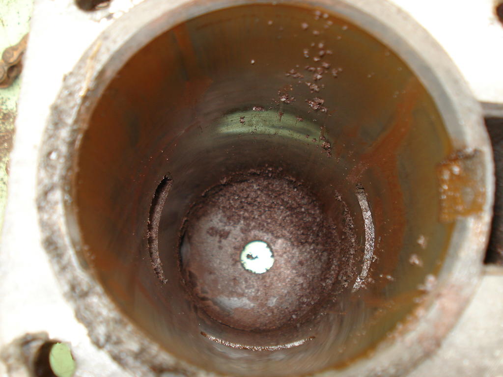

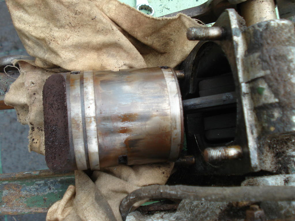

Anglo Traction 1,018 #13 Posted October 3, 2018 Made some progress on dismantling inspection of this engine. The nut came off the fan end ok. Looks promising so far. With a freed up crank 'n' piston, proceeded to carefully pull the cylinder. Quite surprised to find the internal condition pretty good before cleaning.........thought you may like to see what the size of the Piston rings used to be 96 years ago- To give you an idea, the bore diameter is 70mm. 2 of the 3 rings were stuck in their grooves initally, but just after I took this, they'd gently sprang out and all good so far. Quick look at the uncleaned bore is also promising which is dead smooth as far as can see- 4 Stormin, nigel, slf-uk and 1 other reacted to this Share this post Link to post Share on other sites
