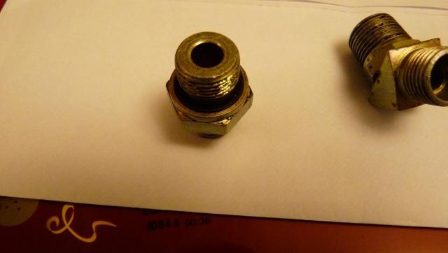

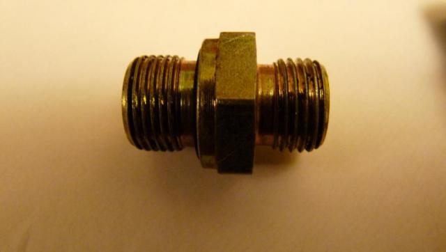

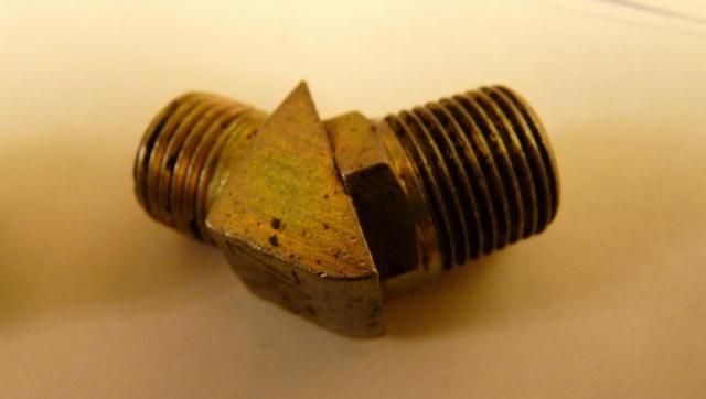

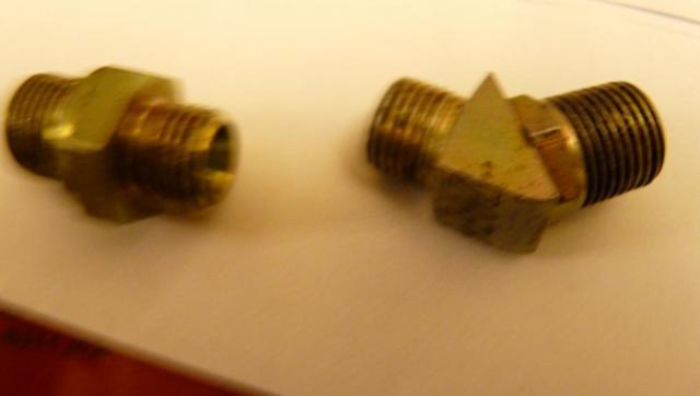

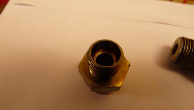

ranger 373 #232 Posted December 27, 2014 If you've got 10L-3/8 bspp fittings they should be 3/8" bsp parallel thread one end & metric the other, bsp fittings have a conical seat whilst metric is more rounded She's looking good !! :thumbs: Share this post Link to post Share on other sites
meadowfield 1,901 #233 Posted December 27, 2014 Maybe I haven't then, mine are bsp both ends 1 Cub Cadet reacted to this Share this post Link to post Share on other sites
ranger 373 #234 Posted December 27, 2014 Here are some pics of the fitting, the other is an angled 10L 3/8 which I found 1 meadowfield reacted to this Share this post Link to post Share on other sites
meadowfield 1,901 #235 Posted December 27, 2014 Perfect! Looks like I'm dropping in the week after next Thanks 1 Cub Cadet reacted to this Share this post Link to post Share on other sites

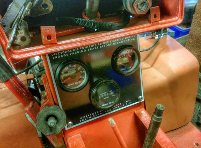

meadowfield 1,901 #242 Posted January 16, 2015 cold and snowy outside, so got on inside and made a custom dash decal. The existing dash panel is in pretty good condition, but needs painting and I'd prefer the electric clutch to be something else so here is a new panel. 5 diggerjames, ranger, Cub Cadet and 2 others reacted to this Share this post Link to post Share on other sites
the showman 4,074 #243 Posted January 16, 2015 Looks nice Mark, obviously not using the plastic dash Share this post Link to post Share on other sites
Ian 2,417 #244 Posted January 17, 2015 Very nice Mark Share this post Link to post Share on other sites
meadowfield 1,901 #245 Posted January 18, 2015 Looks nice Mark, obviously not using the plastic dash The plastic panel is in good nick, but I don't want the lighter socket and I want the electric clutch to say spots! So rather than try butcher a nice panel, I thought I'll add a sticker, will also match the lower dash panel. Very nice Mark Cheers 1 Cub Cadet reacted to this Share this post Link to post Share on other sites
meadowfield 1,901 #246 Posted January 23, 2015 Latest sticker order arrived today, so the lower dash panel is complete. 4 the showman, Cub Cadet, nigel and 1 other reacted to this Share this post Link to post Share on other sites
Stormin 4,458 #247 Posted January 23, 2015 Very nice! 1 meadowfield reacted to this Share this post Link to post Share on other sites
Triumph66 1,256 #248 Posted January 23, 2015 Very tidy Mark. Look good. 1 meadowfield reacted to this Share this post Link to post Share on other sites
the showman 4,074 #249 Posted January 23, 2015 The mutts nuts Mark 2 meadowfield and nigel reacted to this Share this post Link to post Share on other sites
meadowfield 1,901 #250 Posted January 24, 2015 Thanks guys, finished the upper dash panel too. It's a lot easier than painting and lettering Plus I can change the words... 5 OldBuzzard, Cub Cadet, Anglo Traction and 2 others reacted to this Share this post Link to post Share on other sites
