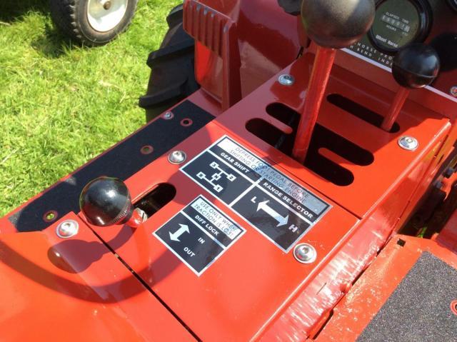

meadowfield 1,901 #317 Posted June 26, 2015 Looks like you had some fun with bendy up those steps mate Yup!Updates are sparse due to moving house, just found this pic from Tractorfest. I did some replica chrome decals for the new shifter plates on the transmission tunnel. 2 Cub Cadet and Joe the small engine man reacted to this Share this post Link to post Share on other sites

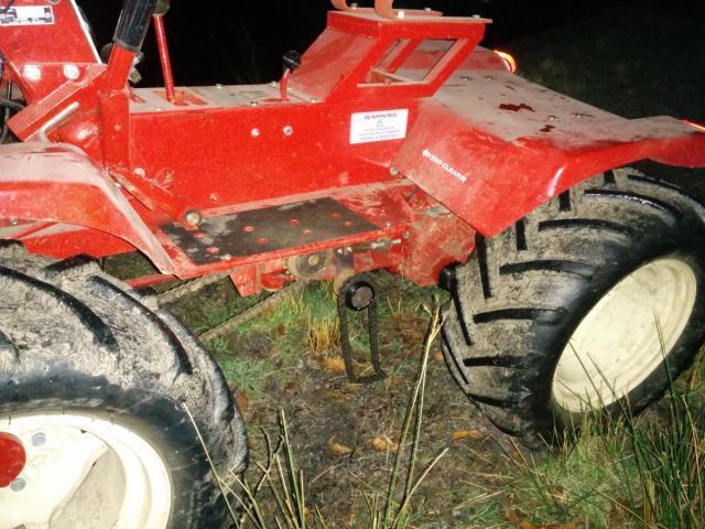

meadowfield 1,901 #318 Posted August 14, 2015 Been a while between posts, bendy is now getting used with a vengeance. For sure the crank pin needs sorting, it's getting noisier by the minute Whilst pulling up the cattle grid, I lost 4wd. A look underneath revealed this . The rear needs a belt guard to stop the long grass getting in 1 Cub Cadet reacted to this Share this post Link to post Share on other sites

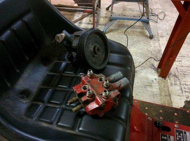

meadowfield 1,901 #319 Posted January 3, 2016 Long overdue an update! But now I have a fairly functional workshop I can get on with the outstanding jobs to complete bendy. In no particular order: Improve final drive to live rear axle, if the belts get wet or grass gets trapped then I lose drive under extreme conditions. Complete front three point hitch Add a diff lock indicator and improve the spring tension Complete the hydraulics. Add a front chain idler - the front chain has stretched and flaps around a bit Get the crank pin reground on the magnum 16 I'm thinking of tackling the hydraulics next, here's a d series dual spool valve and transit power steering pump. There should be just enough room to squeeze them in under the front right fender. 1 Cub Cadet reacted to this Share this post Link to post Share on other sites

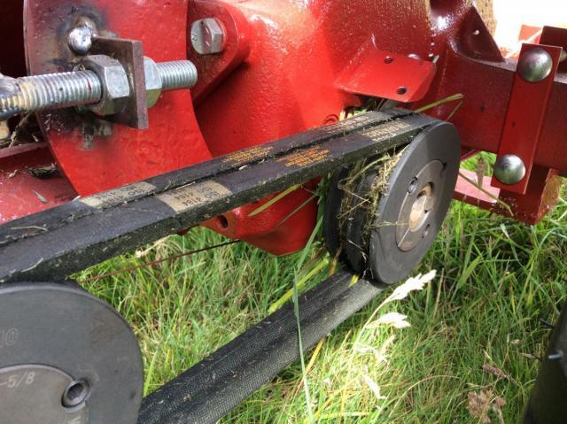

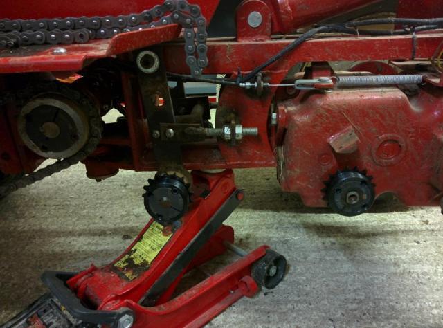

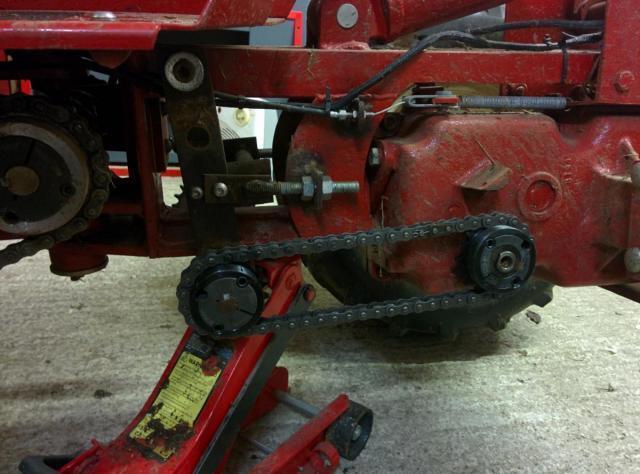

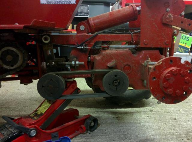

meadowfield 1,901 #322 Posted January 15, 2016 Well first phase of the new year hasn't gone well. Here's the original setup Then the new one A short test drive ended like this So for now, back to plan a 2 Joe the small engine man and Cub Cadet reacted to this Share this post Link to post Share on other sites
Joe the small engine man 89 #323 Posted January 15, 2016 it really annoying when good ideas just don't work out! but I suppose its just part of the fun hope Plan A goes smoothly for yea, best of luck Regards Joe Share this post Link to post Share on other sites
Stormin 4,458 #324 Posted January 15, 2016 Belt drive will allow flex. How about using toothed belt/belts? Share this post Link to post Share on other sites
meadowfield 1,901 #325 Posted January 15, 2016 it really annoying when good ideas just don't work out! but I suppose its just part of the fun hope Plan A goes smoothly for yea, best of luck Regards Joe Plan a was belts, they've worked for over a year, but are less effective under water 1 Cub Cadet reacted to this Share this post Link to post Share on other sites
