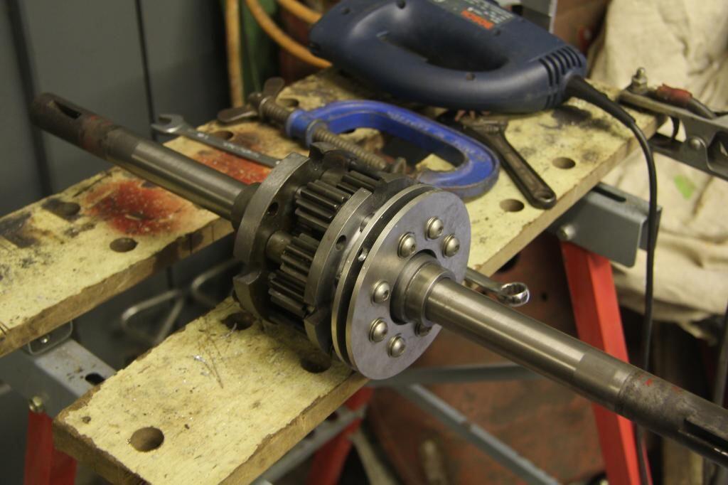

meadowfield 1,901 #76 Posted June 27, 2014 been busy today My plan works, but boy is it tight in there, the diff has to go in one way and I have an inch to get the additional bits in. turning one side down to make room for the bolts - note the oil in the spindle oiler the selector cage all together in the lock position I've started work on the selector fork and slider, now it's getting tighter. It's a good job I don't need all the gears 2 ranger and jak3_smith reacted to this Share this post Link to post Share on other sites
meadowfield 1,901 #77 Posted June 29, 2014 Managed another half day today, getting fed up now.... But nearly there, I keep having to bolt it all together to try it then unbolt to do the next bit. It's so tight I'm having to turn the heads down on bolts to give me clearance! Here's the selector linkage parts. And together working Back at work all week, so that's it for a while. Tour de France at the weekend, so might not get much done then either 1 diggerjames reacted to this Share this post Link to post Share on other sites

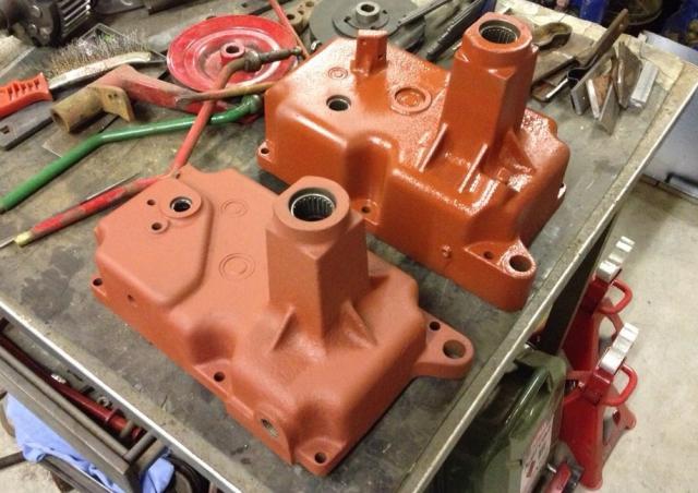

meadowfield 1,901 #81 Posted July 3, 2014 Got home and found this Child number has cleaned and painted the casing, how cool is that... Share this post Link to post Share on other sites
pmackellow 2,738 #82 Posted July 3, 2014 They have their uses then Mark Share this post Link to post Share on other sites

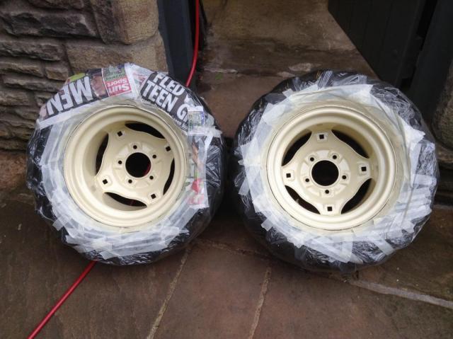

meadowfield 1,901 #99 Posted August 16, 2014 Small update, did a bit of painting today. Well a lot and here's two of the wheels freshly painted. Share this post Link to post Share on other sites
Ian 2,417 #100 Posted August 16, 2014 I can almost smell the paint from here .. The wheels look good Mark 1 diggerjames reacted to this Share this post Link to post Share on other sites
