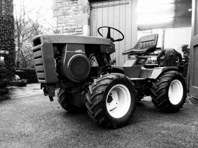

Stormin 4,458 #201 Posted November 22, 2014 Looking good. Share this post Link to post Share on other sites
the showman 4,074 #202 Posted November 22, 2014 I like the lights tucked under , looks real good Share this post Link to post Share on other sites
meadowfield 1,901 #203 Posted November 23, 2014 Looking good. cheers Norm I like the lights tucked under , looks real good I think its a nice touch Only managed to Wheel it out of the workshop before tea for an arty shot I'm starting on the gauges and electrics next I think... 5 Cub Cadet, the showman, jak3_smith and 2 others reacted to this Share this post Link to post Share on other sites
pmackellow 2,738 #204 Posted November 23, 2014 Looking good mate 1 meadowfield reacted to this Share this post Link to post Share on other sites
Ian 2,417 #205 Posted November 24, 2014 Bendy is looking good Mark, I like the light positioning 1 meadowfield reacted to this Share this post Link to post Share on other sites
