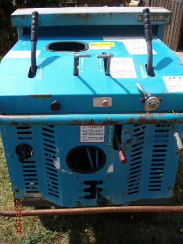

the showman 4,074 #8 Posted March 8, 2014 (edited) Well done c101. After spending hours on flebay and lots of research i found this down in kent. called the seller up and went for a look. Its a Kubota tracked dumper, petrol pull-start engine with 3 forward gears and 2 reverse , had a drive round his yard and had a deal. Edited March 8, 2014 by the showman Share this post Link to post Share on other sites
the showman 4,074 #9 Posted March 8, 2014 forgot this one of the controls Share this post Link to post Share on other sites
