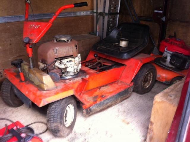

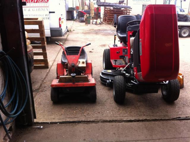

rotoscytheben 94 #1 Posted October 2, 2014 ive been after one of these for a while now and it turned up today after a few minutes it was running briefly but the carb is knackered and i hate tecumseh engines so its going to get a honda lump very soon here are a couple of pics 5 Ian, pmackellow, 4x4forks and 2 others reacted to this Share this post Link to post Share on other sites

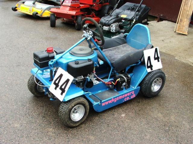

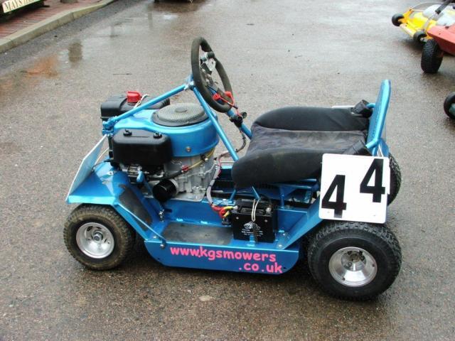

nigel 1,881 #4 Posted October 2, 2014 this is how it should look ben 1 Ian reacted to this Share this post Link to post Share on other sites

Wristpin 400 #6 Posted October 3, 2014 (edited) Nice to see an original unmolested Lawnbug, can't be many left. Plenty of new Tecumseh carbs out there . It's strange the way that so many people rubbish the Tec engines when in many ways they were of a higher spec than the equivalent Briggs . They just needed a bit more understanding and TLC.That Lawnbug looks to have the later blade engagement mechanism - top mounted engagement and locking lever, sliding spindle and single B section belt. I had one of the Mk 1 machines from new, - fixed blade spindle and twin A section belts, 7hp Tecumseh. Strange thing is I can't remember selling it; may have let it go with a house move.Westwood's quality control of that era was decidedly iffy , the parts lists were littered with " use as necessary" when it came to washers and spacers etc! I once bought a pack of three Lawnbug cutter spindles and there was five sixteenths of an inch difference between the lengths of the longest and shortest!You'll do what you like with it but it will be a shame to spoil its originality, once gone, it's gone and Hondas aren't the be all and end all of mower engines ! Edited October 3, 2014 by Wristpin 1 Anglo Traction reacted to this Share this post Link to post Share on other sites

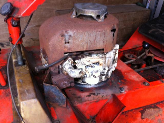

rotoscytheben 94 #20 Posted October 9, 2014 having been over to a fellow lawnmower repair man the other day in search of a new carb for the tecumseh engine unfortunately to no avail but i did manage to find a nos float for the carb and a good seeing to in the untrasonic tank hopefully will have sorted it i will fit it over the weekend and see fingers crossed 1 nigel reacted to this Share this post Link to post Share on other sites

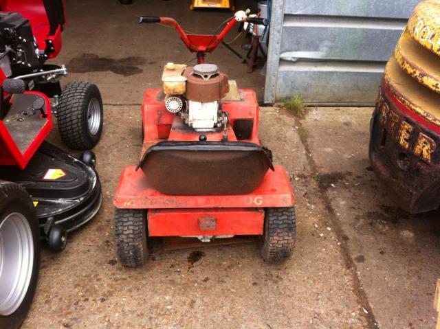

rotoscytheben 94 #21 Posted October 11, 2014 got the carb fitted back on today it soon became clear that all the governor linkage and springs etc were in the wrong place they are all fitted in there correct place now i just need a new governor spring and that should sort that out then i will see if the ultrasonic cleaning has worked with the carb oh and i need to sort the rear tyres out they are done for here is another couple of pics of it anyway Share this post Link to post Share on other sites
