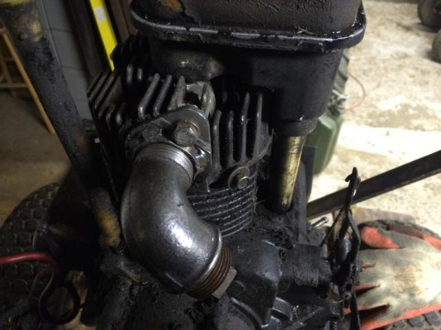

ranger 373 #76 Posted April 1, 2015 How about building the port up with weld, and then machining back to standard size ? 1 Stormin reacted to this Share this post Link to post Share on other sites
Stormin 4,458 #77 Posted April 1, 2015 How about building the port up with weld, and then machining back to standard size ? That's another option for you Iain. Share this post Link to post Share on other sites
slf-uk 914 #78 Posted April 7, 2015 I have been doing a bit on the G14 between other jobs. Tom dropped in the other day too and he got to try some of my tractors. I expect he will be buying a Bolens now after trying one, I really should have taken a picture In the end on the G14 I milled the head out to take a 1-1/2" sleeve then knocked up a sleeve on the lathe which I then put a 1" BSP thread in. Welded the bracket onto the sleeve and pressed into the head. I have reassembled the engine and plan to give it a wash before putting all the tin work on. Iain 3 Anglo Traction, Triumph66 and OldBuzzard reacted to this Share this post Link to post Share on other sites
Stormin 4,458 #79 Posted April 7, 2015 That looks Ok. Don't forget to take the plug out of the elbow. Share this post Link to post Share on other sites

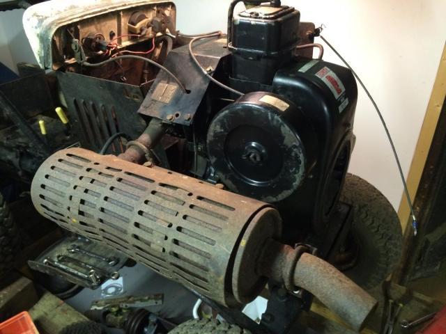

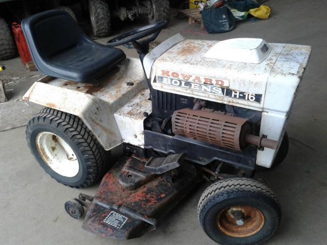

slf-uk 914 #86 Posted April 14, 2015 Over the weekend I gave the G14 a diesel bath followed by hitting it with the pressure washer. It is so much nicer to work on now but the state of the grass where I gave it a wash was the subject of much discussion with the boss. Progress on the G14 has been slowed by work commitments and I got distracted by buying and collecting another H16 . Picture from the advert Tonight I had a relaxing hour in the workshop on the G14 fitting the exhaust, engine panel work, throttle/choke cables and a few other jobs. Thanks to Norm's reminder I took the plug out of the exhaust pipe first I still need to fit the fuel tank and pipes, straighten and fit the hood, fit new battery cables, repair some more damaged wiring and refit the PTO and body panels. I have also bought some new front lights for it. Iain 2 Triumph66 and OldBuzzard reacted to this Share this post Link to post Share on other sites
Stormin 4,458 #87 Posted April 14, 2015 The size of the silencers on the Bolens gets me. It's bigger than the engine. 1 OldBuzzard reacted to this Share this post Link to post Share on other sites
Triumph66 1,256 #88 Posted April 14, 2015 Making headway there Iain. And the H16 look to be in good nick too. Share this post Link to post Share on other sites
Tom 215 #89 Posted April 17, 2015 You're getting there now Iain, the H16 looks real nice too! Tom Share this post Link to post Share on other sites

OldBuzzard 186 #98 Posted April 24, 2015 The size of the silencers on the Bolens gets me. It's bigger than the engine. I think Bolens called those the :Hush Tone Mufflers. They are a bit on the largish side, but they sure tame the "bark". MUCH quieter than the little round can type mufflers. Share this post Link to post Share on other sites
tester 2 #99 Posted April 25, 2015 Does anyone have a cutting deck ive just bought my first g14 also looking for front loader and other attachments please help want to see this baby wirking sgain manythanks ryan Share this post Link to post Share on other sites
slf-uk 914 #100 Posted April 25, 2015 I think Bolens called those the :Hush Tone Mufflers. They are a bit on the largish side, but they sure tame the "bark". MUCH quieter than the little round can type mufflers. Those Tecumseh engines really do bark out compared to a Wisconsin or Kohler. The original muffler on one of my G10's is toast and I have temporarily fitted one of those round can muffler. It is far too noisy. Does anyone have a cutting deck ive just bought my first g14 also looking for front loader and other attachments please help want to see this baby wirking sgain manythanks ryan Hi Ryan, Welcome to MOM, like others I would really like to know more about your Bolens. Some very knowledgeable Bolens folk on this forum who I am sure would be willing to help you with any problems Iain Share this post Link to post Share on other sites
