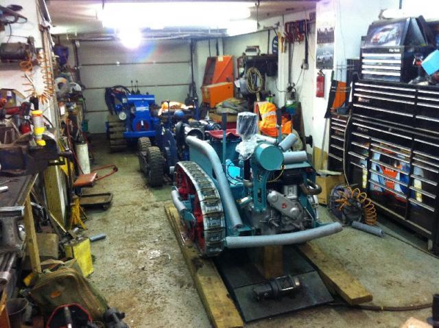

expeatfarmer 591 #228 Posted January 17, 2016 I am extremely pleased and relieved to report that 137 has now had a maiden voyage up the drive, along the road and round the garden. Changing the mag to a later impulse Wico transformed it, started and ran second pull. Not without a glitch though reversed out of the garage 10 yards and it stopped , I thought here we go again, took the plug out expecting it to be fouled no it was fine, changed it anyway to a two terminal 18mm plug, set it up went to tickle the carb and it did not tickle, took the fuel cap off NO PETROL I have used a whole tank full ( 2 gallons ) just trying to get it started over the last ten days. Full tank of fuel and it started first time. I have refitted the air pipe and then the filter in stages to check for any change in running, no apparent effect so it looks as if Cinderella will go to the ball in malvern. I am annoyed with myself for persisting so long with the two original magnetos. I justify it in that I have tried so hard to restore it to as it would have been when it left the factory, I have rebuilt so many bits of scrap to as new rather than replace but there comes a point when common sense and my physical well being prevail over total originality. I will have the mags rebuilt when I can find someone who knows what they are doing. I have blisters on my right hand and muscles I never knew I had. But now it all seems worthwhile. 7 Anglo Traction, pmackellow, hpearce and 4 others reacted to this Share this post Link to post Share on other sites

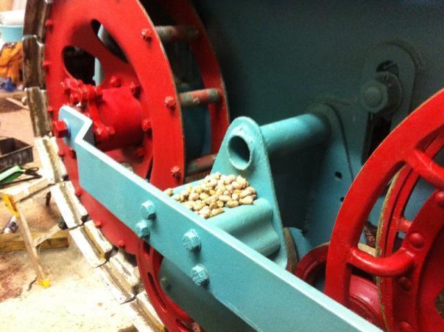

expeatfarmer 591 #244 Posted February 24, 2016 Cinderella is now ready for the ball along with the six others. had to evict a stowaway today when cleaning 137 one of the track frame support tubes was packed solid with peanuts obviously the mouse was going to self cater at Malvern!! 5 hpearce, nigel, Alan and 2 others reacted to this Share this post Link to post Share on other sites
Stormin 4,458 #245 Posted February 24, 2016 Mr/Mrs Mouse had packed them in well. I got three or four good handfuls. I think it got a bit confused though. A small piece of gravel was mixed in with the nuts. 1 nigel reacted to this Share this post Link to post Share on other sites
