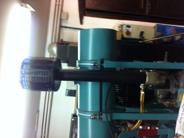

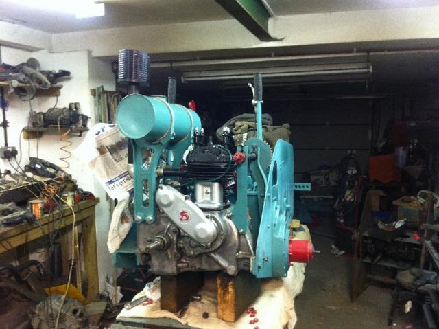

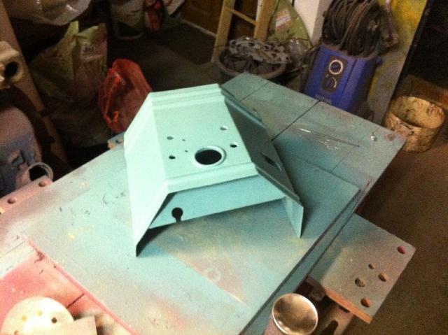

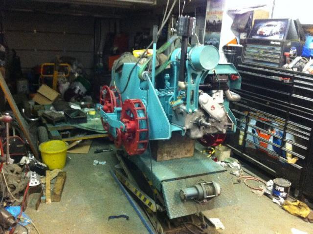

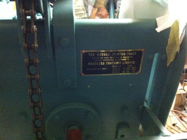

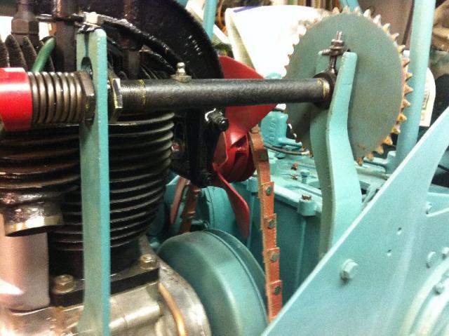

expeatfarmer 591 #126 Posted December 21, 2015 Lots of small jobs today, made a replica of the Vokes air filter pipe, fitted fan belt, I have used a joinable belt on the basis that to replace the belt you have to remove the engine or at least slide it out of its mounting. Fitted the patent flash at the back which is 1/16 of an inch bigger than later ones of which I have a stock so Chris at Vintage Brass plates scaled one up for me.Timing chain cover fitted and logo painted. Bought some cycle chain for the starter mechanism only to find I had such a thickness of paint and filler on the sprockets that I had to file them all down to get the chain to sit properly. And Finally I have sprayed a topcoat on the engine cowl which has taken hours and hours of bashing,brazing,filling and sanding to get it to look as it should. 5 C-101plowerpower, Stormin, Alan and 2 others reacted to this Share this post Link to post Share on other sites

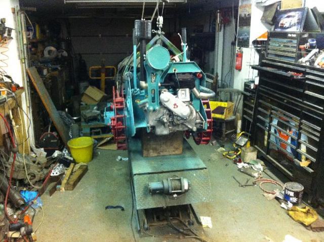

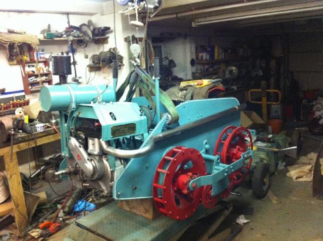

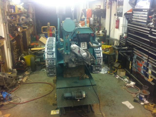

expeatfarmer 591 #137 Posted December 30, 2015 Made a bit more progress over the last two days, cowling fitted, decompressor lever set up, exhaust fitted, main wheels and load rollers fitted. Next job will be to fit the tracks and then fill up all the oils. 2 Stormin and nigel reacted to this Share this post Link to post Share on other sites

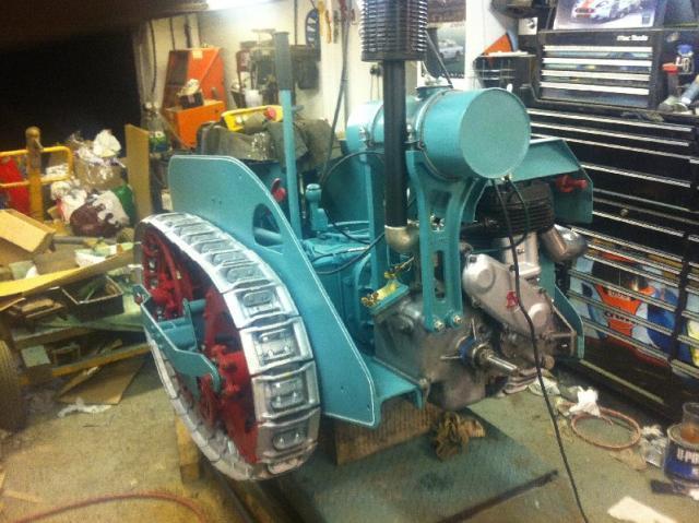

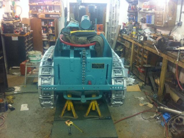

expeatfarmer 591 #140 Posted January 2, 2016 Today was track fitting and lubricating hubs,final drives and track rollers. The arduous task of tensioning both tracks was also finalised 29 track pads per side, two bolts per track , 116 bolts to tighten to achieve a spacing between track plate faces of 21/16". Boring and laborious but has to be done, planet rock on the radio a glove on the right hand and get stuck in! two hours later ,job done! Using a ratchet spanner on one side and a long spanner on the other makes it bearable. Both tracks set for pitch and then tensioned to 1 1/2" below load roller for correct track tension. I used three clamps to hold the tracks in position whilst I made the join. Tomorrow I will top up the engine and main gearbox oil and then fingers crossed start the engine, no idea how long it is since this engine ran but I hope I have everything at optimum to achieve a good start without breaking my wrists as these engines are notorious for doing. I have a secret weapon which I hope will make it both easier and safer. Final jobs are to make up floorboard sections, front bumper and then final touch up. And finally to apply the two decals to each side which are the only Ransomes reference on the whole machine. Over it's life 137 was serviced by a main dealer and had a number of later fitments such as a tool box and track mudguards but my ideal has been to restore it to a condition in which I believe it left the factory some time in February 1936. 5 Alan, Cub Cadet, nigel and 2 others reacted to this Share this post Link to post Share on other sites
