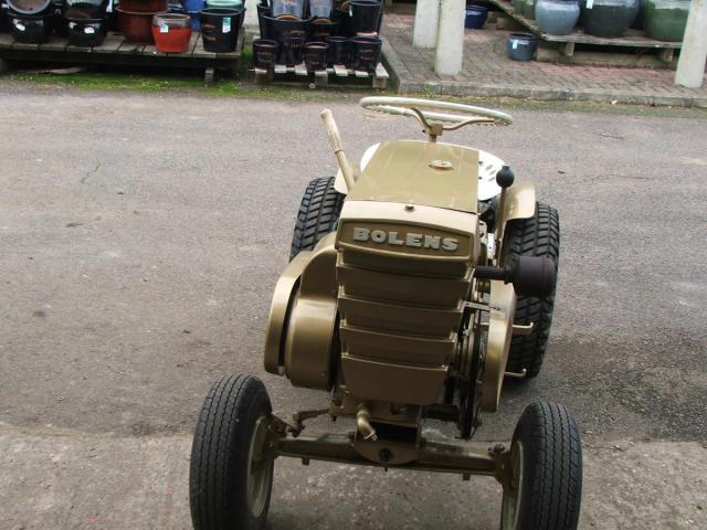

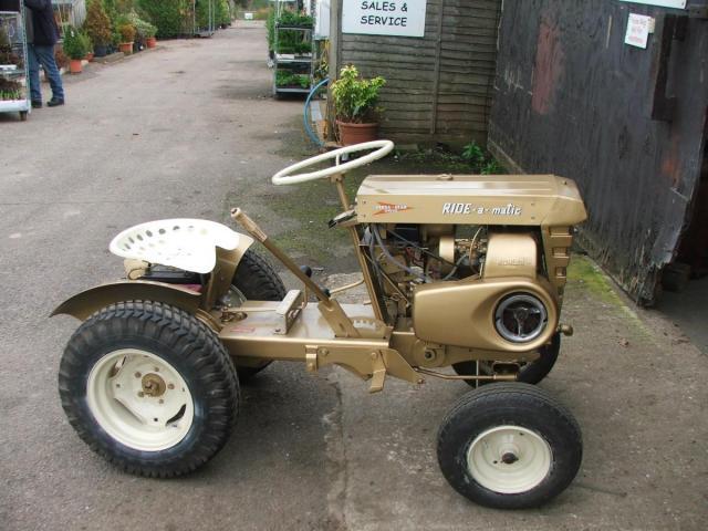

bubbalove 54 #51 Posted October 25, 2015 i found him to tractor is looking good im not sure about this pink idea lol Share this post Link to post Share on other sites
Stormin 4,458 #52 Posted October 25, 2015 Yep! Photo 3. Tractors lookin' good. Andrew will be in the pink when he gets it back. 2 Triumph66 and nigel reacted to this Share this post Link to post Share on other sites
Triumph66 1,256 #53 Posted October 25, 2015 Great to see it outside: it looks even better. Can't wait to see the decals on it. 1 nigel reacted to this Share this post Link to post Share on other sites

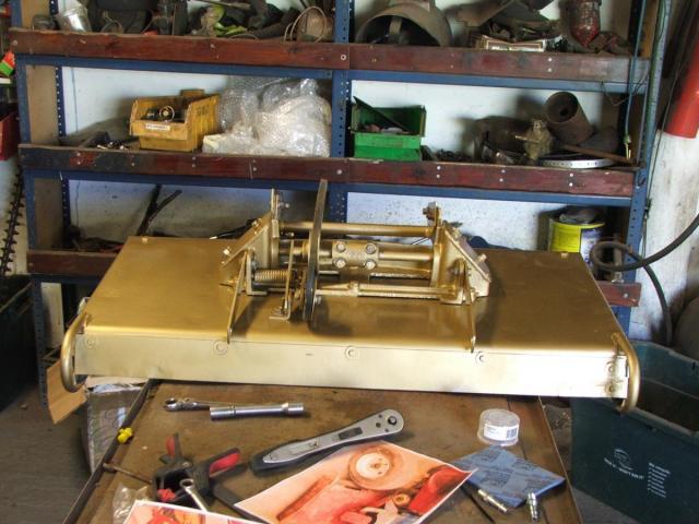

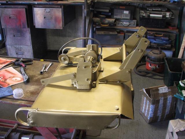

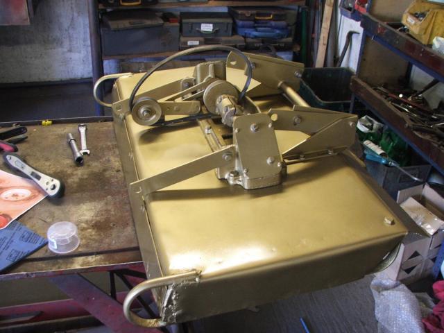

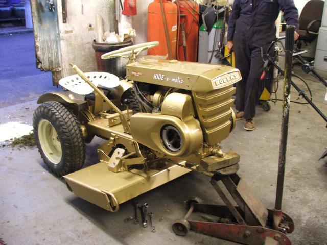

nigel 1,881 #54 Posted November 3, 2015 got the deck done, decals on, just got to fit the deck and grease every thing up Thanks to TITCH for the decals once again spot on . 5 HeadExam, Alan, pmackellow and 2 others reacted to this Share this post Link to post Share on other sites

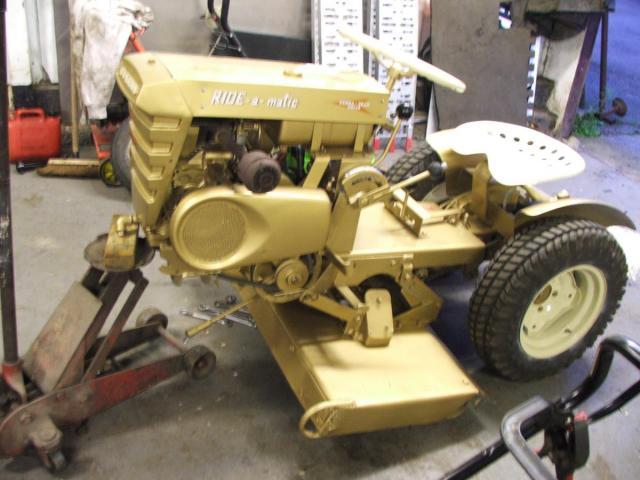

nigel 1,881 #57 Posted November 4, 2015 some times i hate old machines i put the deck on andrews machine today only to find the front wheels kept hitting it , did all the adjustment bit, still did it, then i relised the front axle was moving back and fowards,it seems the holes in the bracket that hold the axle were a third bigger than they should be, so ive had to take it off and will have to lathe some top hats up tomorrow to take the play out Share this post Link to post Share on other sites
Triumph66 1,256 #58 Posted November 4, 2015 That's a bit of a bugger Nigel. I have never heard the phrase top hats before in relation to engineering/ mechanical parlance. Still, the Bolens look awesome. Share this post Link to post Share on other sites
Stormin 4,458 #59 Posted November 4, 2015 Top hats = bushes shaped like top hats, Andrew. Just a small point on something I've noticed. The exhaust/silencer could do with some bbq paint. 1 Triumph66 reacted to this Share this post Link to post Share on other sites
Chris 642 #60 Posted November 4, 2015 I see you have carefully selected the best place to jack it up. The oil drain Looks a bit different to when I saw it last week. Oh I did not tell you Andrew 1 Triumph66 reacted to this Share this post Link to post Share on other sites
nigel 1,881 #61 Posted November 4, 2015 I see you have carefully selected the best place to jack it up. The oil drain Looks a bit different to when I saw it last week. Oh I did not tell you Andrew theres another jack under the deck chris I see you have carefully selected the best place to jack it up. The oil drain Looks a bit different to when I saw it last week. Oh I did not tell you Andrew theres another jack under the deck chrisTop hats = bushes shaped like top hats, Andrew. Just a small point on something I've noticed. The exhaust/silencer could do with some bbq paint.got to leave some thing for Andrew to do norm 1 Triumph66 reacted to this Share this post Link to post Share on other sites
Stormin 4,458 #62 Posted November 4, 2015 Suppose so, Nigel. Then he can say, "I did that". 1 Triumph66 reacted to this Share this post Link to post Share on other sites
Triumph66 1,256 #63 Posted November 5, 2015 Suppose so, Nigel. Then he can say, "I did that". Absolutely! That's the really skilful part of the restoration which I could not trust Nigel to do. It require a steady hand and and a good eye........ 1 nigel reacted to this Share this post Link to post Share on other sites

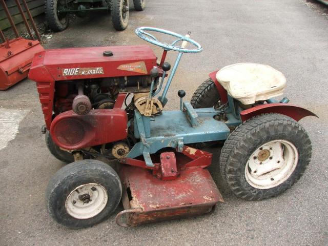

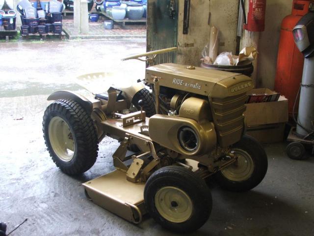

nigel 1,881 #64 Posted November 6, 2015 deck on all working, then taken off again, so it will go up the ramps into andrews van 8 meadowfield, HeadExam, Triumph66 and 5 others reacted to this Share this post Link to post Share on other sites
Triumph66 1,256 #65 Posted November 6, 2015 I like the before and after photos. See you tomorrow Nigel. Cheers 1 HeadExam reacted to this Share this post Link to post Share on other sites
meadowfield 1,901 #66 Posted November 6, 2015 That's a tidy restore Nigel 1 HeadExam reacted to this Share this post Link to post Share on other sites
Anglo Traction 1,022 #67 Posted November 6, 2015 Awesome Job Nigel . Look's better than new (I imagine). I'm sure Andrew will be real happy with it. 1 HeadExam reacted to this Share this post Link to post Share on other sites
HeadExam 1,783 #68 Posted November 7, 2015 Wow, really great job Nigel, she's ready for another 50+ years Share this post Link to post Share on other sites
diggerjames 543 #69 Posted November 7, 2015 That looks absolutely fantastic Nigel well done mate Share this post Link to post Share on other sites
Triumph66 1,256 #70 Posted November 7, 2015 Well I collected the Bolens late this afternoon after enduring a gruelling day drive through horrendous weather from Devon to Kent. Absolutely shattered and I have to say I am well pleased with the work on it too. I also collected the Huffy Broadlawn which I bought a while back. 1 nigel reacted to this Share this post Link to post Share on other sites
