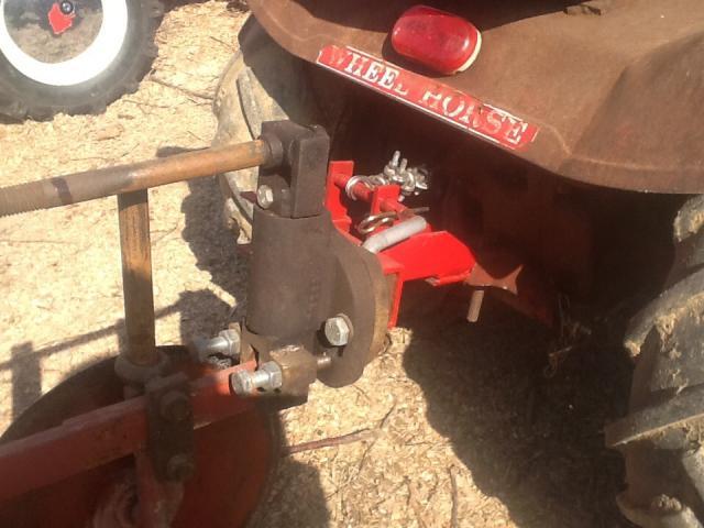

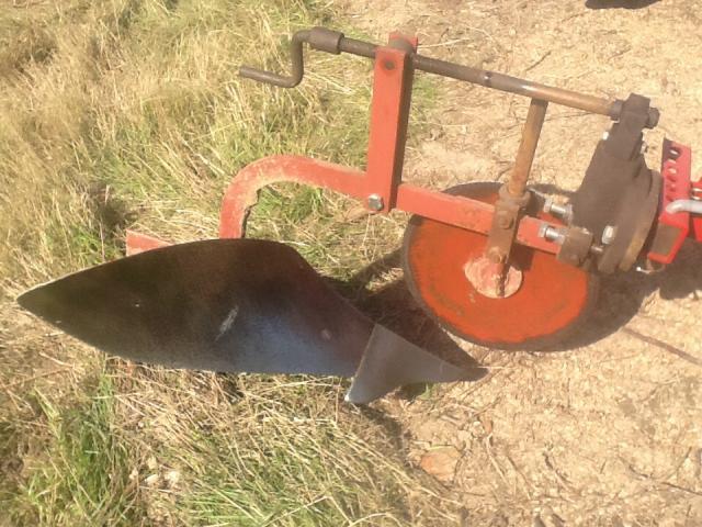

the showman 4,074 #6 Posted September 6, 2015 Here's a couple of photos of the hitch and the shiny plough after 2 days of hard ploughing 5 Triumph66, Vinnetrow, nigel and 2 others reacted to this Share this post Link to post Share on other sites
Stormin 4,458 #7 Posted September 6, 2015 Now hat's how a plough share should look. Share this post Link to post Share on other sites

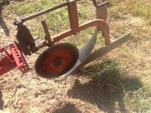

the showman 4,074 #15 Posted September 7, 2015 Here's a couple of photos I missed off my camera 4 Triumph66, Alan, nigel and 1 other reacted to this Share this post Link to post Share on other sites
Stormin 4,458 #16 Posted September 7, 2015 Could you not get the disc closer to the toe? Share this post Link to post Share on other sites
the showman 4,074 #17 Posted September 7, 2015 I tried letting it down and it stopped digging in, so I spent some time moving it around with no luck. as soon as I lifted it to were it is . it worked much better. this was done on Saturday when the plough wasn't polished as you can see by the first lot of photos the disc was going in the ground much better as it was taking the paint off and began to polish it . when I looked at the furrow the disc had made a nice cut. I may try letting it down again now its cleaned up Share this post Link to post Share on other sites
Stormin 4,458 #18 Posted September 7, 2015 Maybe as that chap said at RPT, sharpen the disc. I believe it should be as close to the toe as possible. Share this post Link to post Share on other sites
the showman 4,074 #19 Posted September 7, 2015 Maybe its because the plough was going in deep, I should have tried it higher but didn't think at the time, towards the end of Saturday and Sunday it was working so well and I was enjoying it I just kept going. Ive still a lot to learn but having fun 1 pmackellow reacted to this Share this post Link to post Share on other sites
nigel 1,881 #20 Posted September 8, 2015 this was a stubble field norm when the disk was lower it kept lifting the plough out the ground, a match ploughman told us to lift the disc on this type of ground and i must say it ploughed 100% better Share this post Link to post Share on other sites
Stormin 4,458 #21 Posted September 8, 2015 Tip noted and logged. Share this post Link to post Share on other sites
