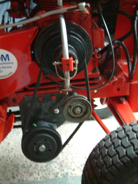

Stormin 4,458 #52 Posted June 28, 2017 I agree, Chris, but I couldn't find a pulley small enough. Those I could find would foul the brake pedal. But all is not lost. I hope! I remembered about an hour ago, that there was a box of Husqvarna bits tucked away under the far bench that I'd overlooked. Found a smaller diameter pulley in there that may do the job. I'll have to modify the tensioner shaft, but I've an idea how. 1 hour ago, ranger said: If you've another bearing Norm, put two side by side I do have another bearing, Doug, but the end of the shaft was turned down from metric to accommodate the bearing that is imperial. Bit awkward to turn down now. Share this post Link to post Share on other sites
Stormin 4,458 #53 Posted June 29, 2017 This morning I sorted out the belt tensioner. I cut the end off the tensioner where the bearing had fitted. Turned a sleeve to fit the I.D. of the insert that goes in the pulley bearing. Then put it all together. I refitted the tensioner to tractor, same way as before and gave it a try. Now the flat of the belt was running in the V of the pulley. Not really an Ideal thing, plus the belt flapped a bit. So a bit of thinking and trying different positions, here is what I ended up with. Seems to work fine and as soon as I can I'll give it a trial. 3 1 Alan, the showman, Cub Cadet and 1 other reacted to this Share this post Link to post Share on other sites

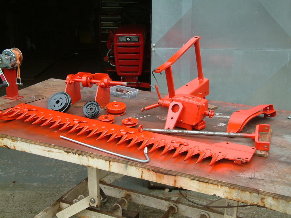

Stormin 4,458 #56 Posted June 30, 2017 Stripped it down this morning and got it all painted. Put it all back together tonight and a problem rear it's head. The cutter was sticking. So off came the bar and I removed the blade. Soon saw the problem. Paint had got onto the slide. A clean off with emery clothe and back together I could pull the blade back and forth easily. Back on the machine and it ran fine. I gave it some oil and left it running for 15 minutes. Couldn't resist the temptation and tried some paper through it. Cut it without problem. Maybe get to try it on some grass tomorrow. 2 1 Alan, Triumph66 and S1g reacted to this Share this post Link to post Share on other sites

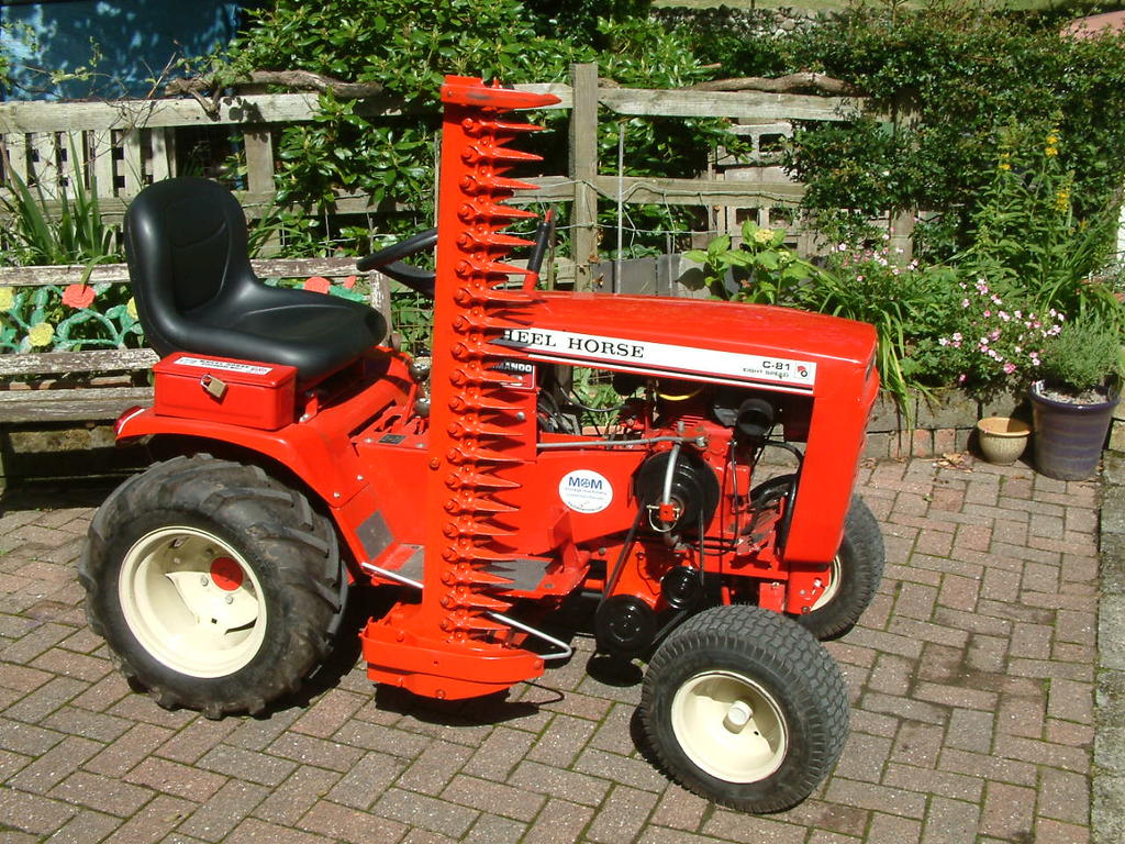

Stormin 4,458 #60 Posted July 1, 2017 All finished and ready to test. Took that in the morning and was going to see what it was like this afternoon after I'd done an oil change. Unfortunately I got a call from the farm and had to go and drive a big tractor. 7 1 expeatfarmer, Triumph66, Cub Cadet and 5 others reacted to this Share this post Link to post Share on other sites

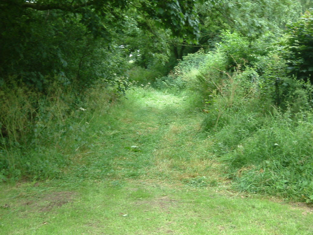

Stormin 4,458 #62 Posted July 7, 2017 Finally got around to trying out the sickle bar this afternoon. I'm really pleased with it to be honest. Took it down the overgrown bridleway past my home. Long, heavy, thick damp grass. Did two passes. One down, then one back up. Result below. 4 2 nigel, Cub Cadet, ranger and 3 others reacted to this Share this post Link to post Share on other sites
