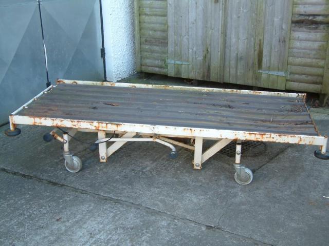

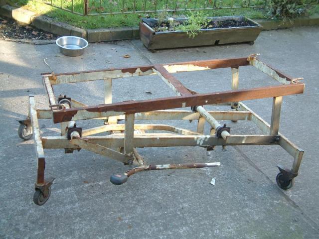

Stormin 4,458 #1 Posted March 7, 2016 Picked up these today. Any one guess what they are? And hopefully what one at least will be? 4 Triumph66, HeadExam, Cub Cadet and 1 other reacted to this Share this post Link to post Share on other sites
C-101plowerpower 548 #2 Posted March 7, 2016 ooh hospital bed tractor lift, i like it Share this post Link to post Share on other sites
nigel 1,881 #3 Posted March 7, 2016 I bagsy first dibs on the one your going to sell norm 1 Stormin reacted to this Share this post Link to post Share on other sites
Stormin 4,458 #4 Posted March 7, 2016 Got it in one, Koen. The smaller one does work but has had a wheel amputated. The larger one, which is the one I will be keeping, needs freeing up. Pedal was seized and is now being soaked in penetrating fluid. I bagsy first dibs on the one your going to sell norm If your going to Newby Hall, Nigel. 1 Triumph66 reacted to this Share this post Link to post Share on other sites

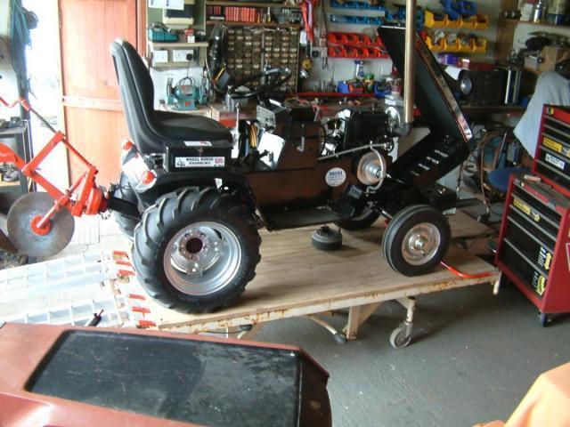

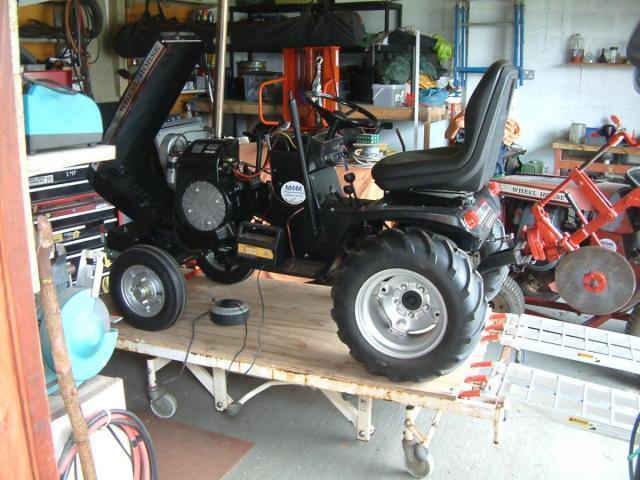

Stormin 4,458 #8 Posted March 8, 2016 Got everything free(ish) and a sheet of 5/8" ply, that been propping up the workshop wall for some time, temporarily fitted to the top. Found out it will not go down unless weight is on. It is hydraulic with foot pedal and very slow. I had to test it of course, before going any further. Max weight 185kg it says on the side. Think there's a tad more on there. But it never budged. It won't lift over 20" high now, but that will do me nicely. It will most likely stay at that hight as well. No need really to lift it up and down. More to do yet. But may be a while. 7 Triumph66, HeadExam, pmackellow and 4 others reacted to this Share this post Link to post Share on other sites
Stormin 4,458 #9 Posted March 8, 2016 I just noticed the cable snagged under under the pedal. 2nd photo. Been out and sure enough, it was preventing the lift from going higher. So perhaps not the weight of the tractor after all and I've not knackered it. . 3 Alan, S1g and pmackellow reacted to this Share this post Link to post Share on other sites

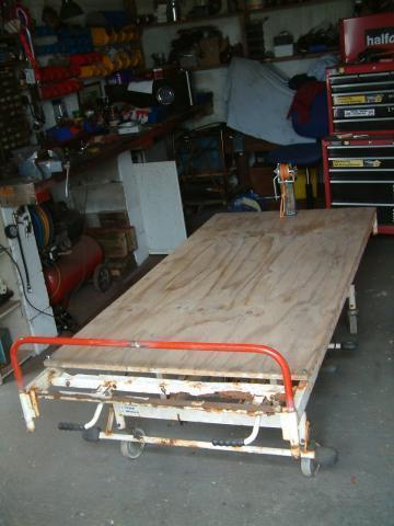

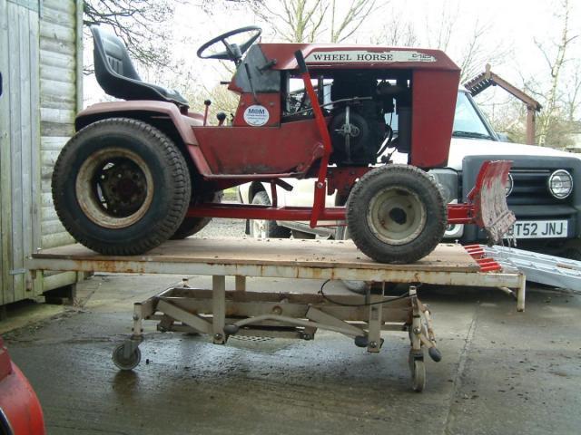

Stormin 4,458 #13 Posted March 10, 2016 Had a bit of a play today. Handle that can be fitted either end and hand winch for dead tractors. Bit of tidying up to do, then it will be ready for number three grandson to clean up and paint at Easter. I've not told him yet. 5 nigel, S1g, Triumph66 and 2 others reacted to this Share this post Link to post Share on other sites

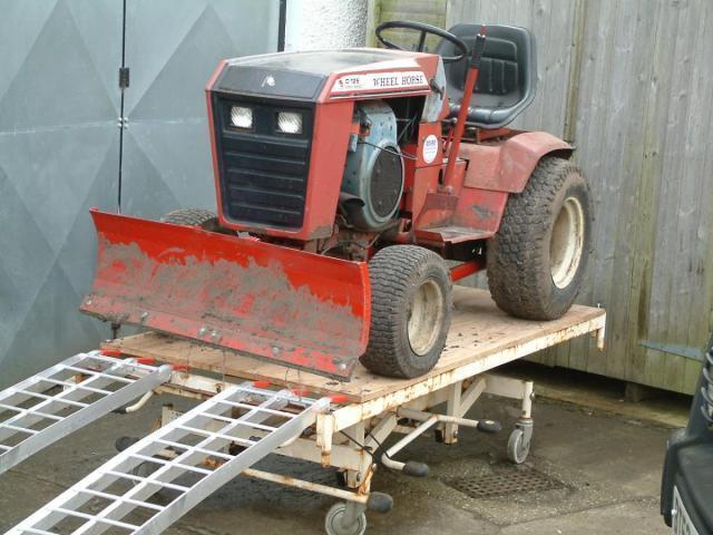

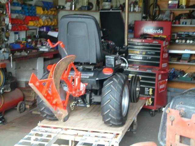

Stormin 4,458 #20 Posted March 11, 2016 Decided to put the Black Horse on the table and check out some settings for plough depth. I found the battery was flat, so no time like the present to test the winch. Up and on it went with little bother. I did find, as the tractor started to go up the ramps, the table tilted a bit. So some support legs are on the cards. Maybe get those done this afternoon. Also the table didn't want to pump up. Not surprising really. Tractor, plough and front weight will be a bit heavier than 185kg. Still 17" off the ground gave a comfortable working height. The table could be set higher, before loading the tractor though. Not that I'll be working under it. 2 Alan and ranger reacted to this Share this post Link to post Share on other sites
