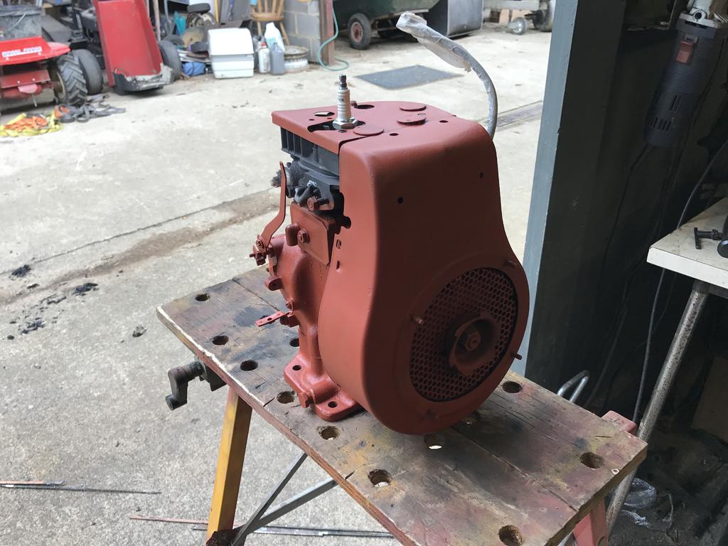

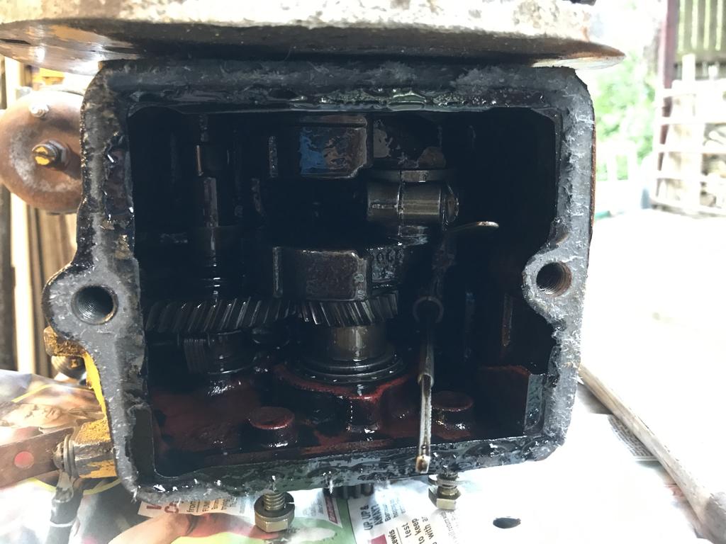

Cub Cadet 613 #31 Posted October 17, 2017 The focus was on the engine now, I had already stripped the engine down of any unnecessary parts and we had tried to start it. then it dawned on us that the engine didn't actually have any compression. We didn't really want to have to remove the head as the only replacement parts are NOS ones. Anyway we removed the head and Found the exhaust valve stuck open. As you can see the valve and the valve seat is incredibly rusty and pitted, I left the block and valve with my uncle who managed to grind it down to a useable state and the engine runs quite nice now. As for the head gasket I managed to find someone in Greece who was able to make a replacement from a scan of my old one for the cost of £4 We also managed to remove the old exhaust which had rusted in 3 meadowfield, Alan and Stormin reacted to this Share this post Link to post Share on other sites

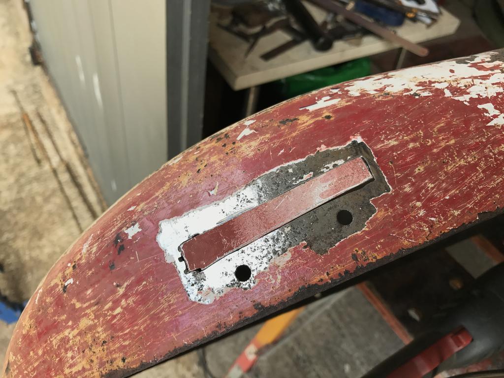

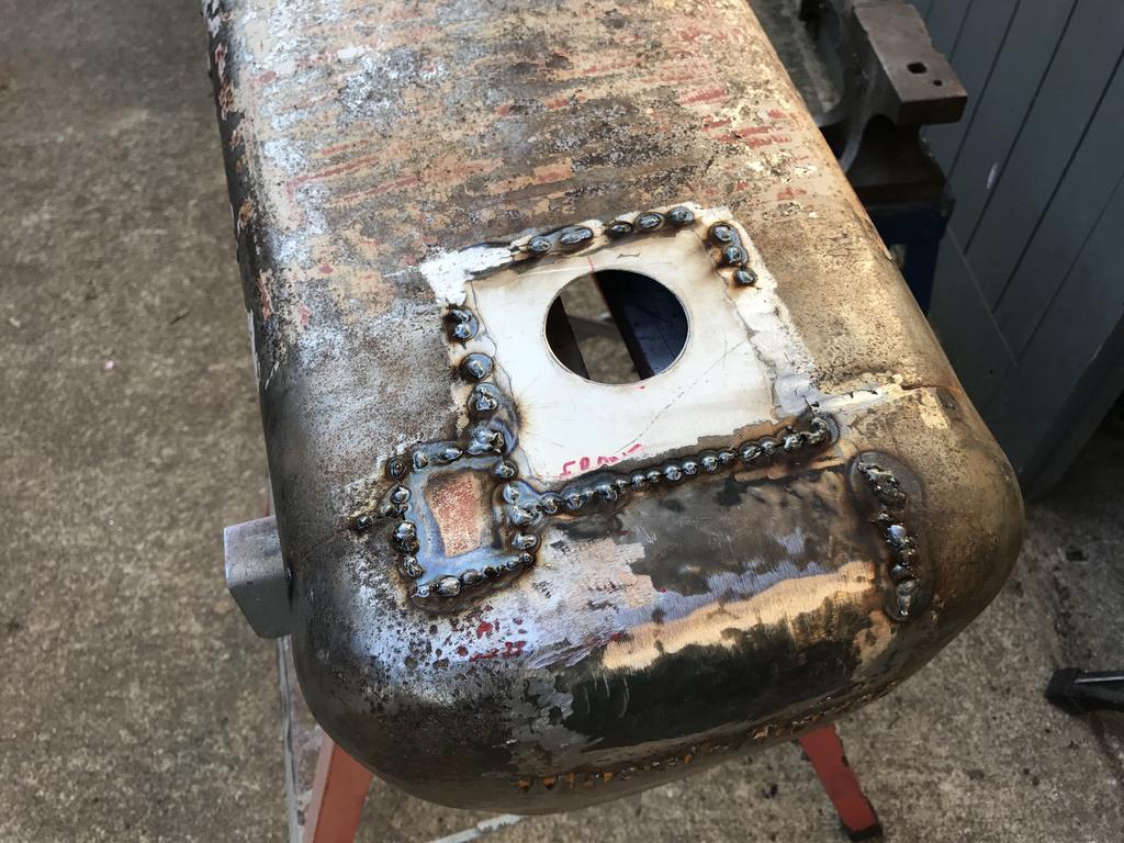

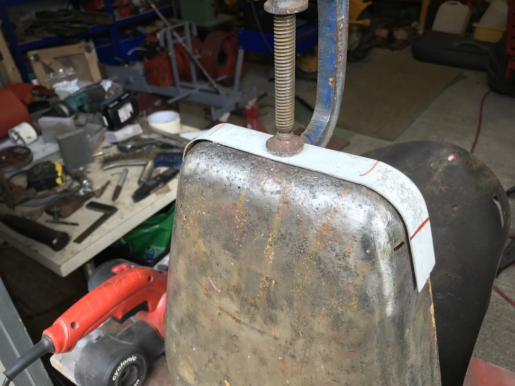

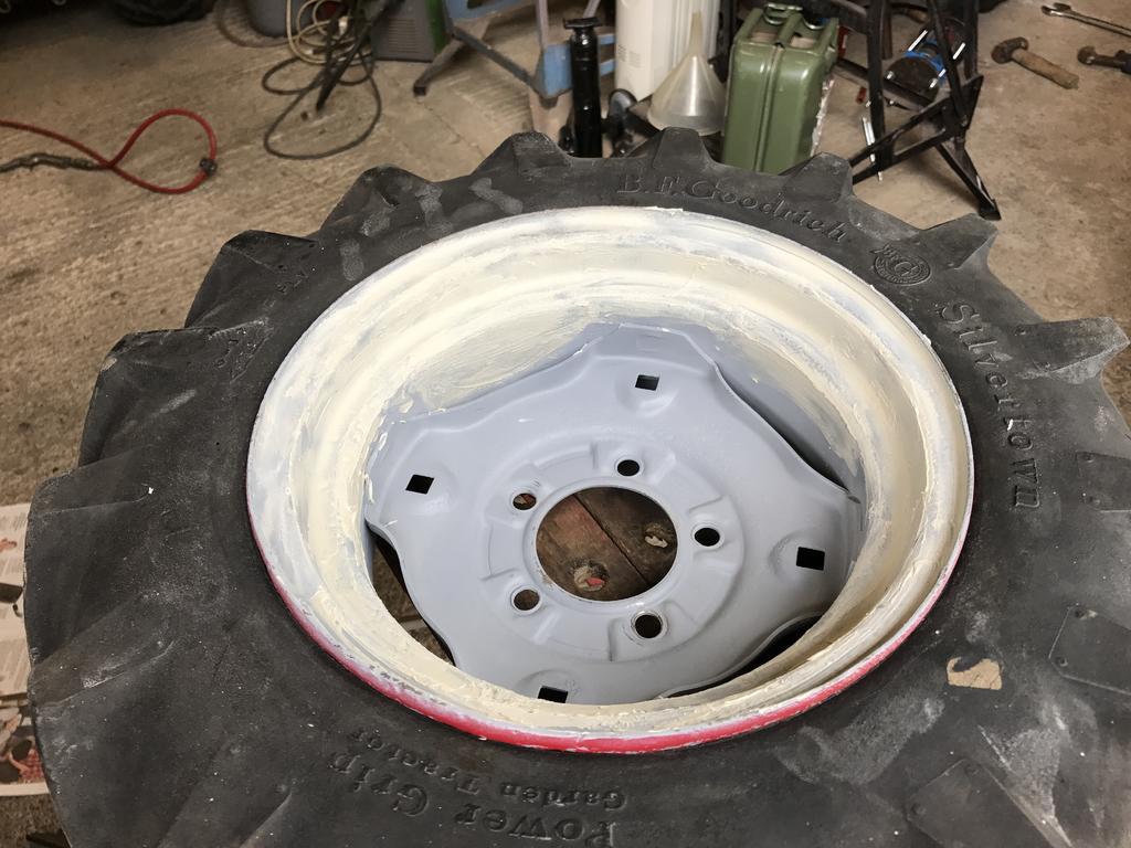

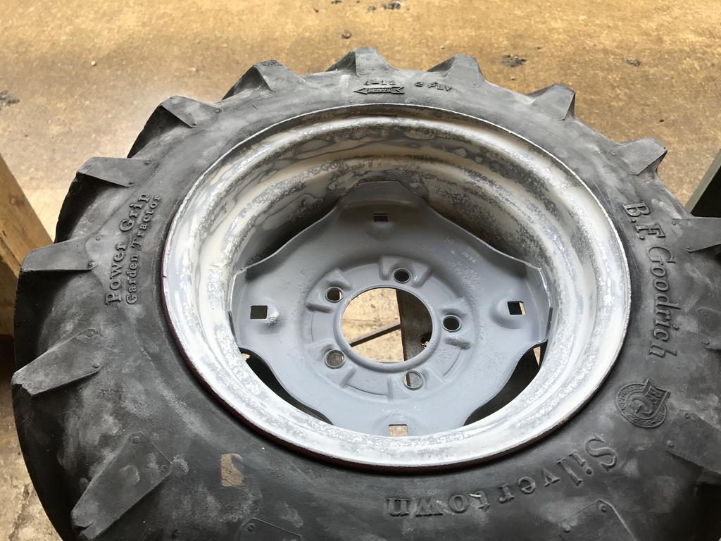

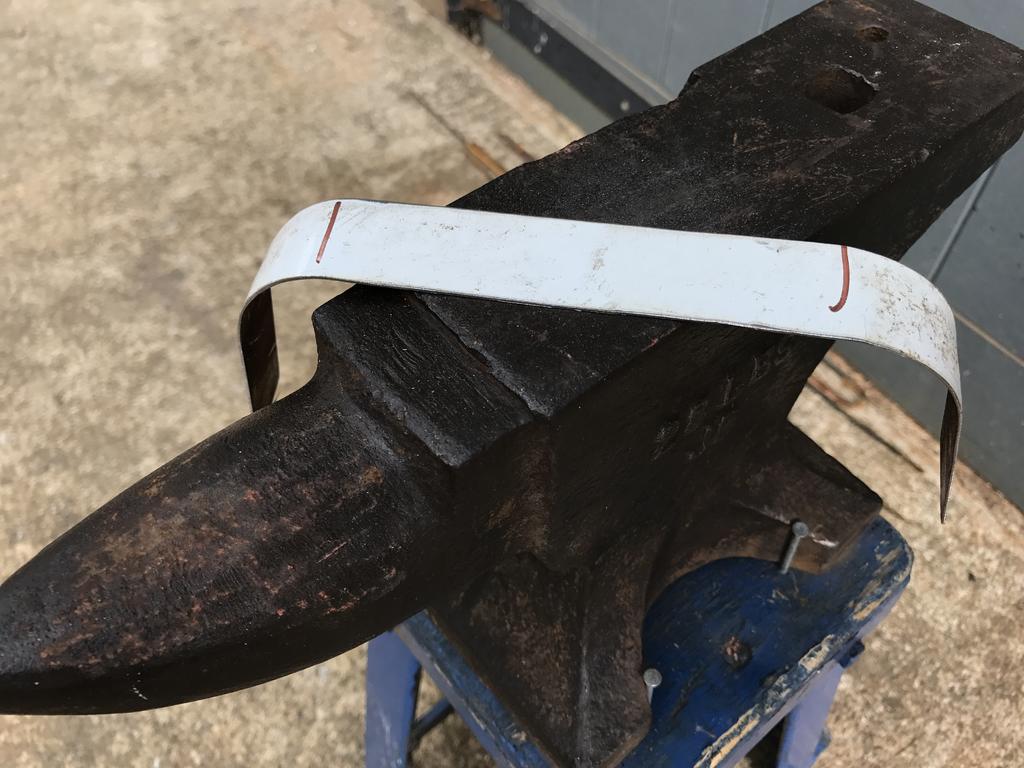

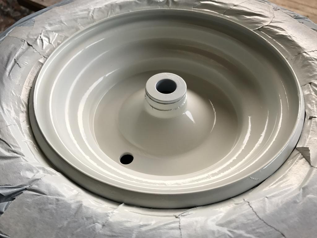

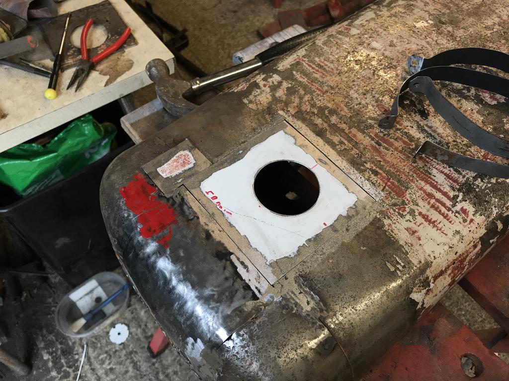

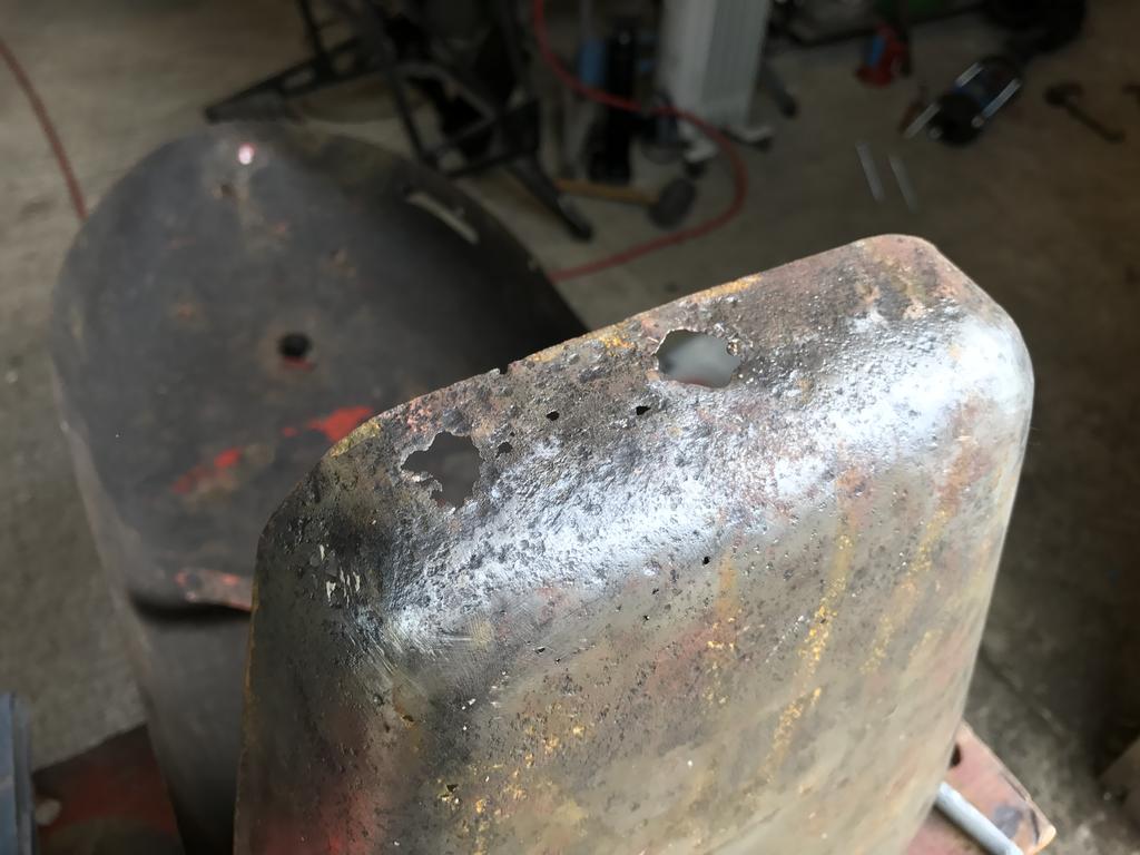

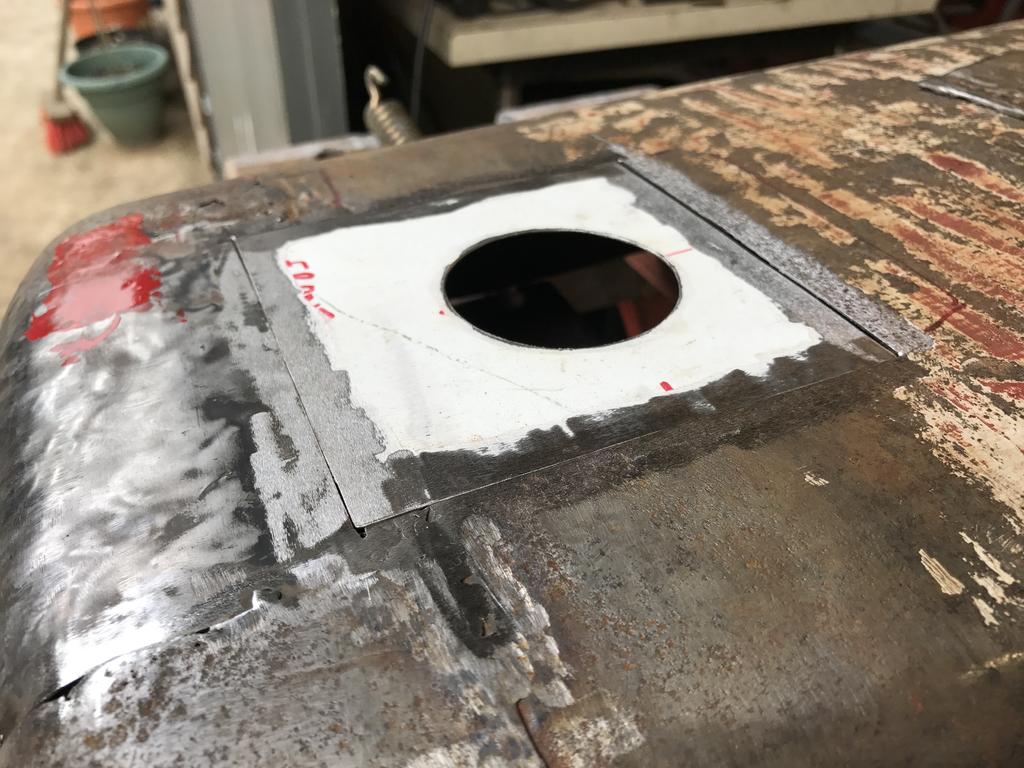

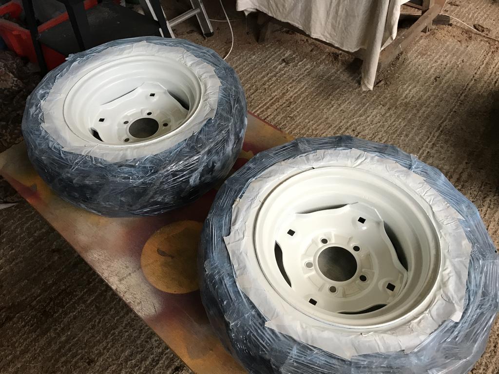

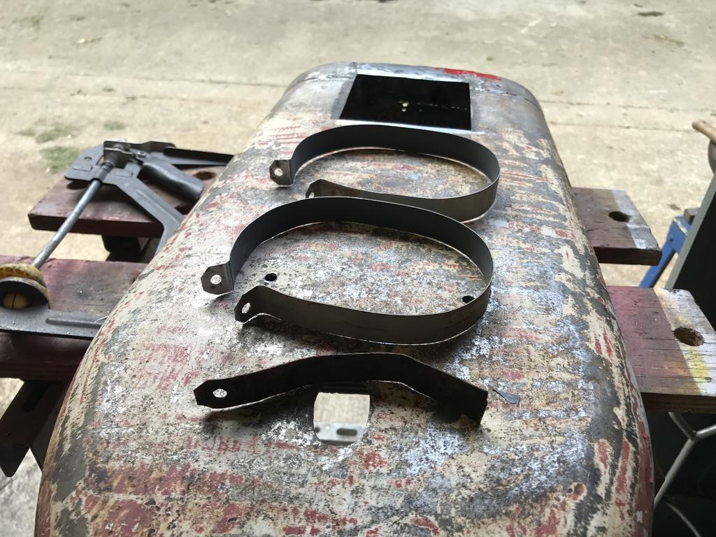

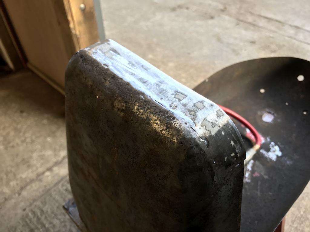

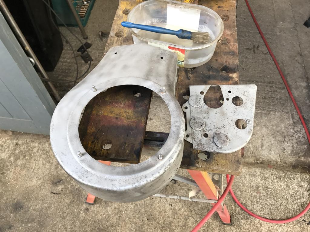

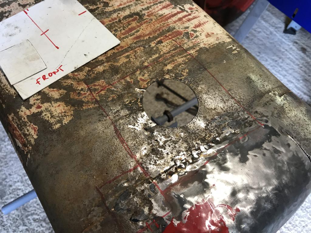

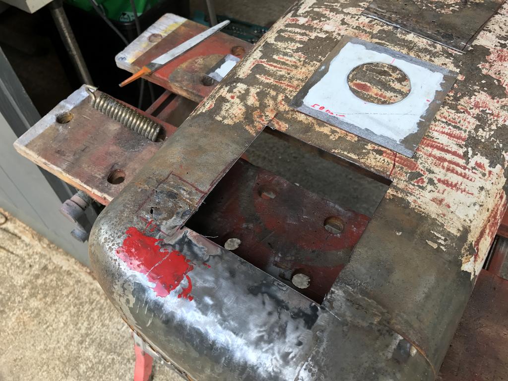

Cub Cadet 613 #48 Posted November 17, 2017 A few more bits cleaned up, filled and painted. One of the next jobs was to tackle the rusty hood. New piece ready to weld in. The bottom of the hood was in the worst condition, the hole in the middle is only meant to be 5/16" A new piece shaped New tank straps, made from part of the original Got the wheels painted too 3 Stormin, Alan and Triumph66 reacted to this Share this post Link to post Share on other sites
the showman 4,074 #49 Posted November 17, 2017 Your working wonders with that hood Ewan, ive got two in a similar condition so i'm watching with interest. 1 Cub Cadet reacted to this Share this post Link to post Share on other sites
Alan 1,274 #50 Posted November 17, 2017 Impressive work Ewan. A hood with that many holes would usually finish up in the skip. 1 Cub Cadet reacted to this Share this post Link to post Share on other sites
