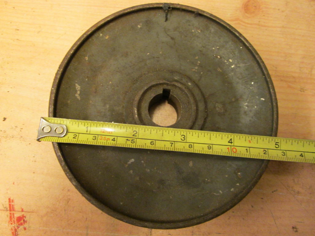

the showman 4,074 #18 Posted October 24, 2018 Next job is a rusty drive pulley, I've managed to find another but the centre needs changing. 2 Ian and Cub Cadet reacted to this Share this post Link to post Share on other sites

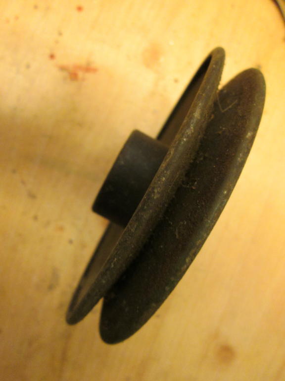

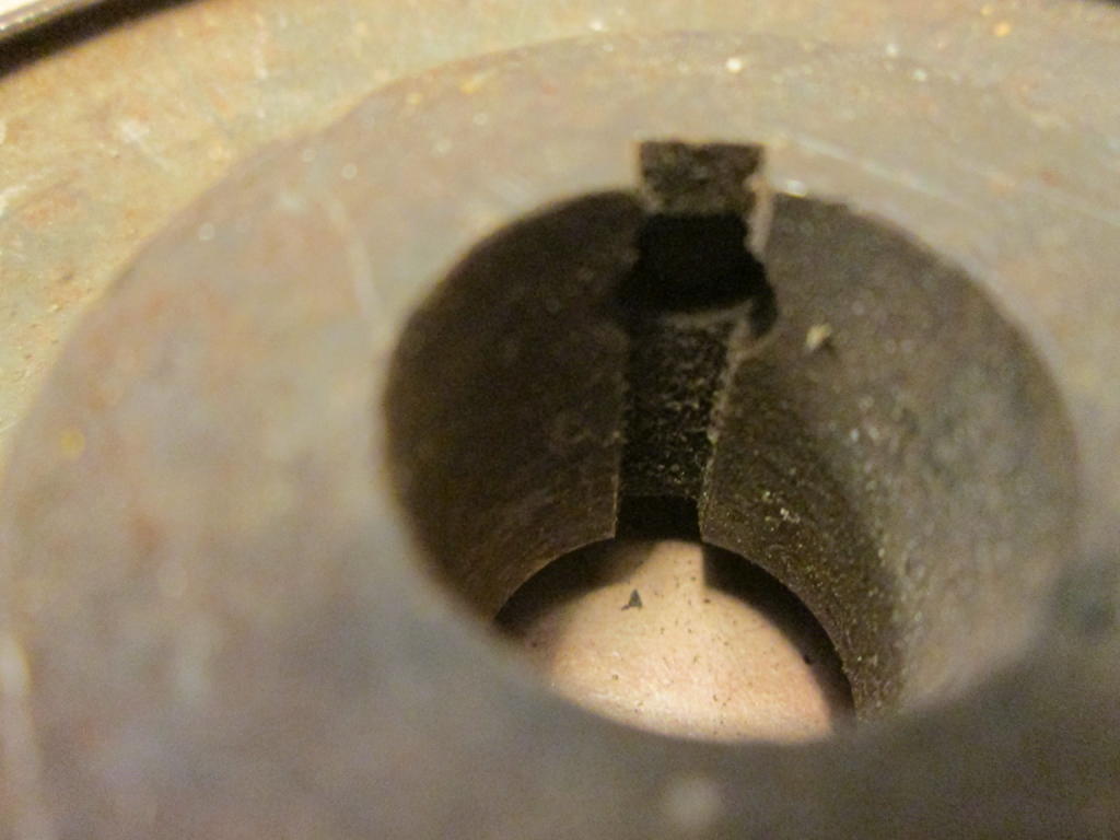

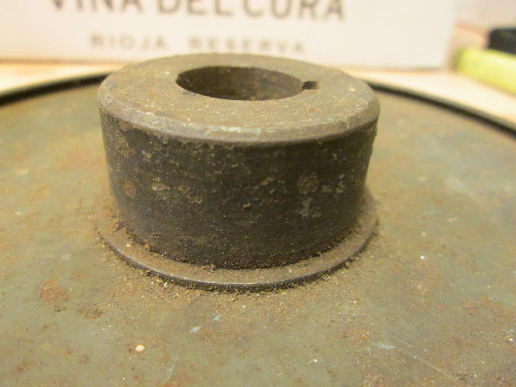

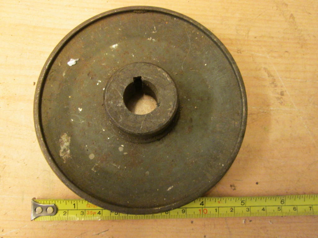

the showman 4,074 #20 Posted October 24, 2018 I managed to get an hour on the pulley before a member of the family wanted a bed moved, . First time I've used the Myford so quite pleased with what I've done. I put a 3/4 shaft through the old pulley to align it in the chuck and machined the hub off. I'm going to do the same with the new pulley to get the hub off then bolt and weld together. Comments welcome as I'm a bit of a muppet on the lathe and need education, 1 Cub Cadet reacted to this Share this post Link to post Share on other sites
Alan 1,274 #21 Posted October 24, 2018 Hi Chris. Found another pulley if any good. 5 inch with a 3/4 inch bore. 3/16" key way. Only 1/2" belt size though. Edit. Just seen your post. Looks like you might be sorted. Share this post Link to post Share on other sites
the showman 4,074 #22 Posted October 24, 2018 Looking at that pulley Alan it would have fitted straight on Share this post Link to post Share on other sites
Alan 1,274 #23 Posted October 24, 2018 11 minutes ago, the showman said: Looking at that pulley Alan it would have fitted straight on I'll send it down if you want it. Share this post Link to post Share on other sites
the showman 4,074 #24 Posted October 24, 2018 Let me see if I cock this one up first then we can go to plan b Share this post Link to post Share on other sites
the showman 4,074 #25 Posted October 25, 2018 Got home earlier than expected so I've finished the pulley, The old hub is now welded on and the hub on the other side machined of on the lathe. Considering what I've done it runs quite true in the lathe so I'm pleased with that. 3 Stormin, Alan and expeatfarmer reacted to this Share this post Link to post Share on other sites
