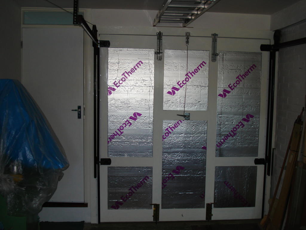

Anglo Traction 1,016 #7 Posted October 21, 2018 Nice big shed there. Should have that filled 'in the blink of an eye' I considered my Garage door security last year. No fixings or handles on the outside now. It's a 1962 wooden Westland of Yeovil door, to which I added wire mesh in the recesses (anti chainsaw). Then filled with insulation. Have 2 x 12" Brenton Bolts (plus the latch) on the top and 2 x 15mm Drop Bolts into concrete on the bottom. The sides are restrained by the heavy steel (anti saw) channel guides. Major improvement to the temperature stability after draught proofing. Internal side access shows the FD60 rated Fire door, seals and Insurance approved Yale lock. Feel much happier now, as it's integral on the ground floor- Boosted the fire warning system and extingishers too. Share this post Link to post Share on other sites
