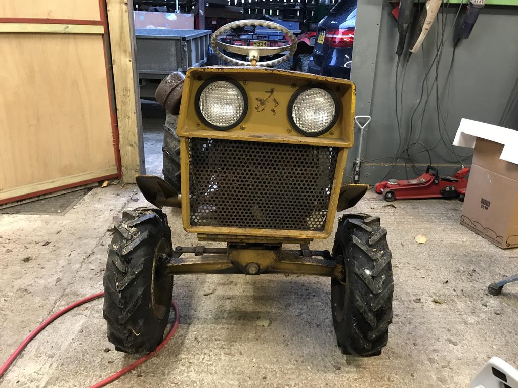

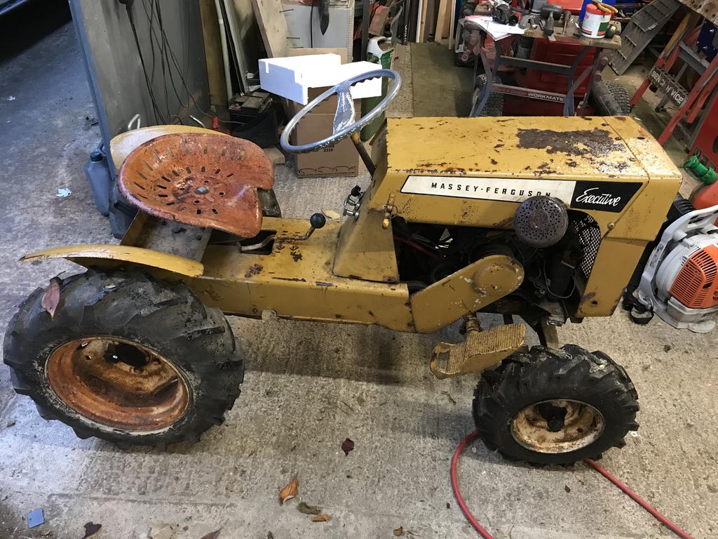

Cub Cadet 613 #1 Posted November 3, 2018 Was lucky enough to find this gem the other day, picked it up today. Apparently only 750 made. It was made by Moto mower and Massey badged them. Here are some pics, please let me know if anyone knows anything about them. 4 slf-uk, 4x4forks, Alan and 1 other reacted to this Share this post Link to post Share on other sites

Cub Cadet 613 #3 Posted November 3, 2018 Hopefully it’ll be there, for once I think I might try and keep one original although it has been painted over at some point, they did make a fairly good job of it. Going to need to be stripped, cleaned and rebuilt first, will be a winter project 2 Anglo Traction and the showman reacted to this Share this post Link to post Share on other sites

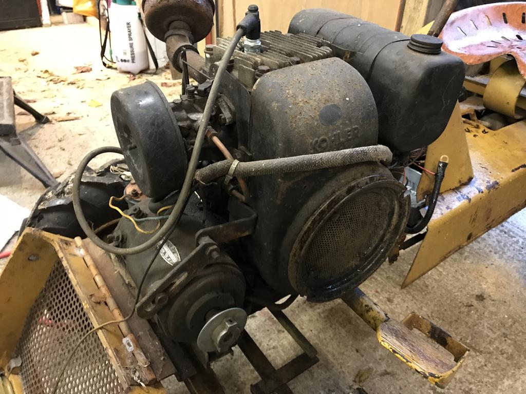

Cub Cadet 613 #11 Posted November 3, 2018 1 hour ago, Stormin said: Well done, Ewan. Looks in reasonable condition. Shouldn't take to much work to tidy up. hopefully not, going to need all the electrics looking at, the front axle is very worn, needs quite a few new oil seals, and i suspect new bearings in the dynastart Share this post Link to post Share on other sites

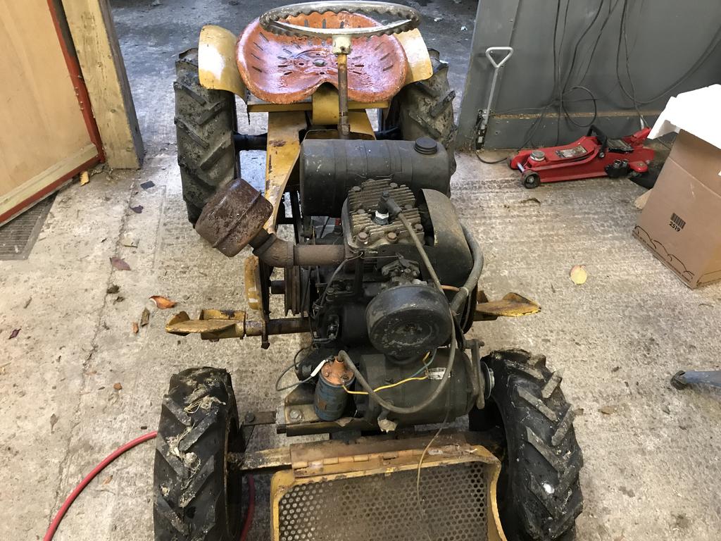

Cub Cadet 613 #16 Posted November 5, 2018 2 hours ago, Stormin said: So that puts Ewan's Executive model pre '65. What hp is the engine, Ewan? Does it still have an ID plate? Maybe you can date it off the engine number? They made the executive model in 1963, 1964 and 1965 I think, each year there was quite a few changes to the styling. I am pretty sure it is a 1963 7E (executive 7hp) as there is a few things such as the aluminium steering wheel and the foot pedals that make me think it is the 63 model. Unfortunately someone cut off the piece of metal which went at the top of the hoodstand, this had the serial and the model number on it. Very frustrating! Also the engine serial number plate on these Masseys were positioned on the top engine cowl, this has also been removed at some point. So at the moment we are unaware if this is a 7 or 8hp engine. It looks identical to my cub 7hp engine apart from this one has a fuel pump, does anyone know if this was an option on a 7hp kohler? Is there any other markings that will help me deterring the HP without pulling the head? Thanks 1 HeadExam reacted to this Share this post Link to post Share on other sites
HeadExam 1,783 #17 Posted November 6, 2018 15 hours ago, Cub Cadet said: They made the executive model in 1963, 1964 and 1965 I think, each year there was quite a few changes to the styling. I am pretty sure it is a 1963 7E (executive 7hp) as there is a few things such as the aluminium steering wheel and the foot pedals that make me think it is the 63 model. Unfortunately someone cut off the piece of metal which went at the top of the hoodstand, this had the serial and the model number on it. Very frustrating! Also the engine serial number plate on these Masseys were positioned on the top engine cowl, this has also been removed at some point. So at the moment we are unaware if this is a 7 or 8hp engine. It looks identical to my cub 7hp engine apart from this one has a fuel pump, does anyone know if this was an option on a 7hp kohler? Is there any other markings that will help me deterring the HP without pulling the head? Thanks The Kohler 7hp (k161) and 8hp (k181) both had a bore of 2.938 inches. The only difference between the two engines is the stroke, with the k161 being 2.500 an the k181 being 2.750 1 Cub Cadet reacted to this Share this post Link to post Share on other sites
Anglo Traction 1,018 #18 Posted November 6, 2018 No way of telling what size it is visually. Maybe worth pulling the head to check it anyway, just to see the condition and know what it is for sure. Can only offer you some engine spec info. Records of Kohler engines supplied to Moto Mowers show the following info- K141 Spec 29218 6.25hp. K161 Specs 28635 7hp, 28858 and 28861. Could not find any other engine type supplied to Moto Mowers, unless they obtained a batch of a Basic Model (off the shelf). Is that a Delco Remy starter generator?. You could search the parts list manuals for those specs to see if they show the mountings etc for it. Hope it's the original engine and not a swap in. 1 Cub Cadet reacted to this Share this post Link to post Share on other sites
Cub Cadet 613 #19 Posted November 6, 2018 9 hours ago, HeadExam said: The Kohler 7hp (k161) and 8hp (k181) both had a bore of 2.938 inches. The only difference between the two engines is the stroke, with the k161 being 2.500 an the k181 being 2.750 Thanks Alain 7 hours ago, Anglo Traction said: No way of telling what size it is visually. Maybe worth pulling the head to check it anyway, just to see the condition and know what it is for sure. Can only offer you some engine spec info. Records of Kohler engines supplied to Moto Mowers show the following info- K141 Spec 29218 6.25hp. K161 Specs 28635 7hp, 28858 and 28861. Could not find any other engine type supplied to Moto Mowers, unless they obtained a batch of a Basic Model (off the shelf). Is that a Delco Remy starter generator?. You could search the parts list manuals for those specs to see if they show the mountings etc for it. Hope it's the original engine and not a swap in. Thank you! I will have to investigate a bit more when I return from uni at christmas, yes it is a Delco Remy starter. I didn't have the time to look at the engine too much when I was home but I think it is the original, I'm always sceptical when someone says the 'tractor was running 5 years ago', I always wonder if it was put away as something broke, I guess I will find out when I strip it down. 1 HeadExam reacted to this Share this post Link to post Share on other sites
