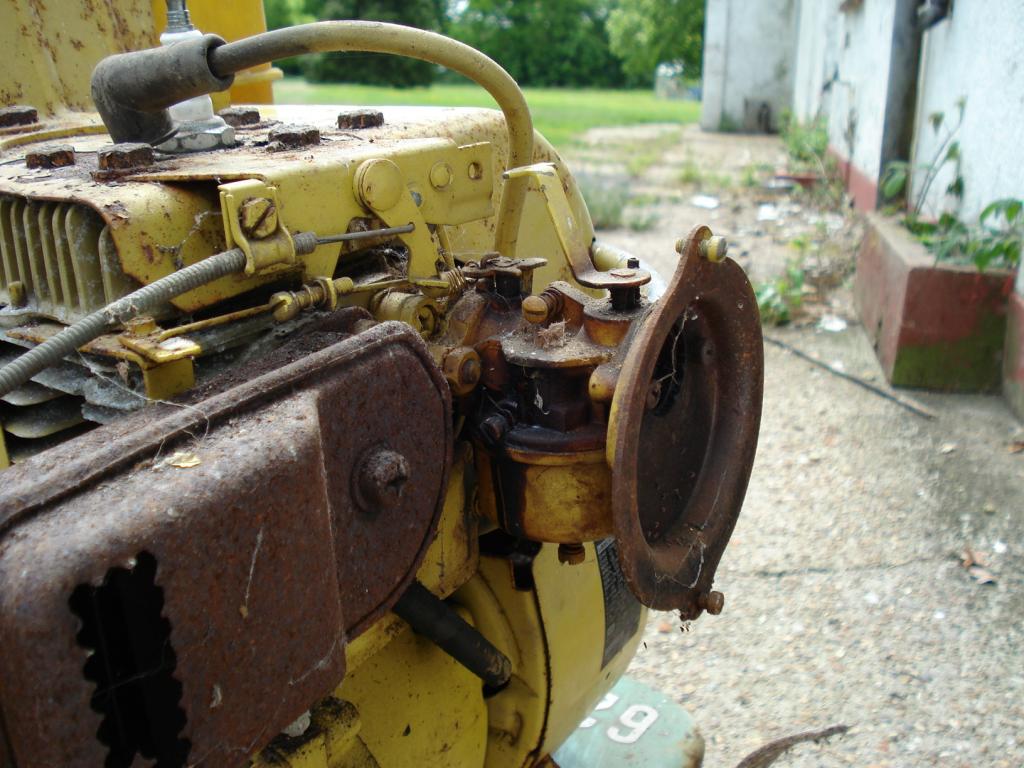

Wristpin 400 #1 Posted February 1, 2020 I've been doing an engine overhaul on a 1980s Tecumseh 7hp iron block vertical shaft engine for another forum member; valves, ignition, charging system etc and just when I thought that I was nearing the end I've found that some vandal has carved a chunk out of the air cleaner backplate and canister. Those parts were still current on Atco 24s etc using the horizontal shaft Tecumseh H50/60 right up to the 1990s so there should be a few around, but not, it appears, in the UK . In the USA, yes, with the appropriate carriage, duty and vat etc., but not over here. If anyone has a backplate and canister to sell, please contact me - all reasonable expenses paid . Otherwise I will have to get the welding gear out, not really my forte! 1 Stormin reacted to this Share this post Link to post Share on other sites

Anglo Traction 1,018 #5 Posted February 2, 2020 Maybe worth checking again with Nigel. Looks the same size as fitted to H50/60,V70 etc (31715) - . I had to obtain missing parts from the states 9 years ago for this derelict H60 Rotavator as no availability in UK (used or new)- Nigel's V70 Lawn Ranger... looks pretty close without checking parts lists - Good luck with sorting it. Share this post Link to post Share on other sites

Wristpin 400 #10 Posted February 2, 2020 There are two or three on US ebay but the carriage and then UK duty and value Added Tax added to the lot makes them a "luxury" item. I've got a couple of feelers out but after that its the welding set! Share this post Link to post Share on other sites

Wristpin 400 #14 Posted February 6, 2020 Thanks to all for looking but as time was moving on I got the welding gear out, made shaped paper templates , cut the sheet steel and stitched it in . A bit of a faff but got there eventually. 09CB57EA-B035-408E-A74F-0592215D7A02.MOV 3 Stormin, expeatfarmer and Cub Cadet reacted to this Share this post Link to post Share on other sites
