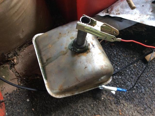

Wristpin 400 #12 Posted August 4, 2014 (edited) If the e tank works on line of sight I would imagine that just dunking the rusty fuel tank would only clean the outside. So is it necessary to turn the fuel tank itself into an e tank with the shell being the negative cathode and the positive anode being inserted through the filler but insulated from the tank so that the rust is attracted away from the tank walls to it? Edited August 4, 2014 by Wristpin Share this post Link to post Share on other sites
Anglo Traction 1,022 #13 Posted August 5, 2014 If the e tank works on line of sight I would imagine that just dunking the rusty fuel tank would only clean the outside. So is it necessary to turn the fuel tank itself into an e tank with the shell being the negative cathode and the positive anode being inserted through the filler but insulated from the tank so that the rust is attracted away from the tank walls to it? Yep! , spot on with your assumption Wristpin. had to do this 3 times to get the worst out. Here's a link to a pictorial example of my set up/effort- http://myoldmachine.com/topic/536-1972-genset/ You have to clean the Anodes regularly and ensure the by-products are able to float to the surface around the insulation on the Anodes. Share this post Link to post Share on other sites

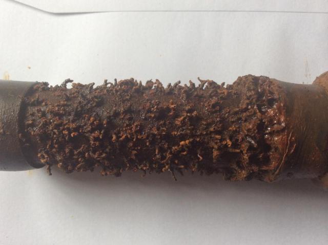

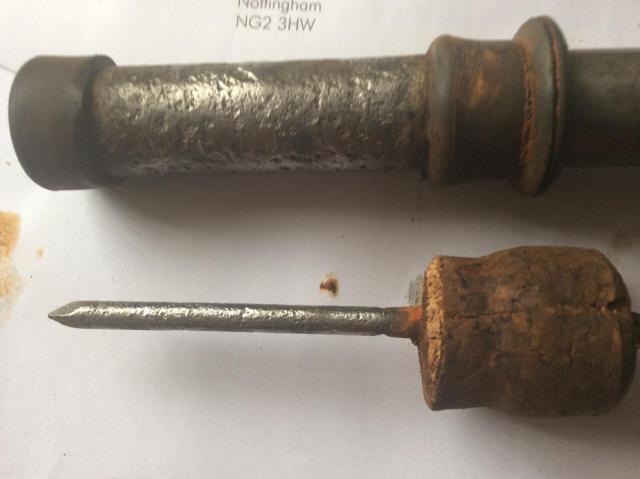

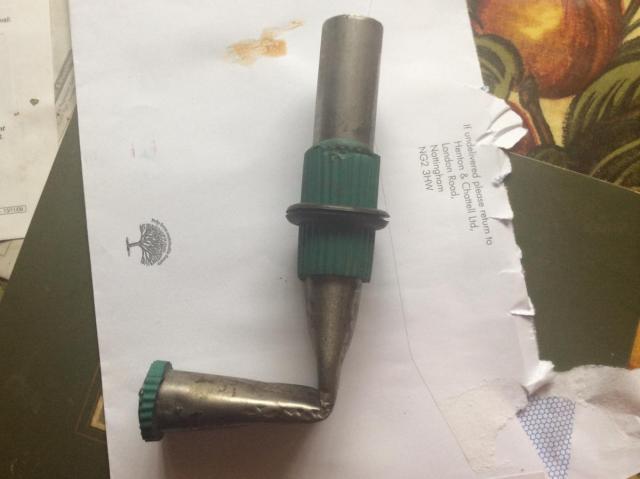

Wristpin 400 #14 Posted August 10, 2014 (edited) Decided to give it a go . As you say, the in tank electrode gathers crud at an alarming rate and the current flow drops proportionally. Mk1 was a six inch nail and the Mk2 for more exposure a bit of steel tube. Mk3 which is brewing at present is L shaped for 3d exposure! The electrode erosion was only a couple of hours for the nail and overnight for the tube. Edited August 10, 2014 by Wristpin Share this post Link to post Share on other sites

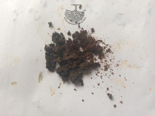

Wristpin 400 #16 Posted August 11, 2014 I use a handful of nuts and self tappers. Really evil back crud came out this morning! If the ammeter is to be believed it pulls about 5 amps with a squeaky clean electrode but soon drops back to 2 and stays there. Been discussing the method with another forum member and wondering whether a spherical end to the electrode would make it multi-directional ?!!!! Times like this makes me wish that I'd paid more attention to physics and chemistry at school! Share this post Link to post Share on other sites
Wristpin 400 #17 Posted August 16, 2014 The Sloper tank has been brewing for nearly a week now and is still giving up a fair amount of crud. A look inside with a torch and mirror shows a lot of clean metal with some areas that are still covered in whatever. Given it several rinses and shakes with assorted hardware and every time it brings off a bit more. A truly amazing and effective process just so long as you are not in a hurry! Got another Sloper tank to do after this one and then may do the Lambretta! Share this post Link to post Share on other sites
