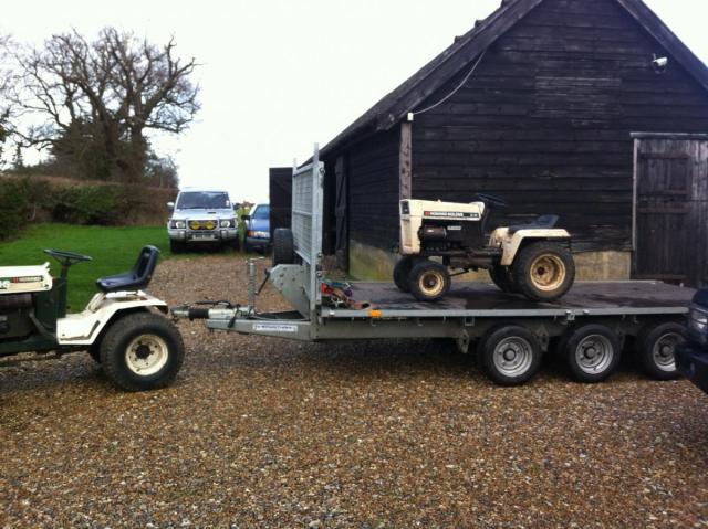

slf-uk 914 #73 Posted August 27, 2014 Looking good Ian. I use my HT23 all the time for moving trailers. My Ifor would look good on your 6x6, it has the right number of wheels. Iain 4 meadowfield, diggerjames, Triumph66 and 1 other reacted to this Share this post Link to post Share on other sites
Chris 642 #74 Posted August 27, 2014 (edited) Love that pic Iain one of my trailers is the same as yours but I have an electric winch for recovering dead stuff Ignor that Discovery. Thats long gone thank god & now have the green defender Edited August 27, 2014 by Chris 2 Triumph66 and nigel reacted to this Share this post Link to post Share on other sites
