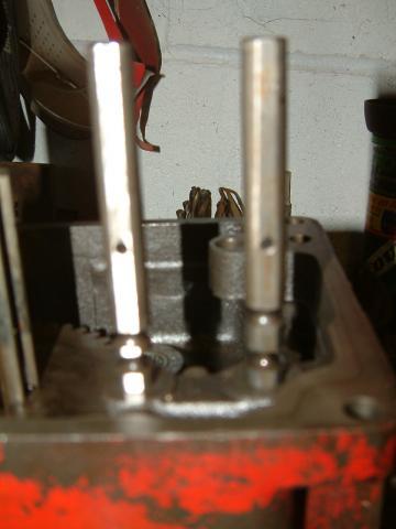

Stormin 4,458 #58 Posted December 10, 2014 I've got the trans cases back but have got a bit of a problem. Can anyone tell me if the shift rails are the right way round? Share this post Link to post Share on other sites
Stormin 4,458 #59 Posted December 10, 2014 Question answered by Stevasaurus on RS. They are right way round. Share this post Link to post Share on other sites
