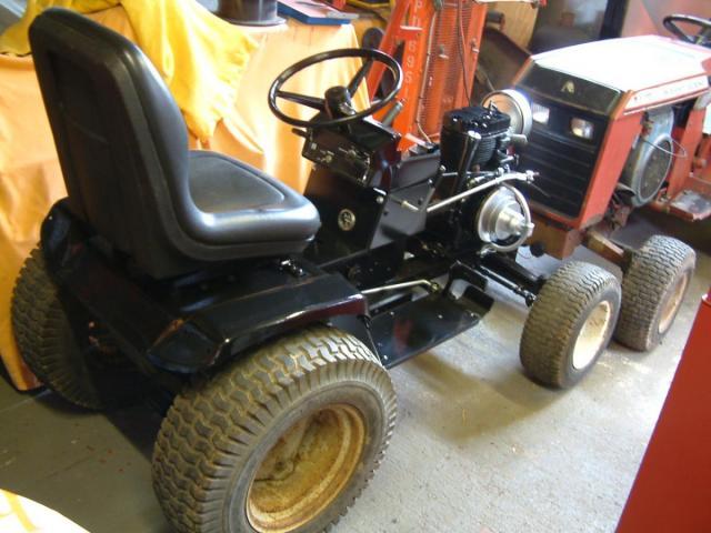

Stormin 4,458 #176 Posted March 27, 2015 Aye! We're in for a few wet days, Richard. Still, I can get on with smaller bits and tin ware. Here's another photo. Just 'cos I like it. Share this post Link to post Share on other sites

Ian 2,417 #178 Posted March 27, 2015 It's looking good Norm, nice work on the track rods By the way, you know black paint needs flames don't you.. Share this post Link to post Share on other sites
Stormin 4,458 #179 Posted March 27, 2015 It's looking good Norm, nice work on the track rods Thanks. Should have taken a photo of 'em fitted. By the way, you know black paint needs flames don't you.. Never mind flames. Just keep reminding me not to paint anything else black. 1 meadowfield reacted to this Share this post Link to post Share on other sites
the showman 4,074 #180 Posted March 27, 2015 Looking better and better Norm Share this post Link to post Share on other sites

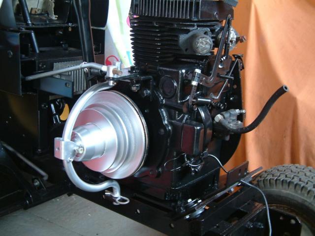

Stormin 4,458 #183 Posted March 29, 2015 A bit of bling. 5 bowtiebutler956, Ian, slf-uk and 2 others reacted to this Share this post Link to post Share on other sites
the showman 4,074 #184 Posted March 29, 2015 Oh thats nice, looks so good in black and silver and a photo to look at Share this post Link to post Share on other sites
slf-uk 914 #186 Posted March 29, 2015 I love it, really good choice of colour Iain Share this post Link to post Share on other sites
Stormin 4,458 #187 Posted March 29, 2015 The fan guard is silver, so I thought I'd better balance it out. Pleased you approve. 1 nigel reacted to this Share this post Link to post Share on other sites

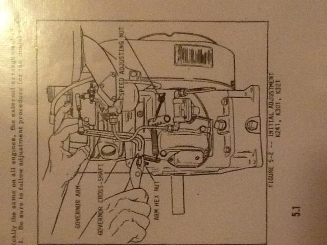

Stormin 4,458 #192 Posted April 1, 2015 A little more progress this afternoon. Carb and air filter fitted. Seat fitted. Drive belt back on. Starter motor fitted. Inside of belt guard and inside opposite side cover painted. Some of the throttle linkage connected. Here I've hit a snag. How the cable connects is not clear on my photo's. Or in the manual print out I have and though the same engine as the C-125, the linkage is not the same. Anyway, here's some photo's. Share this post Link to post Share on other sites

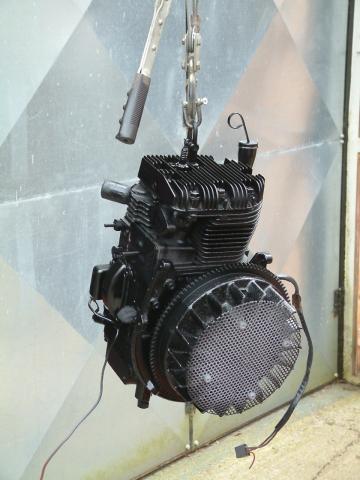

meadowfield 1,901 #195 Posted April 1, 2015 Looking good, I've pics back home... The cable runs just under the exhaust outlet I think and I to a small clamp on the block before the inner connects to the rocker with the spring across to the governor arm. Share this post Link to post Share on other sites
Stormin 4,458 #196 Posted April 1, 2015 I think I've worked it out now Mark. But to be on the safe side a good pic' would be welcome. I can't set it up anyway, 'till I get the fan guard done and on. Share this post Link to post Share on other sites
Anglo Traction 1,018 #197 Posted April 1, 2015 Looking God still Norm....Black n a bit of Silver was the way to go If it helps you, here's a few. As Mark says, it passes under the Exhaust Nipple and bends around and down- Then the Outer Cable is clamped at this point- Inner Cable end is fastened to the bottom of the Pivot Arm that is bolted to the Blower Shroud (pic if you need it). Share this post Link to post Share on other sites
the showman 4,074 #198 Posted April 1, 2015 Dose this help Share this post Link to post Share on other sites
Stormin 4,458 #199 Posted April 1, 2015 Thanks Richard. I was thinking the cable clip was horizontal, not angled. Chris. That looks a different set up. Share this post Link to post Share on other sites
the showman 4,074 #200 Posted April 1, 2015 Just got it from my kohler book, I'll do photos of the tractor in the morning Share this post Link to post Share on other sites
