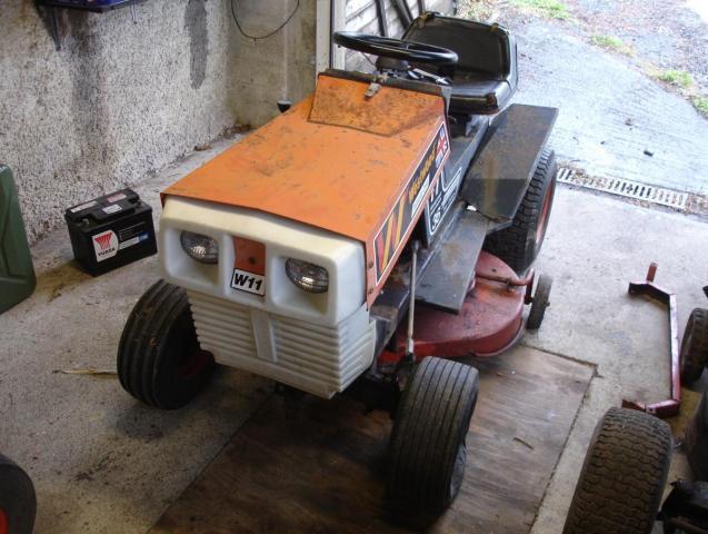

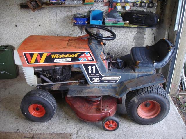

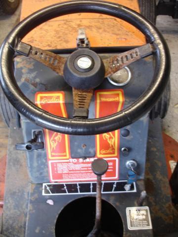

WestwoodGazelle 106 #1 Posted May 8, 2015 Seems there is a new addition to the herd As far as I know this is one of the earliest Westwoods. If you look at the foot rests they are very different from the later ones which rise up near the front of the mower, and have some pretty nice sharp angles The gear selector is in the same sort of place in front of the seat as a classic Wheelhorse instead of being column shift. The whole mower also seems to sit a couple of inches lower than my other Gazelle. It is basically exactly the same as my other one but everything is slightly different. As far as I know this is from the late 1970s, but I shall check tomorrow, and get some better photos. It does not run currently, the carb needs some attention and the deck needs a new belt to mow with. I plan on keeping this Gazelle as original as possible, I have rarely seen ones of this age about, and it isn't in bad condition at all, only some surface rust. It needs some TLC but overall is very solid. I think it would be a shame to repaint it but I wouldn't want it to eventually rust away, is there any product I can use to preserve it whilst keeping it with an original look? 5 1 Will-Haggle, Triumph66, meadowfield and 3 others reacted to this Share this post Link to post Share on other sites
Triumph66 1,256 #2 Posted May 8, 2015 I agree, keep it original and preserve it patina. Once it gone, it gone. 2 Will-Haggle and WestwoodGazelle reacted to this Share this post Link to post Share on other sites
HeadExam 1,783 #3 Posted May 9, 2015 it's nice enough to keep original, great little tractor Thanks for posting it. How about a side pic? 1 WestwoodGazelle reacted to this Share this post Link to post Share on other sites
meadowfield 1,901 #4 Posted May 9, 2015 Awesome! First time I've seen the shift lever in that position. Is there a serial number? Or stamp on the engine to date it? 1 WestwoodGazelle reacted to this Share this post Link to post Share on other sites

WestwoodGazelle 106 #6 Posted May 9, 2015 Thanks all! I shall get some decent pictures today including the side I'm sure someone has told me before but I've forgotten, where is the serial number on these 11hp Briggs and Stratton engines? I would love to see a picture of that Westfield, Andrew. 1 HeadExam reacted to this Share this post Link to post Share on other sites
HeadExam 1,783 #7 Posted May 9, 2015 Thanks all! I shall get some decent pictures today including the side I'm sure someone has told me before but I've forgotten, where is the serial number on these 11hp Briggs and Stratton engines? I would love to see a picture of that Westfield, Andrew. Its on the engine shroud should be on the round part of the shroud with a model/type/code stamp into the metal/tin. Might need to burnish a little or rub with a wet rag to see the numbers, flashlight helps too. As long as that is the original engine it will give you a good idea when the mower was made. Most mowers of a certain year started production and sold tractor before the actual year. A 1977 tractor or mower most likely started production in September of 1976 and ended or started a new years production run in August or September the following year. if you have a low serial number 1972 (or whatever year) tractor it is likely it was built in the calendar year before the model year. 1 WestwoodGazelle reacted to this Share this post Link to post Share on other sites
WestwoodGazelle 106 #8 Posted May 9, 2015 Its on the engine shroud should be on the round part of the shroud with a model/type/code stamp into the metal/tin. Might need to burnish a little or rub with a wet rag to see the numbers, flashlight helps too. As long as that is the original engine it will give you a good idea when the mower was made. Most mowers of a certain year started production and sold tractor before the actual year. A 1977 tractor or mower most likely started production in September of 1976 and ended or started a new years production run in August or September the following year. if you have a low serial number 1972 (or whatever year) tractor it is likely it was built in the calendar year before the model year. Thanks for the help! The number is: 252707 1062 01 78061411 I suppose that means that the year of the engine is 1978? So more likely it was made in 1977? Share this post Link to post Share on other sites
Phyliss 41 #9 Posted May 9, 2015 Afternoon, I believe the engine was made on 14th June 1978 so possibly a 78 machine being midway through the year? Philip 1 WestwoodGazelle reacted to this Share this post Link to post Share on other sites

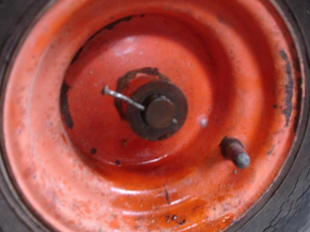

WestwoodGazelle 106 #10 Posted May 9, 2015 (edited) Afternoon, I believe the engine was made on 14th June 1978 so possibly a 78 machine being midway through the year? Philip Thanks Philip! That is very interesting to know, must be an early Westwood then. I managed to get some work done today. First thing was to change the flat tyre, luckily I had a spare Westwood wheel in the garage. The "split pin" holding on the old wheel was pretty interesting Here is the side-picture for HeadExam The "battery box" is also pretty interesting, I'm not 100% sure it's original Now I have a problem when I open the fuel line tap near the carb, petrol comes pouring out the part here circled in red. I will have to investigate further, especially since the first place it will reach is the exhaust. This may be hard to work out but it is where the gear stick attatches to the gear box and the rusty lump on the left is the end of the exhaust, which seems to exit inside the seat box, how strange, but seems original. Although this Westwood is built like a tank the quality control seems pretty awful, they welded the seat box to the chassis with a huge gap one side and a tiny one the other Interestingly, on my 1984 Westwood Gazelle, the seat box is bolted on, not welded. EDIT: I wonder if the different gaps are intentional due to the positioning of the exaust and other parts inside the seat box? And finally just some nice pics Edited May 10, 2015 by WestwoodGazelle 1 Triumph66 reacted to this Share this post Link to post Share on other sites

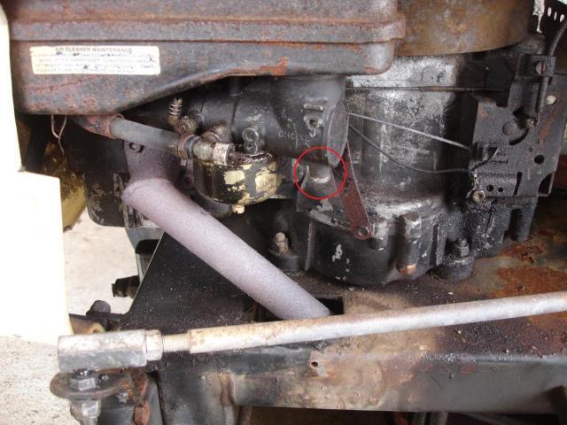

Chris 642 #11 Posted May 9, 2015 Leaking fuel points to float & needle problem. 1 WestwoodGazelle reacted to this Share this post Link to post Share on other sites
WestwoodGazelle 106 #12 Posted May 10, 2015 Leaking fuel points to float & needle problem. Thanks Chris, it turned out that the needle was not pushing up far enough. Spent some time ajusting it and solved the problem by ajusting a piece of metal on the float but bent it too far and now we're under-fueling I ran out of time today but I think a couple of hours and it'll be sorted. The engine fired up till the fuel ran out, but with plumes of white smoke, at first I shut it off straight away thinking wires were melting but nothing was hot and it was coming from the end of the exhaust. The second time I briefly fired it up there was less smoke, so my friend suggested it's just not been run for ages and it's just exhaust burning off steam and all the dust inside it? I have a fire extinguisher on stand by just in case, I won't know for sure until I get it running for a while. The good news is when it does run, it's one of the smoothest B&S engines I've heard, so as long as the smoke is just from some lack of use, it should be simple to get it running again Share this post Link to post Share on other sites

Alan 1,274 #14 Posted July 15, 2015 A very similar one dragged out of it's burial ground yesterday. Same gear lever arrangement, footrests, exhaust, hood. 8 hp engine on this one. The front and rear wheels are the same diameter although with different tires. Turned on it's side to remove the remains of the cutting deck. The exhaust can be clearly seen. Track rod broken. 3 WestwoodGazelle, S1g and Norman Wilkins reacted to this Share this post Link to post Share on other sites
Wristpin 400 #15 Posted July 16, 2015 (edited) That's an early Westwood chassis but using a Dynamark deck. The first Westwood tractors were in fact re- badged Dynamarks, then Westwood built their own chassis and finally their own decks ( welded pans rather than pressed). Edited July 16, 2015 by Wristpin 1 WestwoodGazelle reacted to this Share this post Link to post Share on other sites
