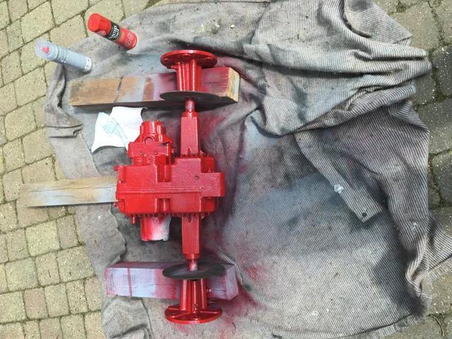

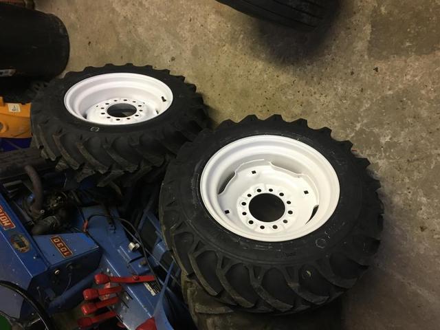

harryt 281 #39 Posted April 14, 2016 Another update, all disassembled now, chassis is painted and most other bits. Done the transmission which was a pain as all greasy and very heavy! Sourced tyres and got wheels painted. Thanks to Chris for putting them on for me. Here's a few pics. 1 Triumph66 reacted to this Share this post Link to post Share on other sites

Triumph66 1,256 #42 Posted April 14, 2016 I like those rear tyres; what makes are those? 1 harryt reacted to this Share this post Link to post Share on other sites
harryt 281 #43 Posted April 14, 2016 27 minutes ago, Triumph66 said: I like those rear tyres; what makes are those? Will check tomorrow as can't remember but I got them from allterraintyres.co.uk 1 Triumph66 reacted to this Share this post Link to post Share on other sites
meadowfield 1,901 #44 Posted April 14, 2016 Yeah, they look great 1 harryt reacted to this Share this post Link to post Share on other sites
Chris 642 #45 Posted April 15, 2016 Who said you could not get trac grip to fit the D200 rims?? If anybody has a spare set of 15 in D200 rear rims they would like to sell then please let me know!! 1 harryt reacted to this Share this post Link to post Share on other sites

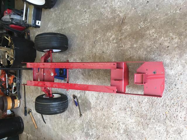

harryt 281 #46 Posted May 31, 2016 (edited) I have now got a rolling chassis together, now just to start adding parts bit by bit Edited May 31, 2016 by harryt 1 adgecutler reacted to this Share this post Link to post Share on other sites

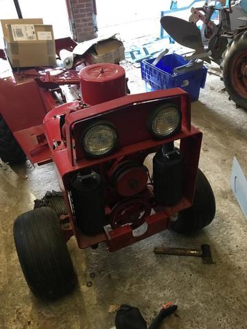

harryt 281 #48 Posted December 31, 2016 Here is a small update and some more pictures, little by little it is coming along and most parts are now painted, next on the list is the hydraulics 😬 5 Stormin, Alan, Triumph66 and 2 others reacted to this Share this post Link to post Share on other sites
meadowfield 1,901 #49 Posted January 4, 2017 On 31/12/2016 at 6:28 PM, harryt said: Here is a small update and some more pictures, little by little it is coming along and most parts are now painted, next on the list is the hydraulics 😬 looking good, what brand are the rear tyres? 1 harryt reacted to this Share this post Link to post Share on other sites
Triumph66 1,256 #50 Posted January 4, 2017 Looking good Harry. 1 harryt reacted to this Share this post Link to post Share on other sites
