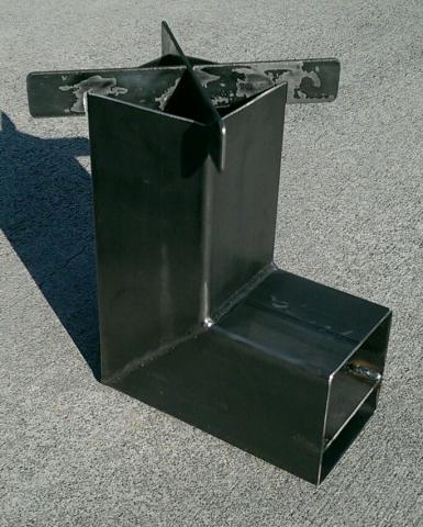

moogie 372 #27 Posted December 3, 2015 Plan to make a big version of one of these. Rocket Stove. 3 nigel, the showman and Ian reacted to this Share this post Link to post Share on other sites

the showman 4,074 #29 Posted December 4, 2015 Just googled the rocket stove, looks interesting. Will wait for your updates Share this post Link to post Share on other sites

Ian 2,417 #31 Posted December 5, 2015 Just looked up rocket stoves on YouTube... Very interesting Share this post Link to post Share on other sites

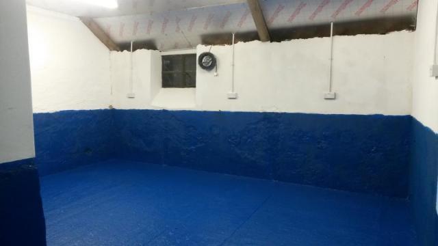

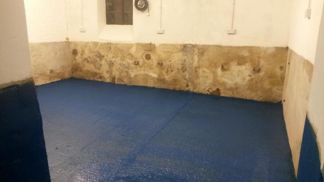

moogie 372 #32 Posted December 14, 2015 Managed to find enough motivation today to make my way out to the workshop. Preheated the room and managed to get a coat on the floor which dried fairly quickly. For the next part i had to call in my father to give me a hand to cut in the walls and floor so i could concentrate on rolling on the paint before it started to go off as it was two pack. Still another coat to go on the walls tomorrow hopefully, and then a red band to break up the blue and white. 11 S1g, Ian, Joe the small engine man and 8 others reacted to this Share this post Link to post Share on other sites

Ian 2,417 #39 Posted December 15, 2015 It looks very good Noel, though the height of the blue up the walls does make it look kinda like a swimming pool Share this post Link to post Share on other sites

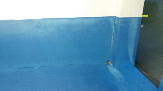

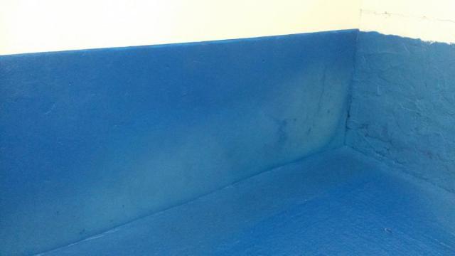

moogie 372 #40 Posted December 16, 2015 Got the last coat of paint on the walls and floor last night, opened up the workshop this morning to find this. Absolutely gutted, all my hard work and money for nothing it must have been too cold and damp last night and has caused the paint to bloom. Dont think there is anything i can do with it other than get another gallon of paint at £40 and give it another coat. Share this post Link to post Share on other sites
Chris 642 #41 Posted December 16, 2015 Need to get a space heater going once you have finished. Looks like an empty swimming pool Share this post Link to post Share on other sites
Triumph66 1,256 #42 Posted December 16, 2015 Great progress and as Chris said, a heater will sort out the paint from blooming. Share this post Link to post Share on other sites

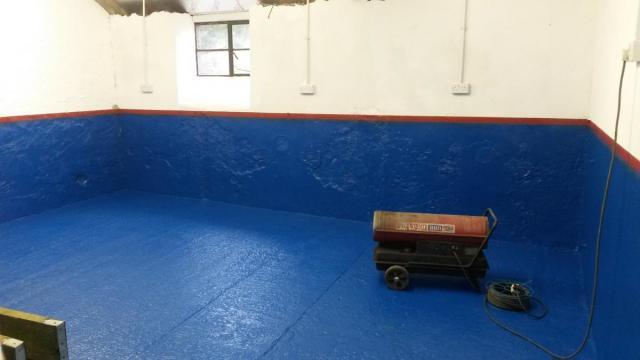

moogie 372 #43 Posted December 21, 2015 Thats much better now, turns out it was a bad batch of paint that was causing all the problems. 2 Triumph66 and S1g reacted to this Share this post Link to post Share on other sites

the showman 4,074 #45 Posted December 21, 2015 Looking better now Noel hope you got a refund on the dodg​ey paint Share this post Link to post Share on other sites
meadowfield 1,901 #46 Posted December 21, 2015 Wow that's awesome, maybe I should paint my floor! Share this post Link to post Share on other sites

HeadExam 1,783 #49 Posted December 22, 2015 Looks like moisture got into it. I have to say, even with the set back, you are doing a great job at a incredible pace, good job! Share this post Link to post Share on other sites

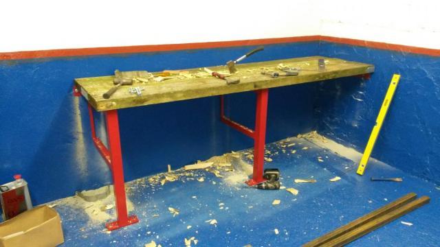

moogie 372 #50 Posted December 23, 2015 Got a start made on a new work bench today. Three inch angle iron for legs and three building planks. Had to scribe the first plank to the wall as it was a bit wobbly. Still need to get some 2mm sheet folded up to go on top of the planks, make a shelf for underneath and mount the vice. 7 Triumph66, Joe the small engine man, Ian and 4 others reacted to this Share this post Link to post Share on other sites
